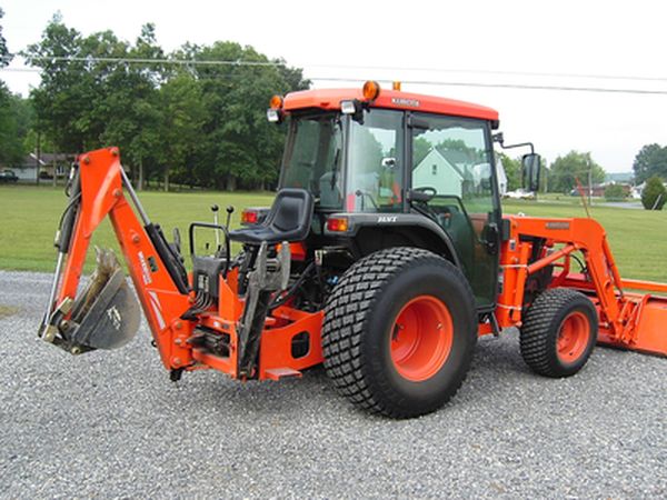

Tim,
I have a Woods BH mounted on my 3430HSTC and it works great. It's a 4 point subframe mount. Real easy to put on and remove. Wood's makes the same mount for a 5030HSTC.

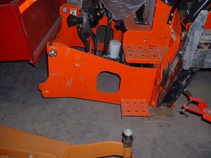

Here's some photos of my 3430HSTC with the Wood's BH mounted.

and one more. I've had this BH for 6 years now with no problems whatsoever. The Woods BH is as well-built as any BH on the market. When I'm ready to get a larger one, it will be a Woods.
Bill

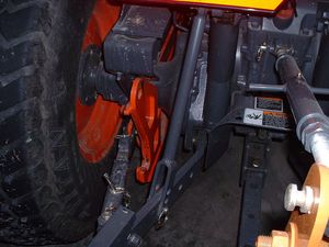

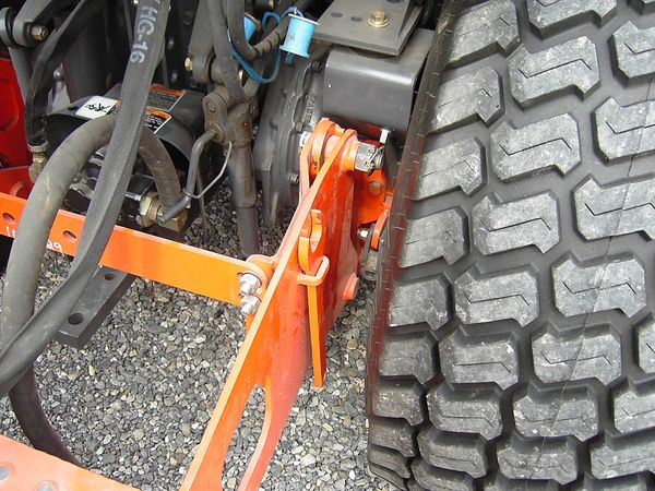

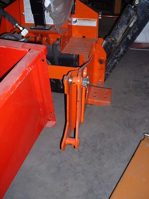

It's actually a 4 point subframe mount from woods. Here are some more subframe photos.
Bill
