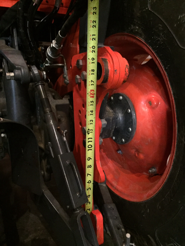

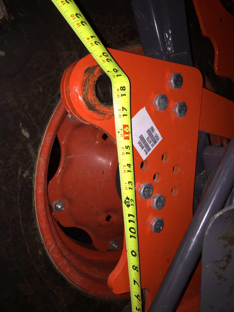

I measured from the bottom of the "cradle" to the bottom of the "hole" and got 17 3/8" on both sides. Hope this helps.

Well that's quite a bit bigger than my subframe. Looks like I'll need to make a custom mount for my backhoe to use on the subframe I have. Thanks for providing those. :thumbsup:

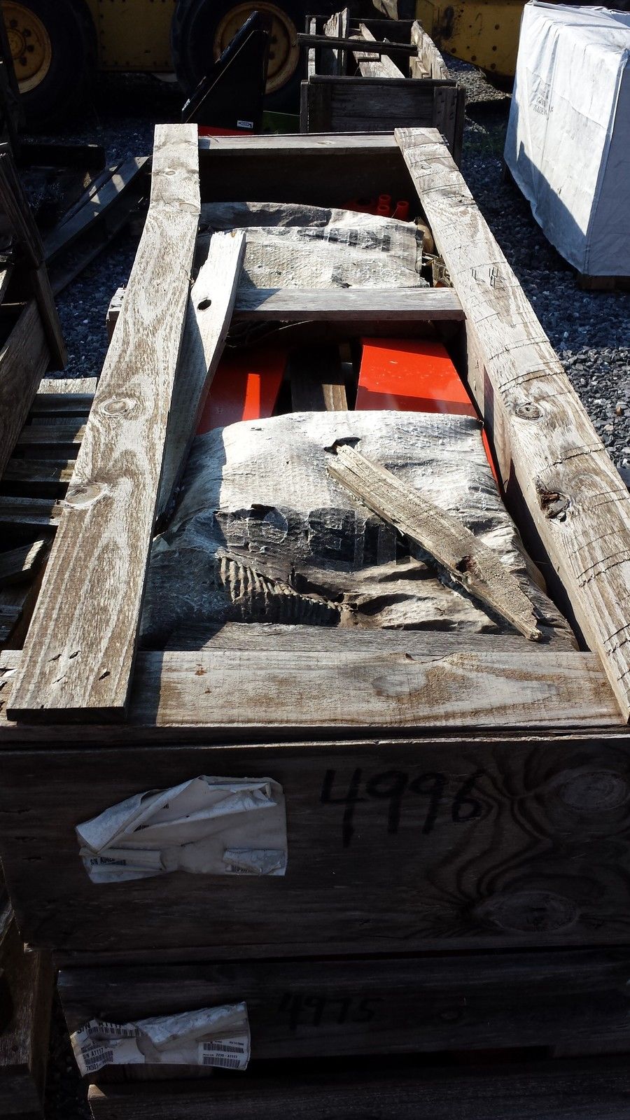

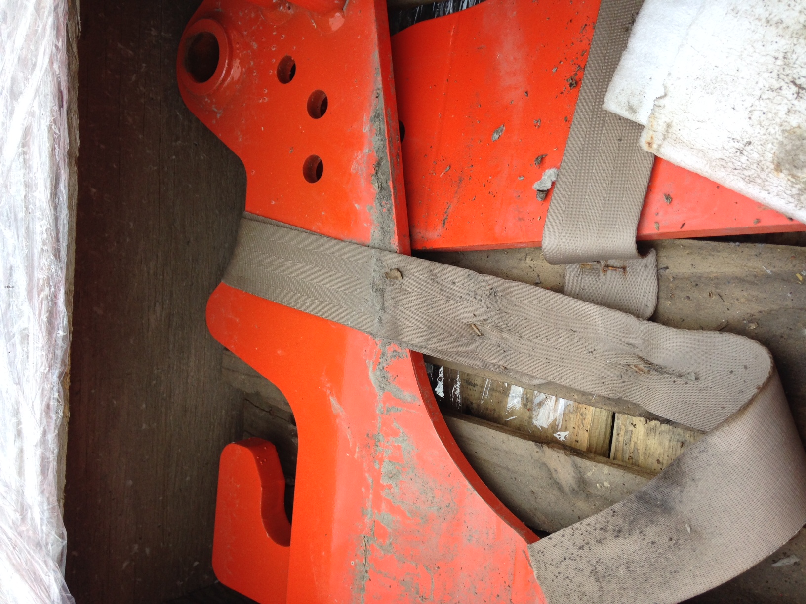

It might be worth getting the subframe kit from Kubota. There is quite a bit to it and after using mine for what I would consider average work I wouldn't want to skimp on the subframe, it definitely takes some abuse. I don't have a very good picture but zoom in on this one and see how much bigger the braces coming off the loader are than on a non backhoe subframe.
