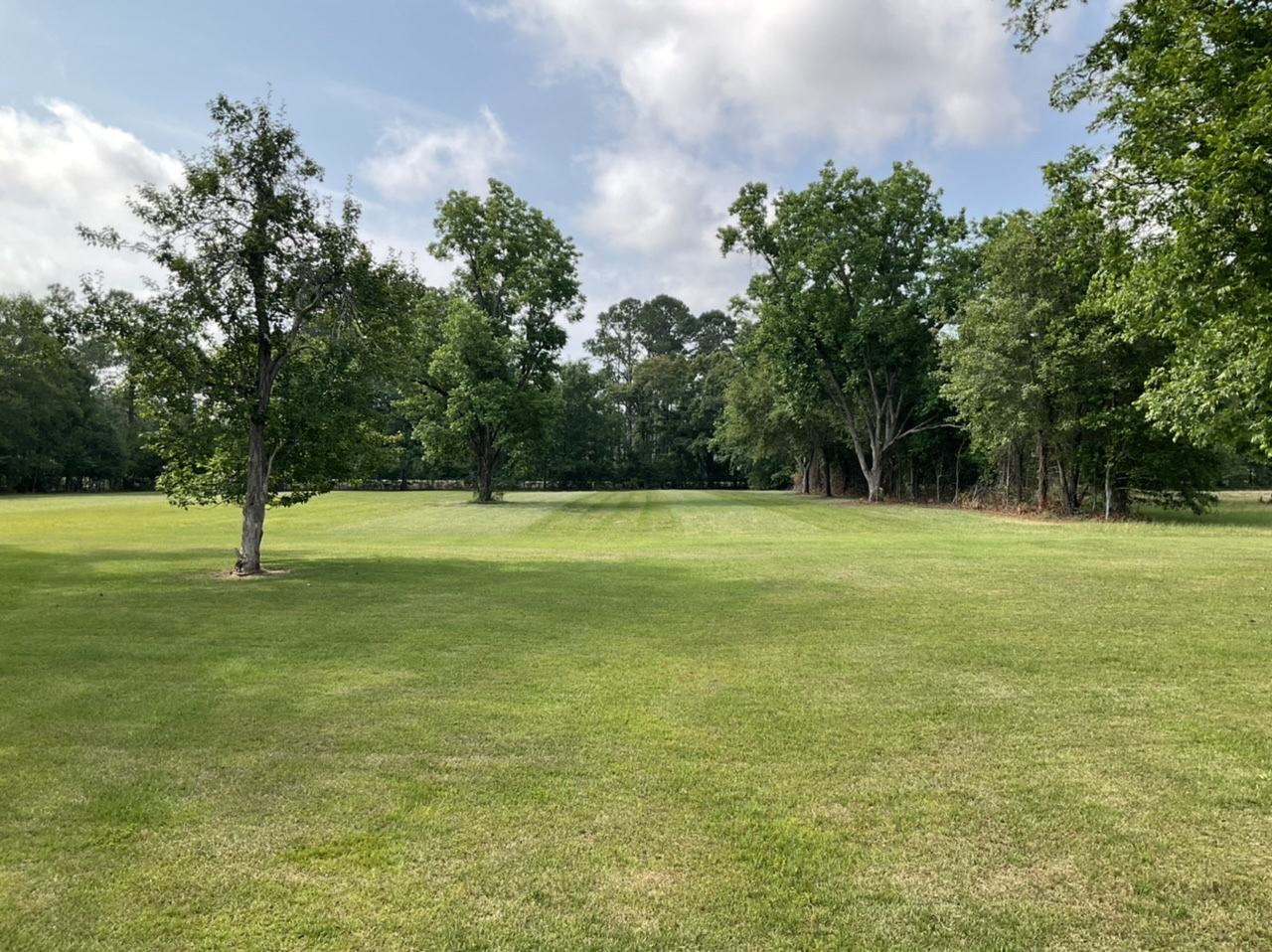

Flails and their tracks. It’s some stem-y winter weed that pops up. Should die out soon when the Bahai grass returns. This was cut about 5 days ago. Cotton was planted on the right two days ago.

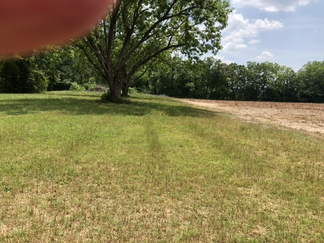

This old pasture was mowed two days ago. I lowered the cutting height to 4 inches so the cut is better. Mostly just Bahai now. I’ll just have to learn to live with the tire tracks. It is fun to play a bit with the striping made by the roller laying over the grass. :giggle:

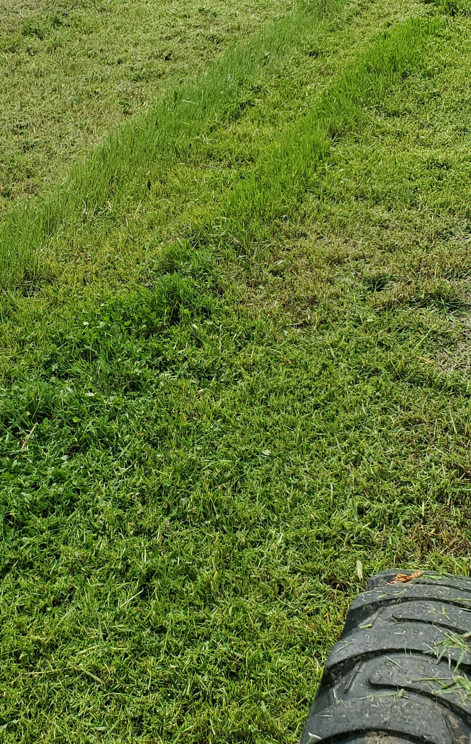

Went out and did a 3.5 acre field. Nice an flat with 5-8 inch natural field grasses and weeds. Pretty tame stuff.
Ran at a 2.5 inch cut and took my time.
Then end result is terrible. Looks like it was done with a crappy, unleveled brush hog with bad blades.
You get one nicer strip of cut grass but then you also get strips of grass that is 3 inches taller.
It is really disappointing.
If it didn't leave these stripes it would be a really nice cut.
I don't think there is anything you can do about it.

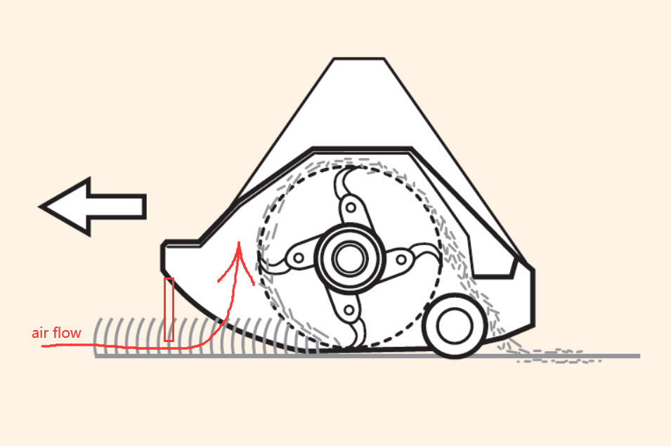

I suggest you check if the flail mower front flaps missing, the spinning flail mower rotor creat big suction and bring big air flow come from the front, this will help to get up the grass which were pressed down by tractor wheel, then the flail hammer can cut them.
This is one of the reason why most flail mower use front flaps instead of chain.

Flaps are all intact and functional.
I can even see it trying to create some suction if I look back at it while mowing but it just doesn't cut the grass where the tires ran.
I think one issue is that it is a counterrotating flail so I think that the blades are more apt to lay the grass that is bent over back down. It does this to flexible, small saplings also.
I tried my Ford 917L and my JD 25A which both spin in the direction of forward wheel travel and they did better handling the grass at the tire tracks.
It might do a little better as the ground firms up and the grass dries. Or I hope anyway!
