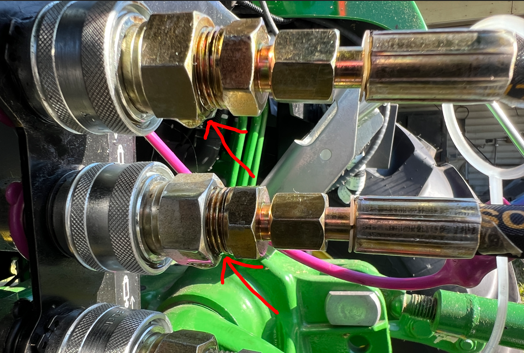

This really about the hoses, not the actual mower, but I have a new FH-AGL-145 flail mower. I installed the mower on my JD 4066R tractor with dual rear remotes. When I was testing it, the fittings at the hose end are leaking. I have emailed Betstco, but thought someone here may have run into this. I am pretty mechanically savvy, took the fittings apart and cannot see how they are supposed to seal. Appears the fitting has a flat face and there is a mating flat face inside the fitting. Picture of the fitting and where it is leaking is attached. Thanks, Kurt

I had to change the ends on mine. They jic ends on a non jic reducer

If they are both pipe need soMe Teflon tape for the threads
   / Betstco FH-AGL-145 Hydraulic Hoses Leaking Tractor End #4
Now you've done it. You know much of the "crybaby crowd" here absolutely abhor teflon tape in any form, for any reason.. That ought to spark some outrage.
But I agree with you. That's exactly what I would do, provided the adapter and coupler threads are both tapered pipe thread. One would need to remove one to confirm that.
