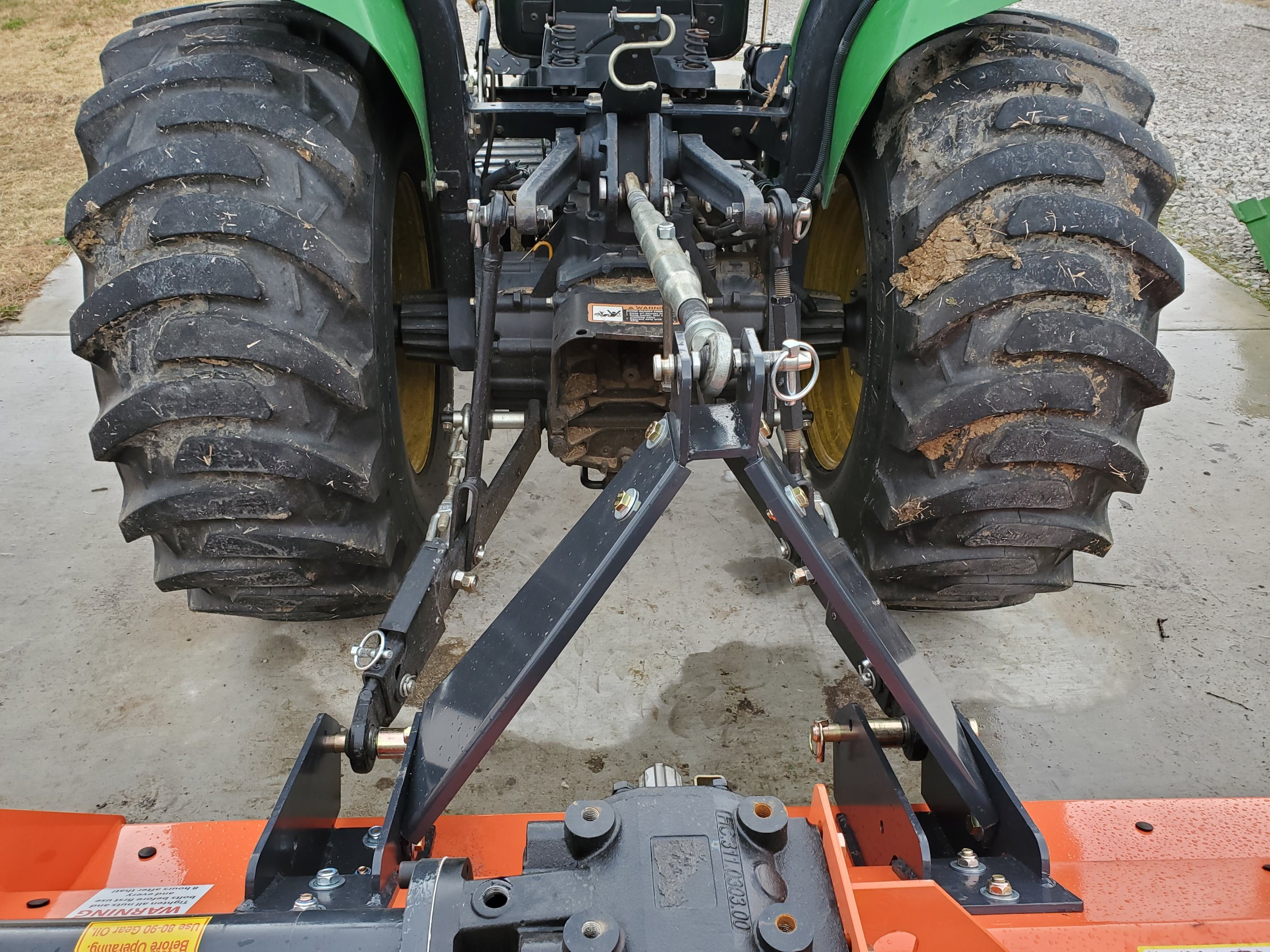

Hardware was missing and inadequate I felt. No washers for the bolts and the bolts seem a bit undersized for the holes they go in. About half of the bolts were too short, you could barely get the nut on. Lock nuts were half height and strip easily as did the bolts. Probably grade 2 or maybe 3. This hardware is for mounting the lower draft arm mounts and the top link mount so these things need to be tight and stay tight. I feel the bolts should be a size larger and a higher grade to properly secure the mounts. I have ordered all new grade 5 bolts, washers and lock nuts $80 at McMaster-Carr. Will probably end up replacing all the bolts on the whole flail to make sure it is secure and strong and up to the job. My choice.
The gearbox. The threaded hole for the oil fill/vent plug was basically cross threaded or looked like it was threaded twice. It appeared it was likely a manufacturing defect. Sent pictures to Betstco and they sent to the manufacturer. Betstco concluded it is a manufacturing defect and the gearbox is being replaced. I don't like the fact I have to take the new flail apart to this level, but I appreciate their effort on this, and it is certainly easier than shipping the whole thing back.

The mounting of the top link mount is a little poorly designed. It causes the top link to go at an angle between the tractor and the implement. I think this could potentially cause side-loads on the top link mounts which may or may not cause issues down the road. This is something I may try to redesign and may not be hard to do.

The A-frame looks to be mounted differently on the left side vs right side on the flail. That would cause a lean.
   / Betstco EFGC-155 Fail Part 2!
If I mount it in the other position, or to the other side, the angle is even worse.
   / Betstco EFGC-155 Fail Part 2! #7
This is how they show to mount them
Yes and it is incorrect. They even acknowledge it. When it is set up like that the angle is worse. Once I set it up like that, I looked at it and thought there is no way that is right.
After watching several YouTube videos others found the same thing and moved it to the other side which makes the angle less, but it is still there.
The design is not good. The position of one upright needs to be changed to center the top between the lower mounts.
