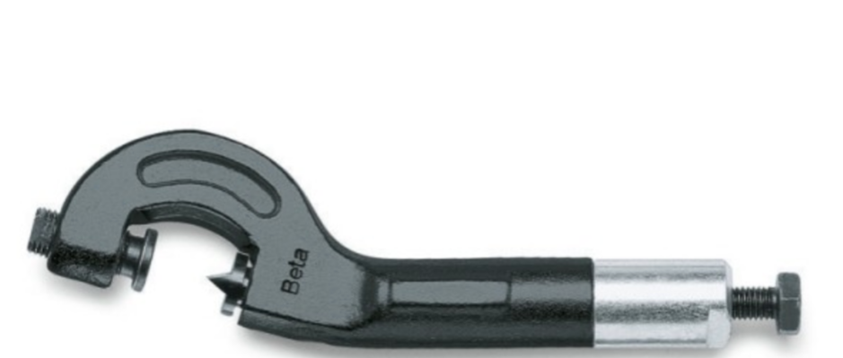

I have a question or two. I picked up a hydraulic nut splitter to try and remove some heavily damaged nuts on some turning plow shares. I was able to get one nut free but can't seem to get pressure built up again to work on the others. I'm assuming it needs more grease. Unfortunately, it didn't come with any instructions and there aren't any online.
Does anybody know what type of grease this uses and how I'm supposed to add more?

Sounds like your hydraulic nut splitter is seized up internally. Take it apart and clean and lube the internals with light machine oil.
