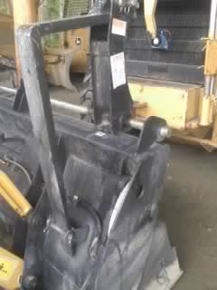

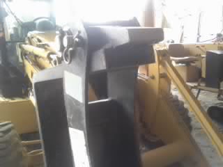

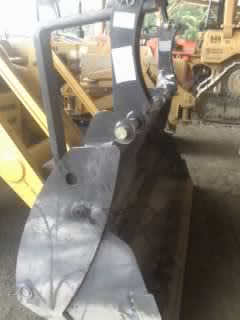

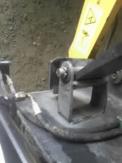

Look at this - how hard could it be? As long as you have the welding gear and a little welding knowledge.
Pin them on and leave them ,or unpin and take off.
They work as a back stop for other loads in the bucket too!
These were take of a new Cat backhoe / tractor / loader. So there is probly a Pat. Pend. so don't build completly the same.

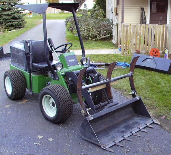

Here is another way to make floating forks - now the pic is for a graple (nice work by the way !)
Now in your mind take away the center grapple arm ,you would have a pipe from one side to the other ... get an old pair of forklift forks or cut some "u" channel and weld in an "L" shape with a pipe welded to the top of the "L" and you could slid the forks where ever you wanted to - undo a pin and take them off ??? what ever!
