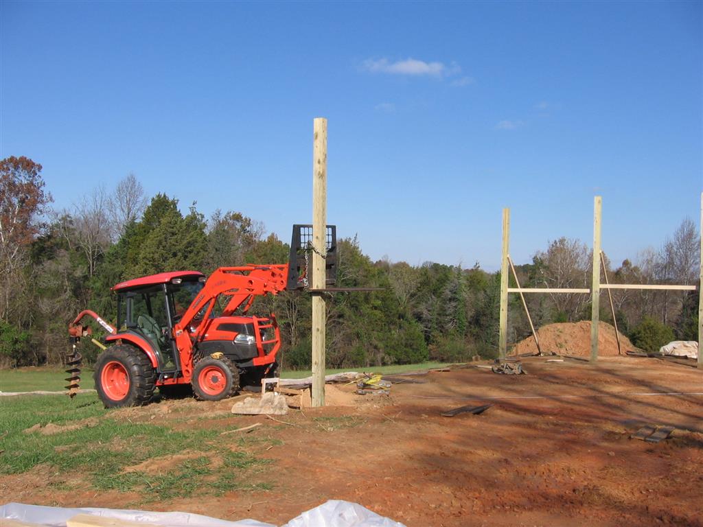

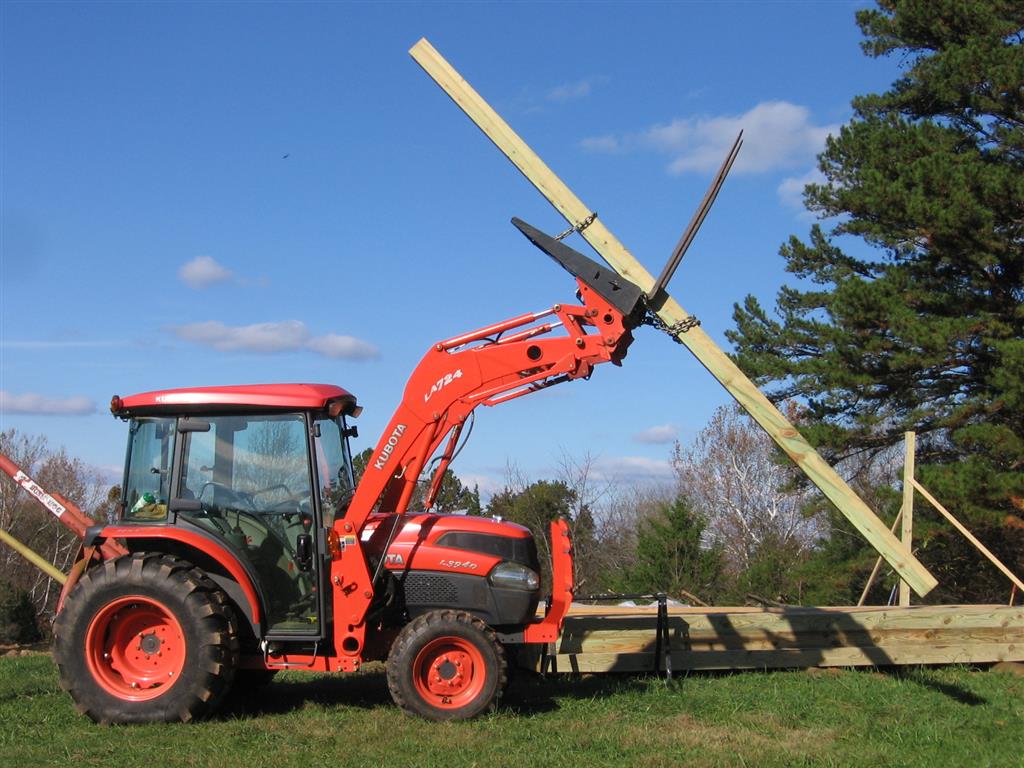

When I was setting my 16 foot post for my workshop I lift one end of the pole over the back of the forks on my tractor. With the forks close together to help steady it when it was vertical. I used part of the chain to hook to the post under the forks and do the lifting. The other end I used to steady the top of the pole with a simple loop to the top of the back part of the forks to keep the post from falling forward. After putting the post in the hole I would undo the lower chain and plumb the post and put my concrete around it. Then undo the top chain and get another post. Rick

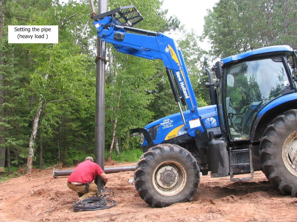

When the crew set the steel posts for my solar panels, I snapped a photo. I don't know if it's of any benefit to you but here it is.
GGK
