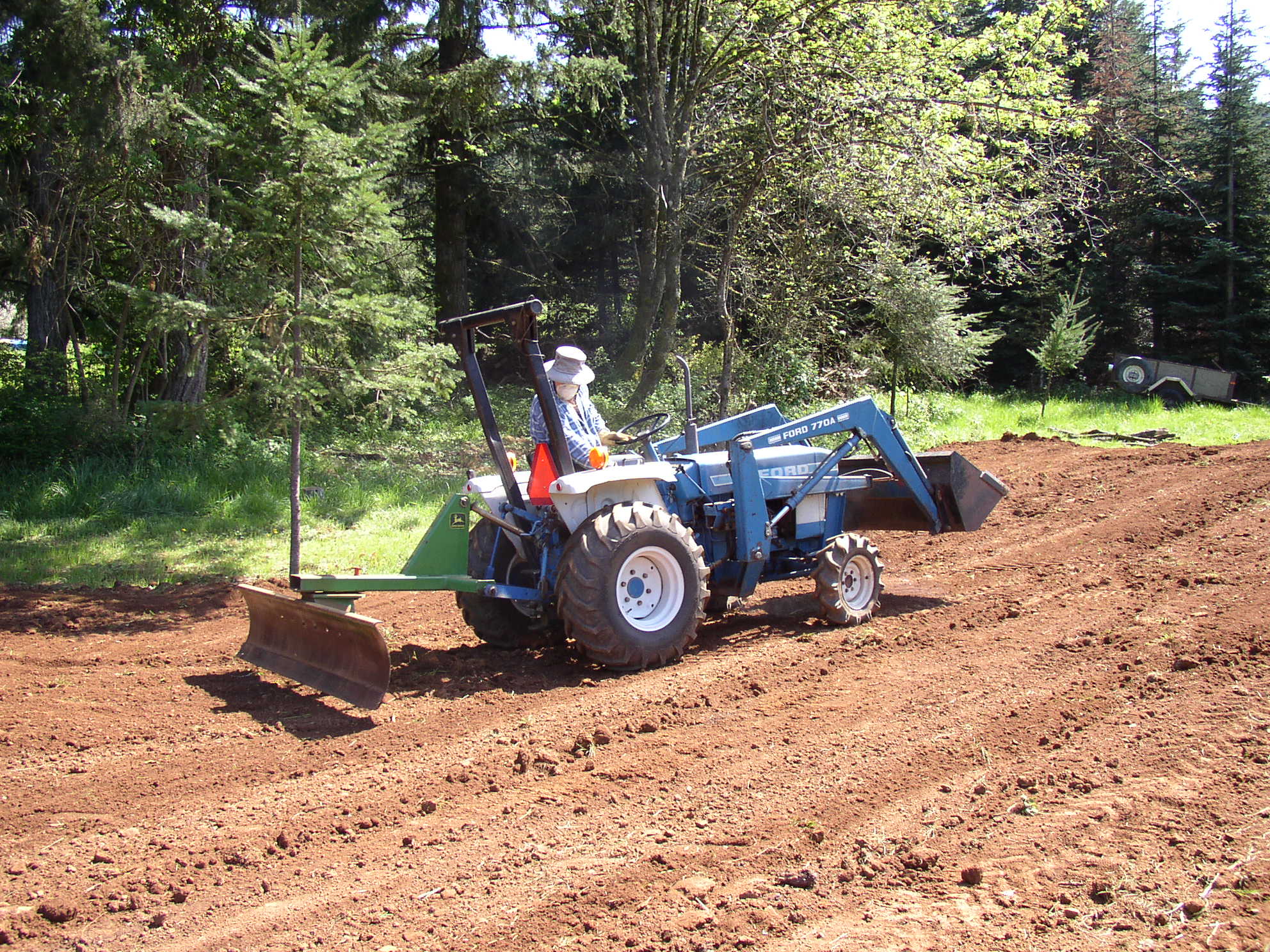

Best way to smooth this out? Tilled land.

Pictures don't look that bad to me.
I've been working some clear-cut land with disc harrows and a landscape rake. Not perfect but good enough.

Disk harrow - rectangular pattern followed by angular pattern. Then Land Plane Grading scraper with scarifiers set low.

In my back section it was pretty rough when I moved in, I got a cheap pull type disc that was about 50% bigger than my tractor could handle but I took one summer to get it disced up, then took the high points out with the box scraper and moved them into the low points, disced some more, took a spring tooth harrow to it and a spike tooth harrow and called it, was pretty good for a while. Now 3 years later the voles and gophers have ruined it again... now I have a 3pt disc that's more reasonably sized for the tractor and is fully adjustable front and back independently... Maybe next summer I'll get to that, I have at least 4 more gophers left and thousands of voles but that's a never ending battle I'm sure...

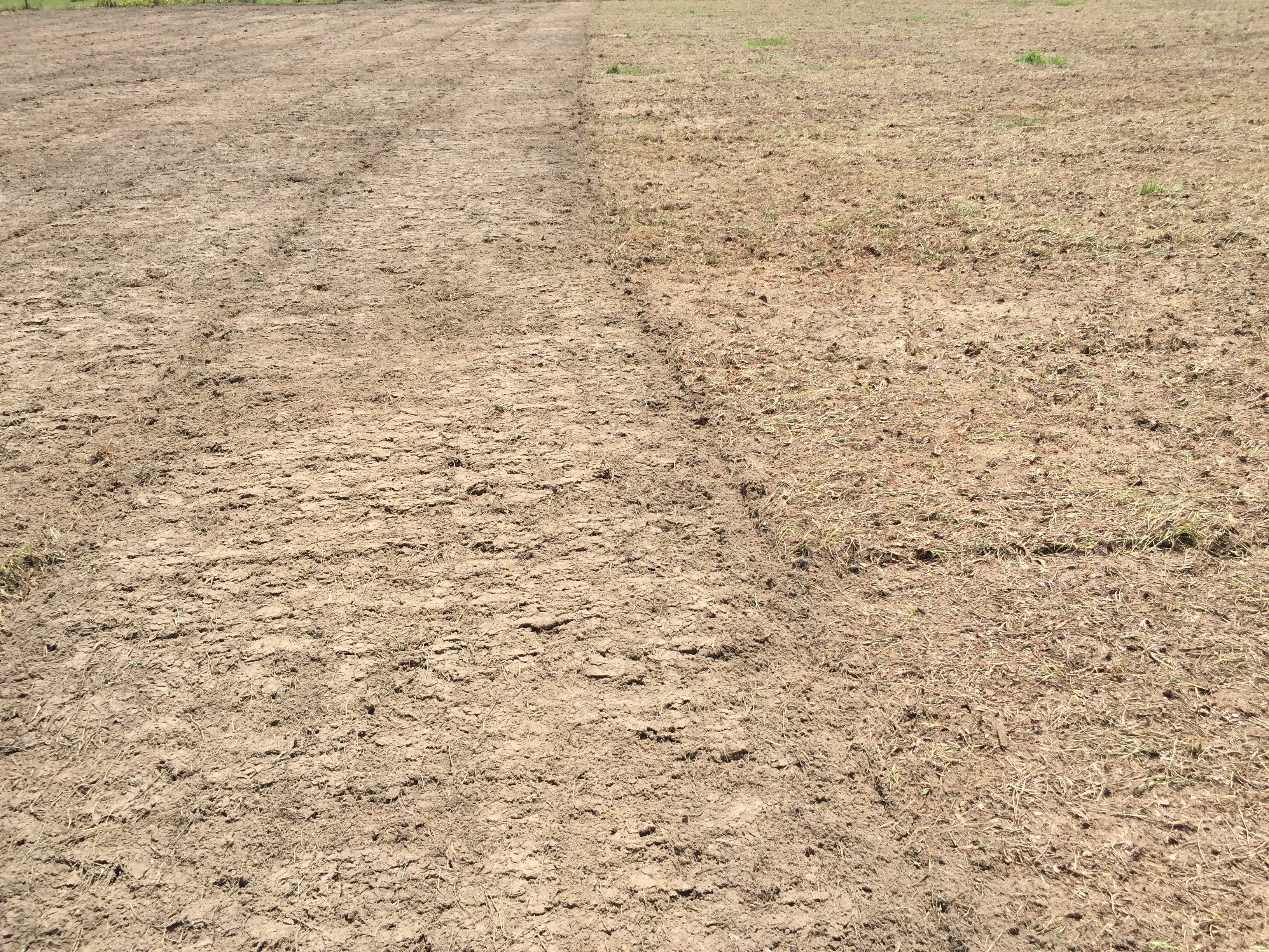

I'm hoping the grass isn't an issue. I re-tilled the area shown in my original post and it seems to be mixing it in much better on the second pass. The pic below shows the second pass on the left vs. the initial pass on the right. As for the rake, the log will sit in the curvature of the tines and hold the tine edges off the ground a bit. Basically the rake will be resting atop the log and just serve to raise/lower it when needed. Will take some creative rigging but I think it can be done.

We had pretty good luck by hooking a drag (16"x15' I beam) behind our box blade so we could run with the box blade up and drag down. Hook chains so at full lift, it will lift the drag also. This way, you can relocate dirt with the box blade when desired, let it out slowly for the drag to finish. Or just use the drag. Can lift the drag if and when needed.
