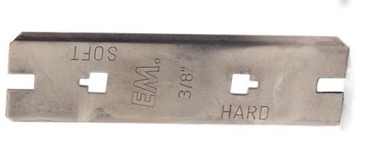

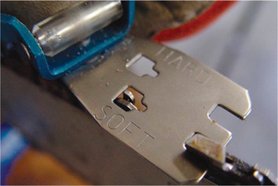

I described in another post here about the difference between a progressive depth gauge height tool (which also sets the height of the depth gauge solely in relation to the tooth that follows it) and a "constant height" tool: the basic concept of which is like laying a straight edge across two teeth and measuring down from there a specified distance. The former is very tolerant of different lengths of cutters. The latter requires keeping the teeth fairly close in length when comparing left-hand to right-hand cutters, or the saw will start to cut on a curve (and/or will wear one rail of your bar more than the other).
progressive depth gauge tools
Constant height depth gauge tools:
View attachment 609043 View attachment 609042
