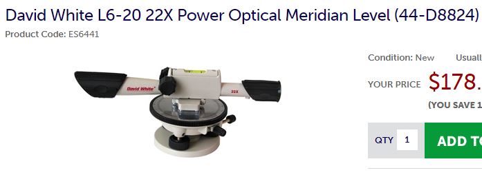

I've done a lot of trenching drainage ditches with my mini backhoe. I found the best way was to pay attention to the slope of the drainage ditch, always making sure that the drainage ditch was dropping as it went along - to keep the water flowing. This was important where it cut into other ditches. I'd figure my low points and high points and decide how much I needed to drop. If I dug too deep, I had a wet pocket. If I dug too little I had an obstruction and a wet pocket above that.
I used a David White level like this one. (I used it for building as well.) zzzzzzzzzzzzzzzzzzzzzzCapture.JPG
David White L6-2 22X Power Optical Meridian Level - 44-D8824 - EngineerSupply
