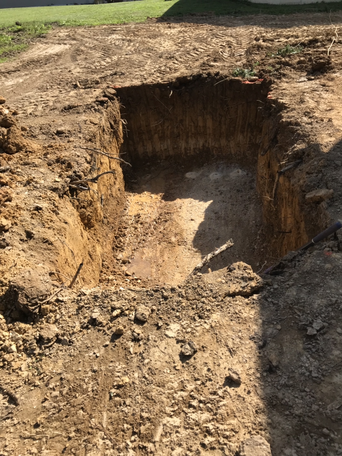

The top foot is pretty soft and I can probably scratch it out with the backhoe after that it seems to be harder but I haven’t started digging the hole yet. Everything I’ve stated about the rock was concluded by digging the footer which I hit the rock in a few places.

I dug the hole today and got it deeper than expected. It’s about 48” deep. Another foot would be good but it’d probably close enough to just mound some dirt over. I still haven’t decided the final solution. IMG_6942.JPG

I would get a quote and possibly hire it done. You would want to clear the rock deeper than just the minimum to lay a bed of sand in order to set the tank level. Rather than setting the tank on jagged rock creating voids and high pressure points on the tank bottom.
A small excavator with a hydraulic hammer would make short work of it.
