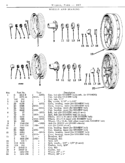

Many of their flat wagons didn't.
This thread was about a model B grain drill not a farm wagon. Many JD wagon gears had tapered roller bearings. JD model 943 wagon which was introduced in 1947 had tapered roller bearings

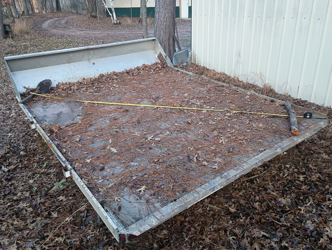

I had a perfect Plan B, but it fell through. My neighbor had a tandem 4 place snowmobile trailer, but he sold it. Here is a pic of my snowmobile trailer. The stick is 11' from the shovel at a diagonal.

I would be a bit leery of a grain drill on that trailer. Might be fine but.

We have that exact grain drill,it's bigger and heavier(top heavy) than you think.Also have the same snowmobile trailer;wouldn't try to haul that drill on that trailer!
Beg ,borrow or steal ,rent HD flat-bed.

Thanks. I figured it looked sketchy. I figured the grain drill weighed 1300#. The problem is that the load would be tail heavy.
