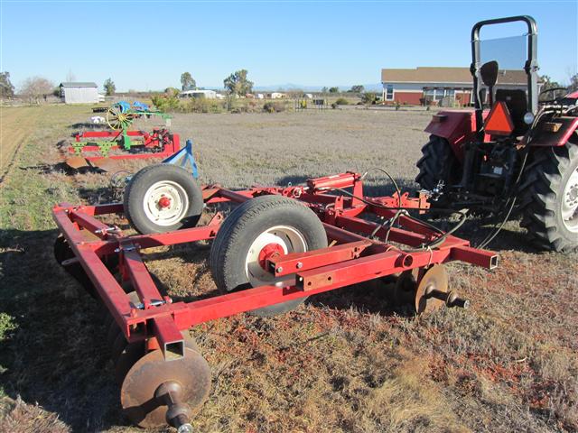

We recently purchased 80 acres. The land was rarely farmed in the last 20 years and is quite lumpy from various varmits burrowing and such. We also have quite a few deer tracks worn into the fields. We do have ariel photos back to the 50's which shows that the land was originally terraced. There are quite a few low spots in the terraces which could also be graded better.
We have a MF 1652 4WD. What attachments would be the best to use to land down the lumps and fill in the deer trails? We were thinking rollers. We do not want to disturb the entire 80 acres, just smooth it out a little bit.
Thanks

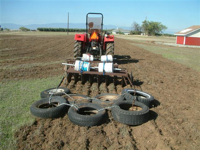

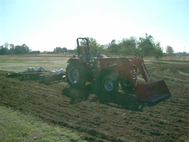

Use a disc and drag combination. Rollers won't do the job you want.
Here's what I use on my 6-acre hayfield - 6-1/2 wide offset disc with a tire drag pulled by a Mahindra 5525 (54 hp engine, 45 hp pto, 2WD, gear tranny, power steering).
Get a 6-ft wide 3-pt disc so you can adjust the cutting depth as desired. Or get a wheel disc (aka transport disc) like this one I use. Bought it from my tractor dealer for $600.
Good luck.
