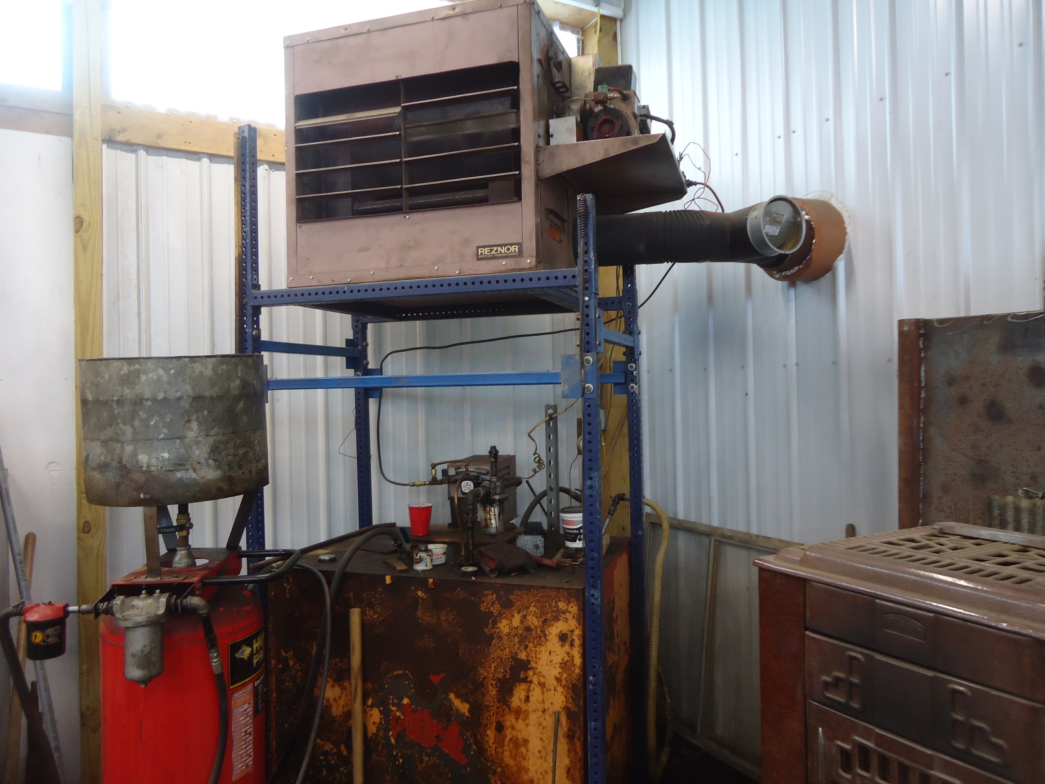

I bought this Reznor waste oil furnace 17 years ago, off of one of the guys I worked with pretty cheap. The heat excahnger needed to be replaced, so had a local shop, where at the time I didn't know a schoolmate from years ago worked. Apparently got the good buddy discount, because they only charged me $450 to build it. A new one from Reznor at the time was nearly $1500. So it paid me to shop around before buying this, for the build. I have had to replace the oil pump, that pulls oil out of the storage tank to feed the burner, and the blower fan. Can't really complain, as it's a 1974 model. Still works great, and heats the shop well. I leave the thermostat set at 50コ through the winter, mainly to keep the concrete floor warm. If you keep the floor warm, the building is a lot easier to heat. If not, when working out there in cold weather, you'll always feel cold radiating up from the floor.
Shop walls, and ceiling are insulated with 1-1/2" styrofoam between the perlins, then covered with cover sheet steel siding. A couple of the walls have 3/4" plywood on and painted. so as to put hooks to hang tools. Several friends and neighbors, and one tractor dealer save used oil for me. Most bring it here, the dealer I need to go pick up 55 gallon drums several times a year. It will burn anything from brake fluid, to SAE 50 oil. I had this in my other shop which was 36' X 32' X 12'. The most I even burned through it was 400 gallons through the winter. If need be, you can run HHO, or diesel fuel through it. I have a tank battery of 4, 275 gal. HHO oil tanks I store used oil in. Right now, I have 3 full, so nearly ahead 3 years on fuel.

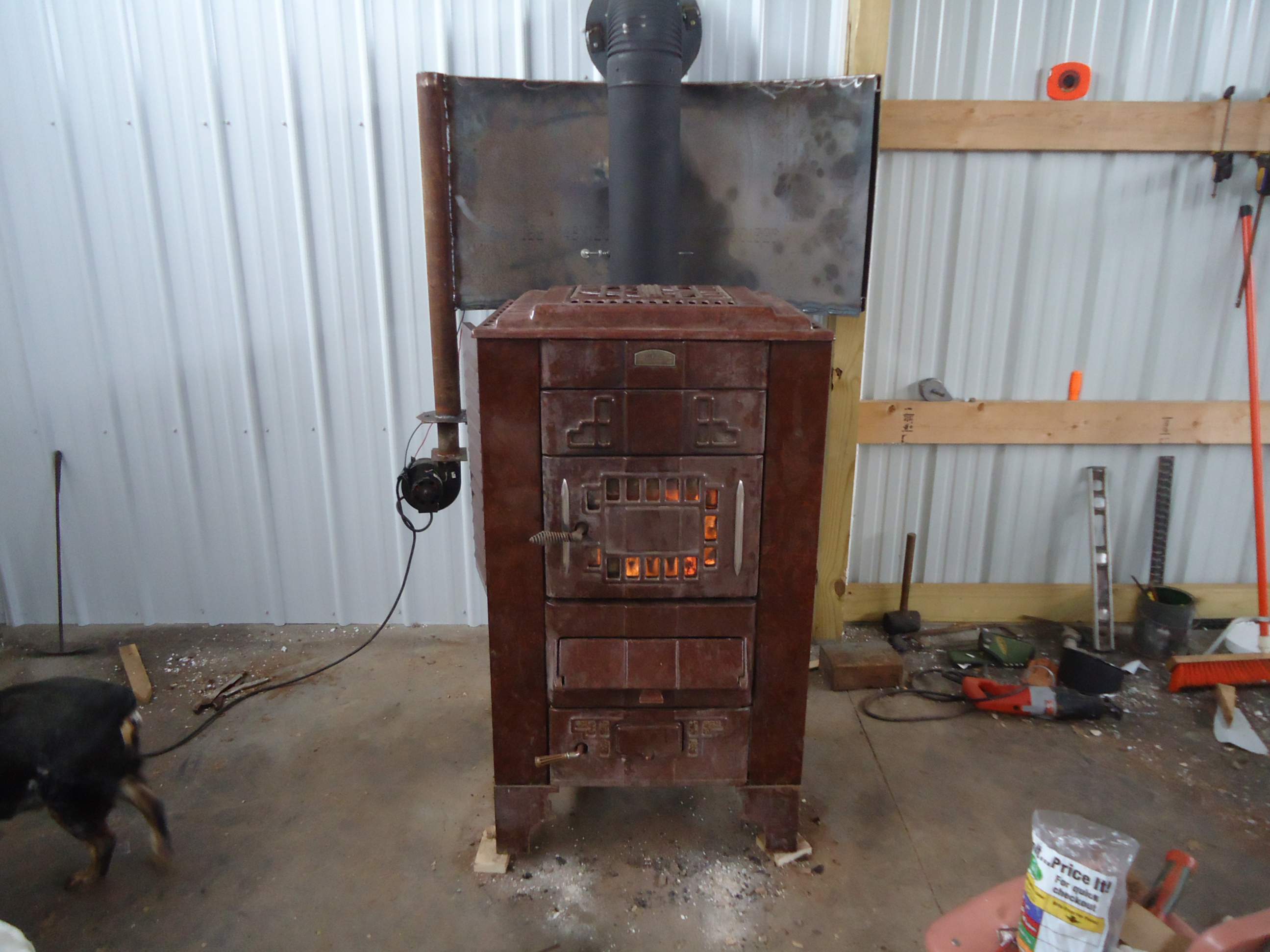

In this new shop, I added a wood/coal stove. I burn it when I'm working out there. I use seasoned wood, some lump coal which is still available semi locally for $80 per ton. I also have as stockpile of approx. 12 tons of Industrial Steam Coal from an old coal yard, that supplied coal for coal boilers. It was free for the hauling. Ended up with approx. 14 tons, and have burned around 2 tons in 5-1/2 years. More than likely, enough to last me the rest of my life.
It's also backup heat, in case the furnace needs serviced. Before building a finer refining filtration system, I needed to pull the oil preheater apart and clean every, approx. 750 hrs. of burn time. Usually sometime in Jan, when it's the coldest. I took a 60 gal. air compressor tank, and plumbed it up to filter the oil theough a #200 mesh filter, then beyond that, a HHO oil felt filter. I "pump" the oil through the filtration system with compressed air. Just hook the shop air compressor hose up to it, and set the regulator @ 30 psi. Takes maybe 20-30 minutes to push the oil into the furnace's tank. I do this when I'm working in the shop anyway.
I bought 2, steel water tanks in near new condition pretty cheap. I mounted them on a carry-all for oil transport from the bulk tanks. Althoiugh I do need to fill them manually, they too are plumbed to hook air to them to push oil into the filtration tank. That I do have to dedicate 1/2 a day to refill the 200 gallon furnace tank. A small price to pay for cheap heat.
