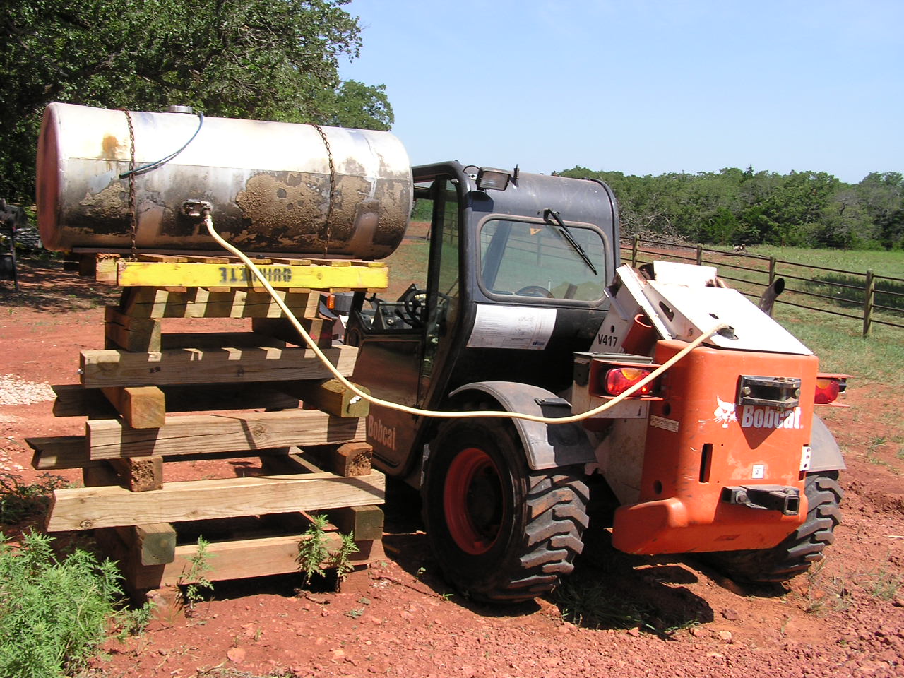

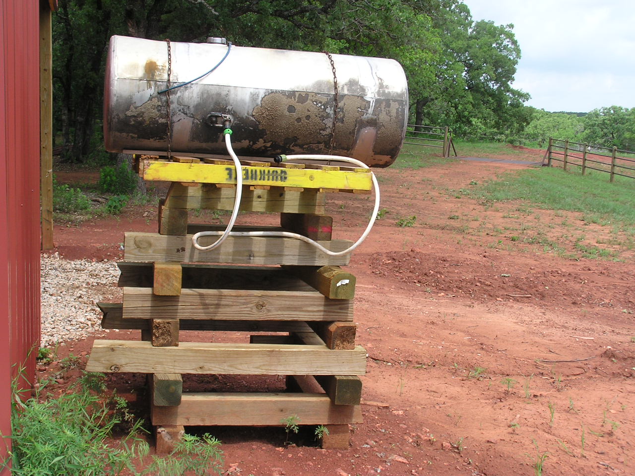

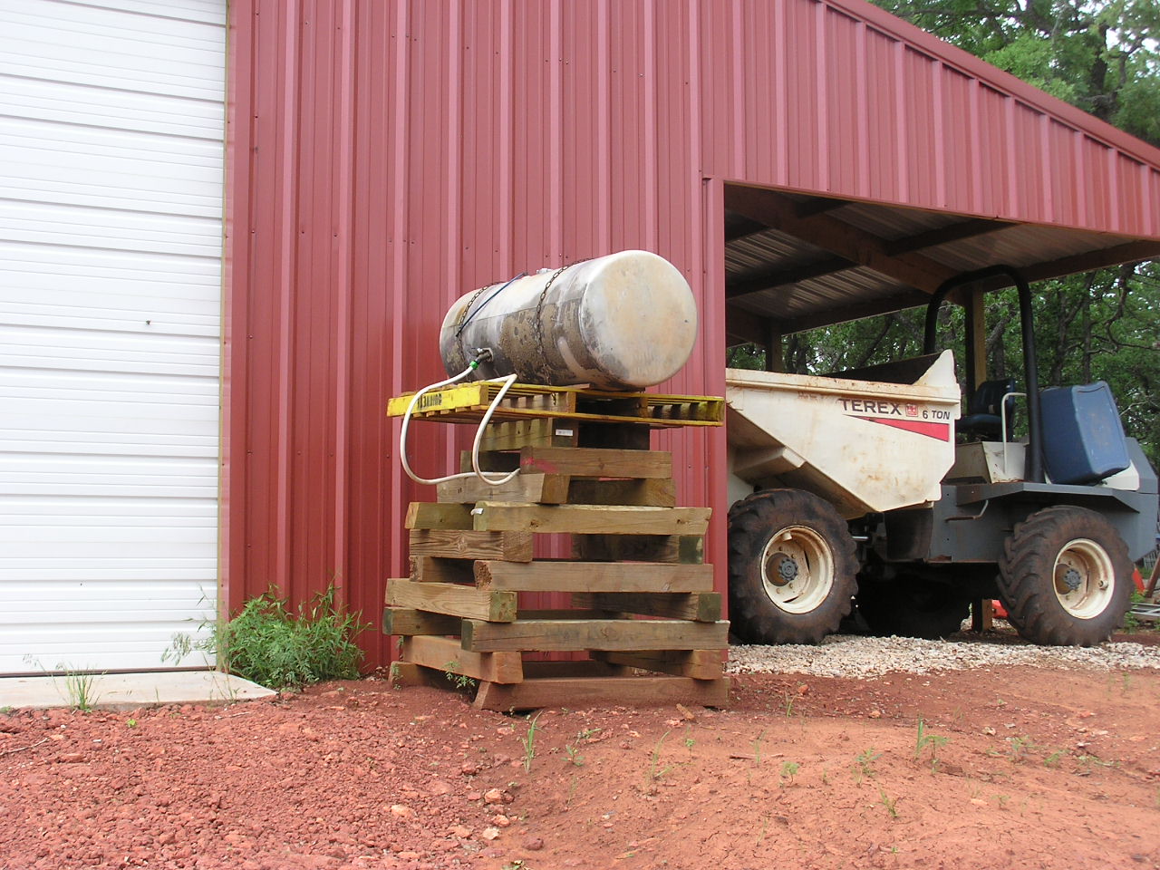

I use gravity from my 100 gallon saddle tank. Found it on craigslist. It came off of a Dump truck.
