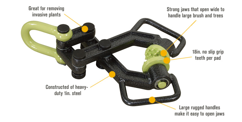

if you have a helper and a lot of time one of these should work cheaply.

I'd get a spare quick attach plate from PT, go to a used forklift seller (they are out there) and buy 1 heavy fork. Weld it to the quick attach plate. Push the fork under the ground and pop the trees out. I do that with 2" trees all the time with my little PT425 and PT's pallet forks. Don't pry with the end of the fork or you'll bend it. Drive it all the way in to the hilt then use curl and dump to pry. Should be a cheap attachment to build. QA plate is $350. Fork shouldn't be but that much. Welding is cheap. Your machine has ridiculous hydraulic power. Go slow.

A Piranha tooth bar for the bucket of your machine will get the small ones,,,
I use a woodsplitter, and a couple chains to pull out 4" size stumps effortlessly,,, Hydraulic power beats working hard,,,
