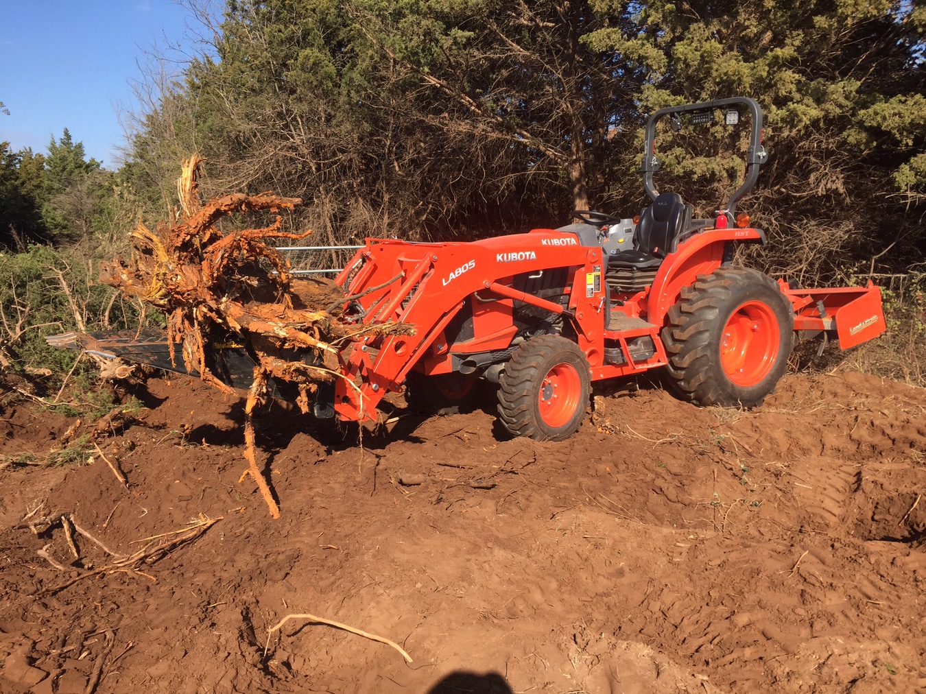

May not be what the OP needs but 12 diameter bodark trees and a good bit of root and little soil. Similar cedar trees easy work using a 35 hp tractor. Stick the stump bucket on a 50 horsepower and up skid steer and it is darn effective. Relatively low cost with some time invested. Stack em with a grapple to speed things up. As in most things in life its all about a trade between time and money.
