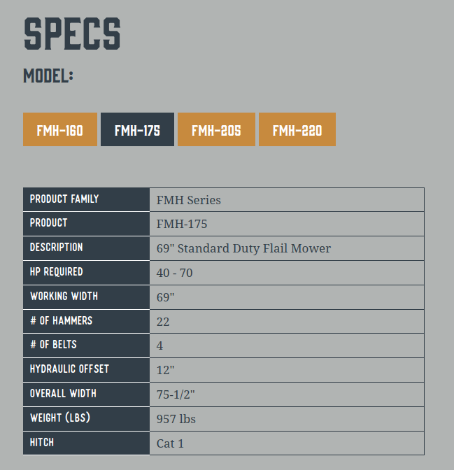

Just went through a flail mower purchasing decision myself, focusing on 'best bang for the buck', not necessarily cheapest. Italian technology and components seems to dominate this market. Try to stay away from cheap Chinese stuff.
I went with an Ironcraft FMH 175, which is US made with Italian components. Has a hydraulic side shift, which comes in handy when you quickly need to mow between trees (however, you'll need an extra rear remote). I paid 5K$ cash for it, which is substantially cheaper compared to some of the boutique Italian brands such as Del Morino.

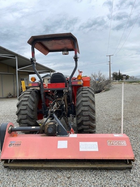

I have a Bestco 7 ft flail behind my MX5200 tractor. Going on 4 yrs without a problem. I did bend up the trailing bar backing into a tree stump last yr, I replaced it with a thicker piece of angle iron. Top and tilt are needed for general adjustments to keep the mower properly angled to the terrain. I have mine set up with offset so only one wheel is rolling in the uncut path. This allows me to see and place the mower close to fence lines and the creek without getting my tires so close.
THis was a cheap alternative that has proven good for me mowing about 10 acres of variable terrain.
