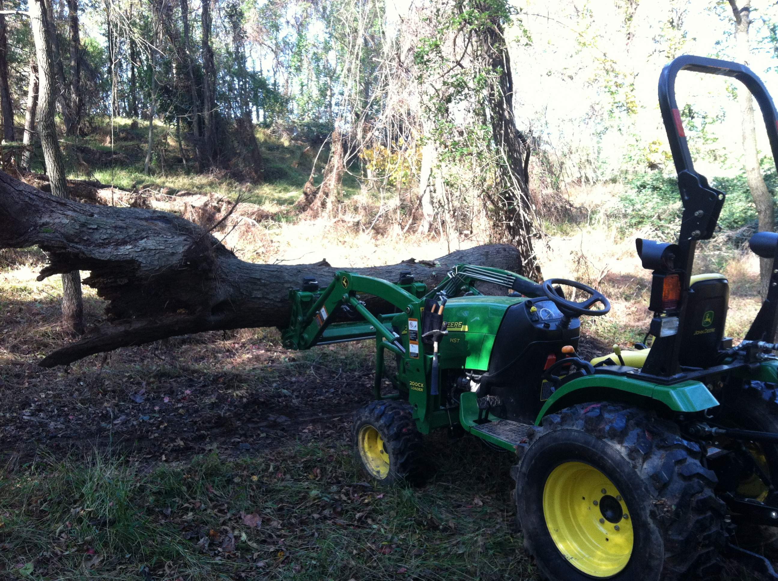

   / best tractor with available backhoe #2
I have 9 acres and absolutely love my JD2520. JD is replacing the model 46BH with a new model, the 270. It has a shorter sub frame that does not interfere with a belly mower and you do have to remove the 3PH arms to mount the backhoe. I believe the new backhoe will be available in the spring. It is a very strong tractor, JD is very conservative with ratings, the loader is spec'ed for 800 pounds, but I have lifted close to 1100 lbs.
