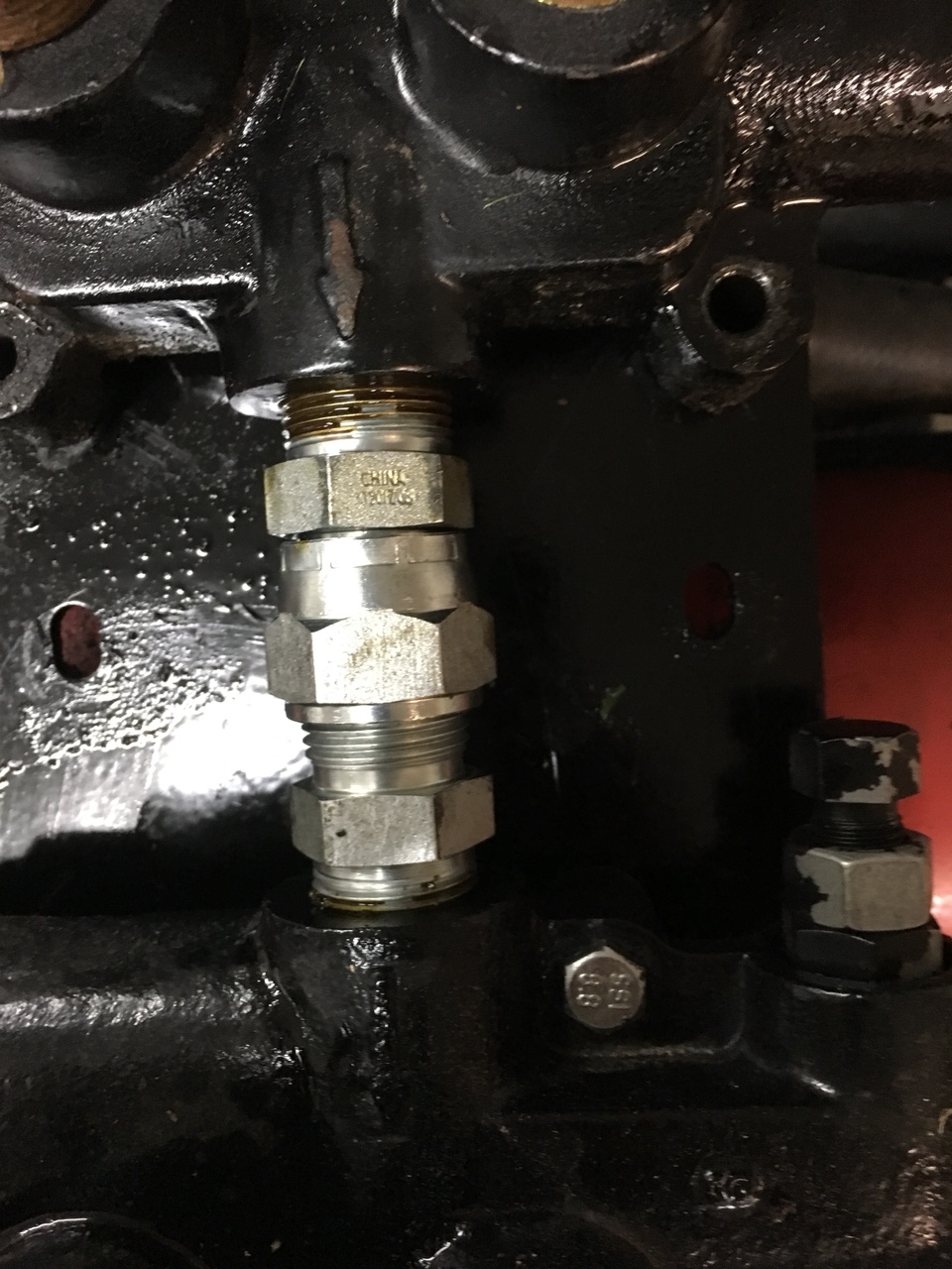

I’ve got a double ended pipe fitting between my wood splitter valves and due to not being able to completely tighten it it leaks. Is there a better sealant that won’t leak or should I take it apart and use put a jic fitting in it? IMG_4561.JPG

Ptfe/others are designed to fill the minute gaps in threads which are installed tight. This joint is seeing (guess) 2000 psi, most likely pulsed, unless it's tight, it won't seal, or the sealant(whatever type, unless quick metal or similar) will eventually leak/be moved from between the surfaces. If you have room to remount and have a male and female JIC, I would go that way for longevity. You'll need ptfe or you preferred sealant on the threaded fittings to the valve block, but you'll be able to do them tight, then hold the male and tighten the female JIC. YMMV

I bought the stuff to fix it. The JIC to pipe fittings were a little less than $10 so if that fixes it I’ll be happy.IMG_4566.JPG

Upon further investigation I think poor threads were the cause of the original issue. One fitting went in a lot farther and looking at the fitting that came out the same thing happened. I’m taking it back apart tomorrow and running a tap in it. IMG_4571.JPGIMG_4572.JPG
