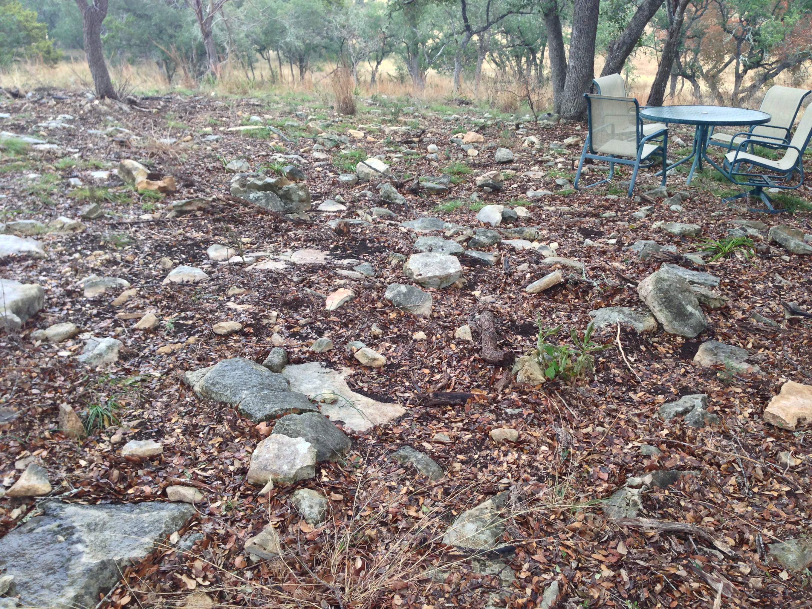

Here's a pic showing the type and quantity of rocks I'm looking to rearrange. It also gives a good representation of the trees in proximity. The meadow can be seen in the background. I have 4 areas with rocks like this that I want to clean up in the relatively near term, roughly 1/4 acre each.
The type of grapple I "think" will work best is one similar to Anbo's GR-M. It has a rake style bottom with 6" spread on the tines with a matching top. The reason I'm thinking this would be preferable to the L shaped bottom is that I can more effectively use 4 types of actions:
1. Push rake with the bottom while moving forward. I think I can also use this to position up to medium sized rocks in ground, then tilt the bucket back to help break them loose. (Won't work on large rocks I know.)
2. Pull rake with bucked dumped all the way and the top tines dragging the ground while moving backward to gather loose surface rocks into a pile.
3. Scoop/grab piles of small to medium rocks to transport.
4. Top down grap and lift larger rocks.
I need to stay pretty shallow on any rock raking I do so as not to damage too many roots, and I'll have to go back with topsoil to replace the volume of rocks I'm moving.
I have very small ambitions for the rock walls. In fact, I think of them more along the lines of "linear piles". If I get real ambitious I might go back to the linear piles and try to dry stack them into a more orderly appearance. What I'm looking to accomplish with the rock walls is essentially a mini-terrace type of thing. Taking the above pic as an example, I want to move most of those rocks into a very small wall, maybe a 1 or 2 high, to the right side of that pic, re-fill that center area with topsoil, and then the little wall serves as a way to help keep the topsoil from running down the hill to the meadow at the next rain.

After seeing the rocks, I am more convinced than ever that the right piece of equipment is a backhoe with thumb or an exactor with thumb. It would be very difficult for my grapple to pick up more than a few of those rocks at one time, but if I put them in a pile with the backhoe, I might be able to get several into the grapple at once. I would stack into a long pile, almost like a windrow.
I know you want a grapple, but it is only going to pick up one rock at a time, and you are going to be driving all over to get the rock in the grapple. Backhoe with thumb will only get one at a time also, but once you learn how to set it up, you can pick them up individually and stack in a pile, with no driving around between rocks. Much faster.
I would start by backing up to the start of the area to be cleared. Pick up all the rocks I can reach with the hoe and thumb, stack them on the right. Back up a couple feet and repeat. Keep backing up a few feet at a time to reposition the hoe and you will end up with a pile of rocks on the right side of the swath you just cleared. Now go over to the start, but with the long, skinny pile on the left about the length of your hoe away. Back up again and pile the rocks on the left, in the same long skinny pile. When you reach the end, come around and go lengthwise down the pile, scooping rocks into your grapple. I would not expect to get it more than 1/2 full at a time. This might be very hard on the grapple.

My property is very similar to your picture, except I have ~ 25% more rocks of similar size and a few 800 pounders, along with more trees. And yes in a large area, you walk mainly on rocks and not the ground. It is obviously a glacial dumping ground.
I have never considered a hoe for this type of work as I feel the rock bucket will be much faster just by using it as a bucket, running it along the ground and just having them roll/slide into the bucket.

Out in my area those rocks in the picture would not be just sitting on top of the ground. They are sort of like icebergs with most of the rock below grade. Despite being very heavy duty, my grapple is not a ground-engaging implement if the ground has not first been loosened up in some manner.
I doubt I could maintain any forward momentum trying to scoop rocks up that were distributed like those in the picture with my grapple, and I know I could not drive forward with the front edge of the grapple set a few inches below ground to get the rocks up. I would run out of either horsepower or traction.
A bulldozer with a grizzly would make short work of rocks like that, but that is in a whole different cost league than a tractor...
Go out in your rock field with a pick and a shovel, or even just a set of heavy gloves. If the rocks are loose and sitting on top of the earth, your plan is going to work. If they are 1/2 buried the grapple will take a long time.

We have picked up quite a few of the rocks and brought them to our current homes for landscaping. For the most part they are sitting on the surface- meaning we need to use a shovel to get under an edge or to dig a couple of inches underground to flip them up where they can be picked up. For the most part, ours are not like icebergs. For the more difficult ones I plan on using the ROBB with the shanks sunk maybe 6" into the earth and have them turn over the more stubborn ones.
But I will let you guys know how I finally have to work it out. And investing in a hoe is not in my budget.

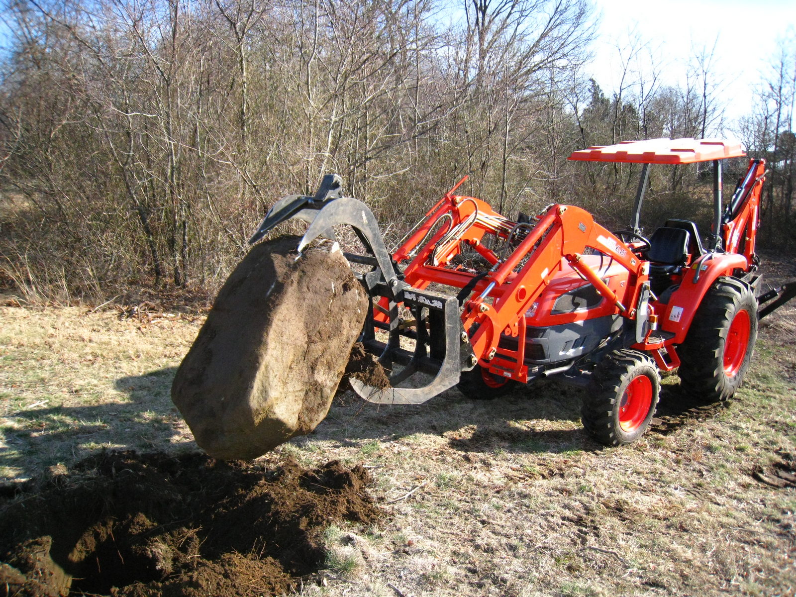

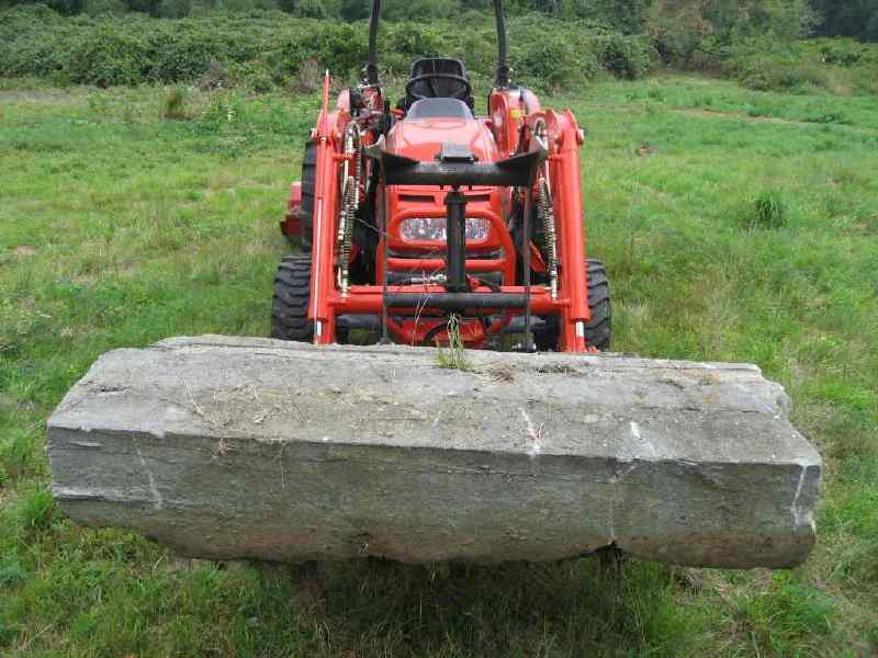

I haven't read this whole thread so this might be a duplicate of other advice.
I use a DK40 with 48" grapple and have collected and moved rocks up to about 2000lbs. The big rocks are not the problem. Smaller rocks, especially those with any dimension less than 9" or so are not the easiest objects for grapples as they can fall through the tines. Intermediate tines can be ordered from some of the semi custom grapple makers such as Everything Attachments.
Small rocks can be collected with a landscape rake but then you need to collect and move them. Other than a specific rock bucket which is useful only for that purpose I don't know of a really efficient way to deal with lots of small surface rocks. Standard bucket is probably second best.

CurlyDave- I certainly hope I do not run into a significant amount of iceberg rocks as they will ruin a lot of plans and money already spent. If I run into an unexpected boulder(s) that I can't go around for the driveway, I am planning on having a mini-x come out and do the heavy work once I have completed everything else.
IslandTractor- Your first picture is of a rock that is ~ 25% larger than any of my surface rocks. And viewing the rest of the established "neighborhood", no one else have any this size or larger in their "landscaping". So my 48" rock grapple should do the job. But I also have a CID stump bucket in case I have to do any deeper digging.
