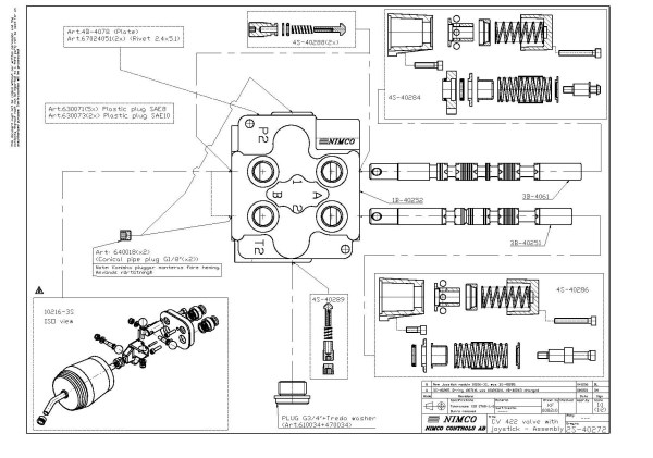

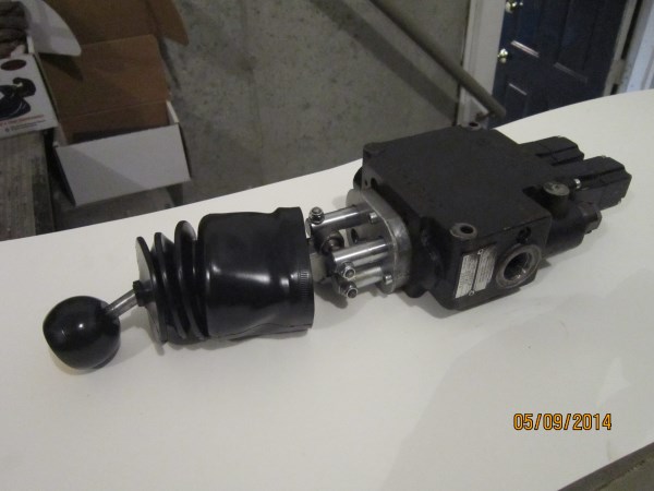

I was able to fix the valve.
I opened up the cap on the end and the bolt came loose that holds the spool and spring together.
I was able to put it back together and it is working great!
I also had a bent stud ball on the joystick.
I was able to find the valve through Brand with the correct mounting configuration and spool pattern from prior posts on this site.

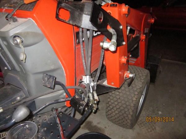

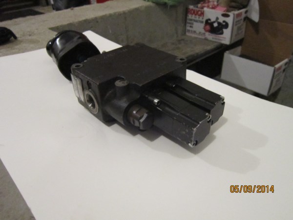

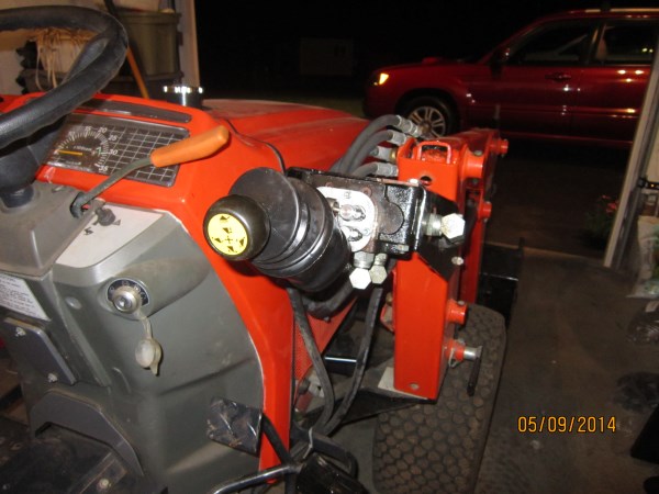

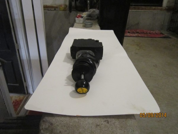

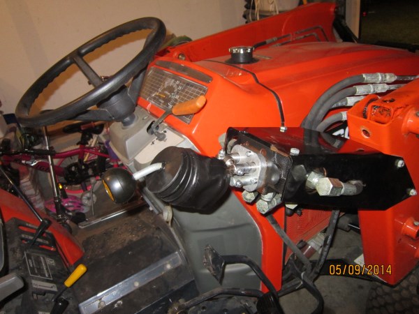

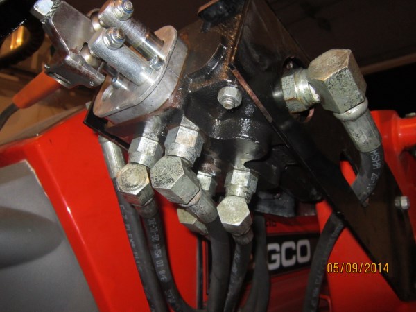

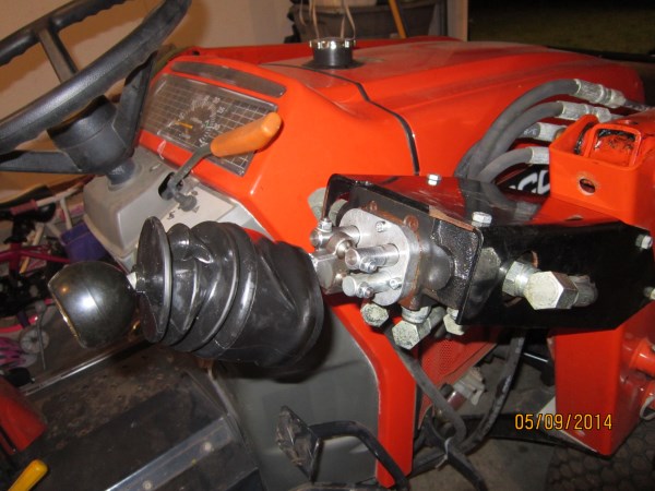

Here are some photos
