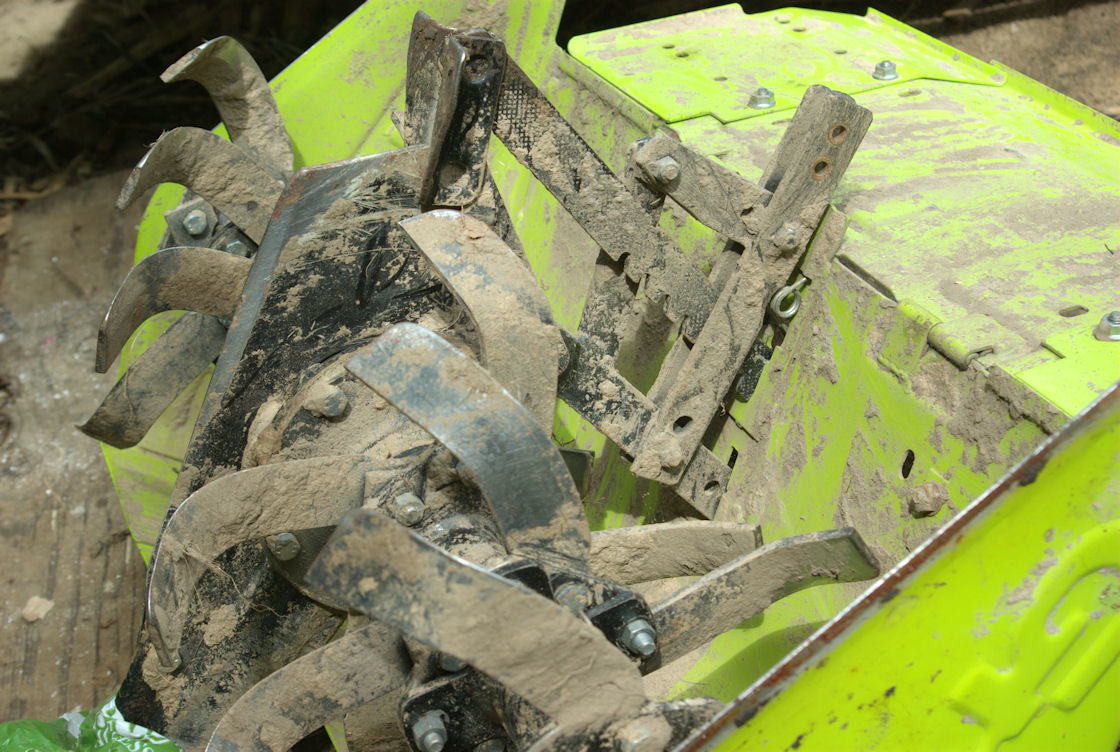

Hi! We speak walk behind tiller. When young I run the Ariens 9hp Wisconsin with springs tines no differential make very good job. expensive to repair tines. I own a Troy-Bilt Horse tiller for ten years very good. But instable (engine is too high) no differential. I have now a old BCS tiller and the best a Grillo 107d with tiller They have Bolo tines And each set is off set than a spiral run very smooth and depth is very adjustable. A Grillo 85d with a tiller is about the same price than a Troy-Bilt Horse But a superior machine 9 hp GX Honda with differential you can add mower snowblower etc. Good luck! Oldmech
   / Best rear tine tiller? #20
Hi! I add a pict. of Grillo tiller. Look the tines pattern Work very smooth. I like the one inch increment of depth control. Good luck Oldmech
