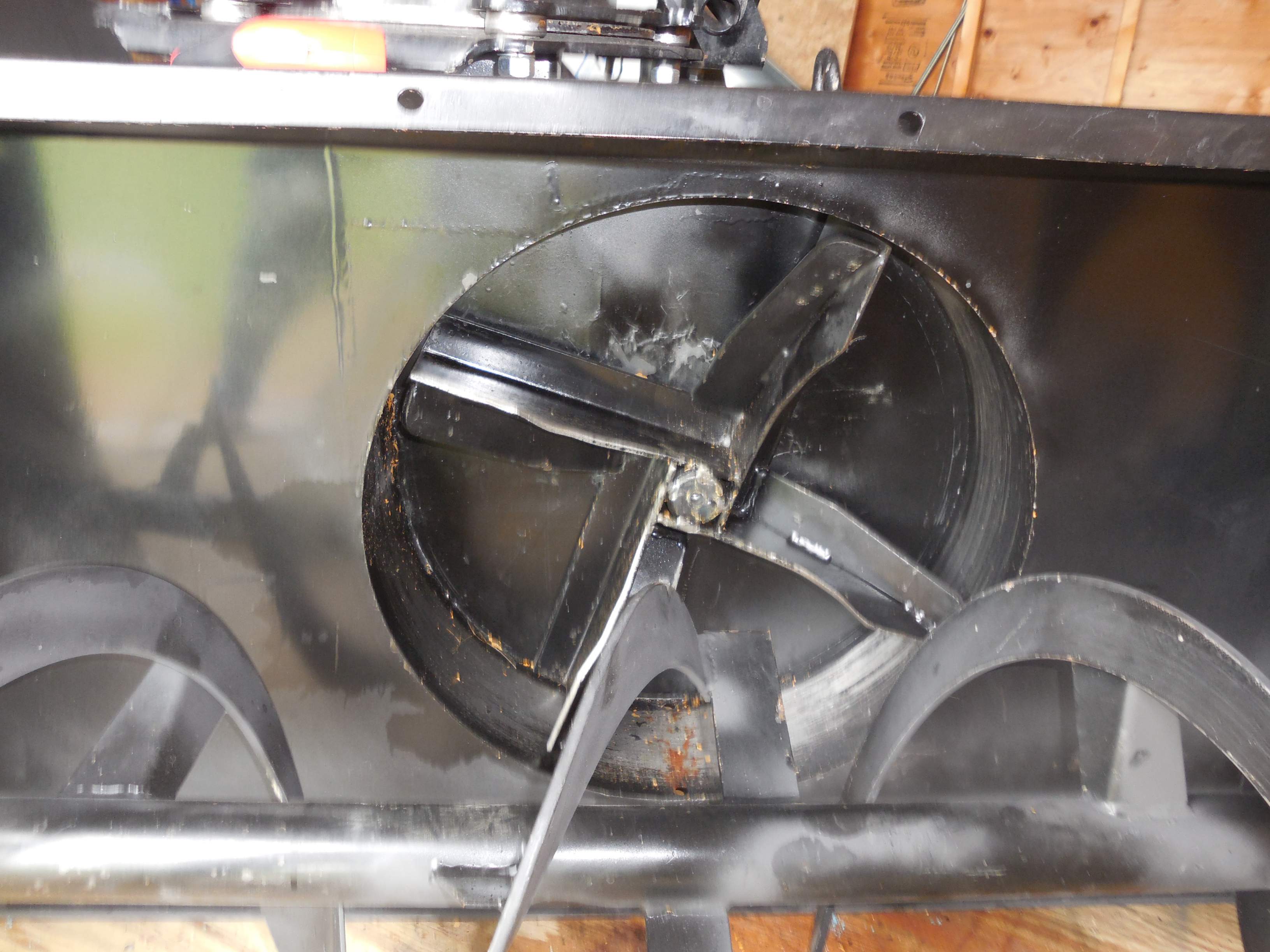

I will keep trying to separate my SB51 snowblower fan from the gearbox shaft. I think if I stand the blower up on the auger end I can spray the penetrating oil so it drips into the coupling better, then soak it over a period of days.
What is a real good penetrating fluid to use? I have some Liquid Wrench but it's not doing the job so far.

I am the OP and will soak this part with Kroil if I can find it locally. I am going to reposition the blower so the penetrating oil will run into the coupling/shaft assembly. Then I will soak for 3 days or more.
The manufacturer has told me twice that the parts should come apart (blower fan will separate from the gearbox shaft) with a little prying and striking with a hammer. Ain't happening, I have pried and pried, and struck and struck without any movement at all.
Manufacturer says heat could damage the gearbox seal so I am hesitant to do that. Don't really know what to do except keep soaking and then pry some more.

Some pics may help us offer some more suggestions

My first attempt to post photos. Here are a couple of the snowblower fan and gearbox.
