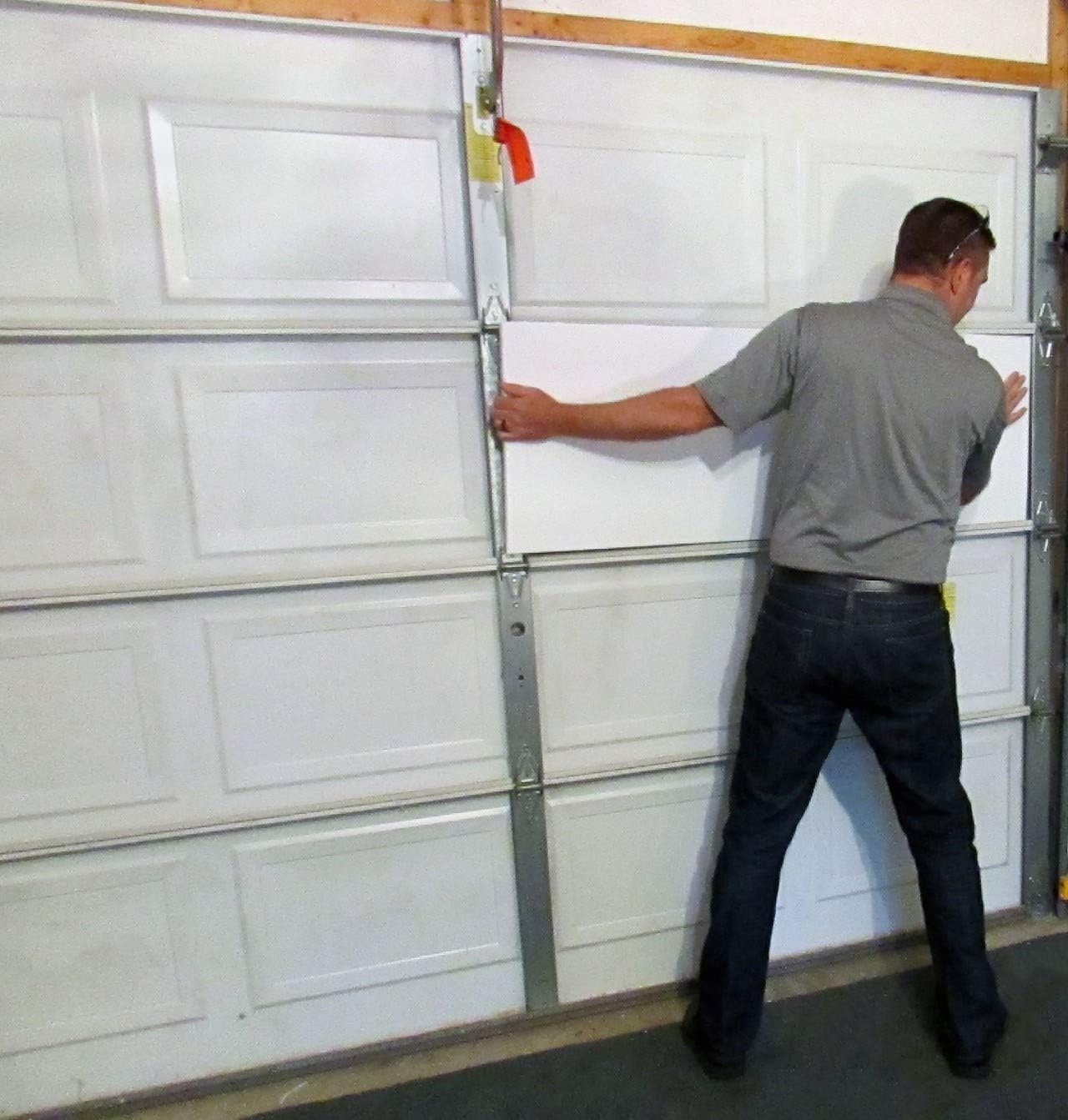

I’ve done this before using foil covered dense foam board. Pretty easy to cut the board to fit inside of the door panels and attach with construction adhesive.
   / Best Options for Garage Door Insulation? #16
My neighbor installed this product on his uninsulated garage door:
He says it does make the garage a few degrees cooler in summer and a bit warmer in winter. In his case, the relatively low cost will likely pay for itself in a few years.
Not so in my case. 20 years ago, I replaced my garage doors with 2" insulated Raynor doors when the old wooden doors wore out. Yes, there is a difference, but I doubt I will ever make up the installation cost with savings in heat / AC.
Every situation is different but IMO, there is little or no cost savings when replacing a perfectly good garage door with an insulated one. Replacing it for comfort reasons is a different story though and may justify the expense.

Hello. I have a double single skin up and over garage door, and it gets sharpish in the garage over the winter months, up in’ North. Does anyone have any thoughts on insulting such a door? was thinking something like the insulating boards, used for underfloor or cavity insulation?
Buy the thickest foam core board with foil exterior that will fit into the inside door panels. Cut to fit and install with construction adhesive.
