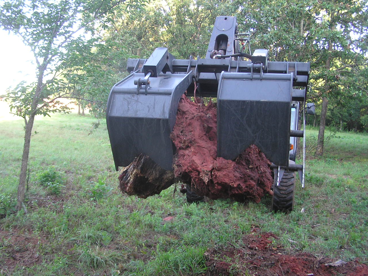

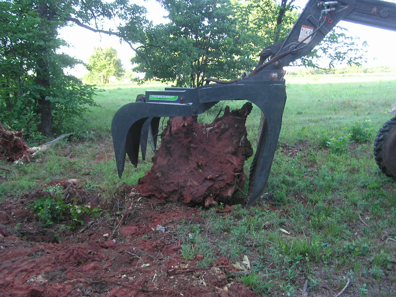

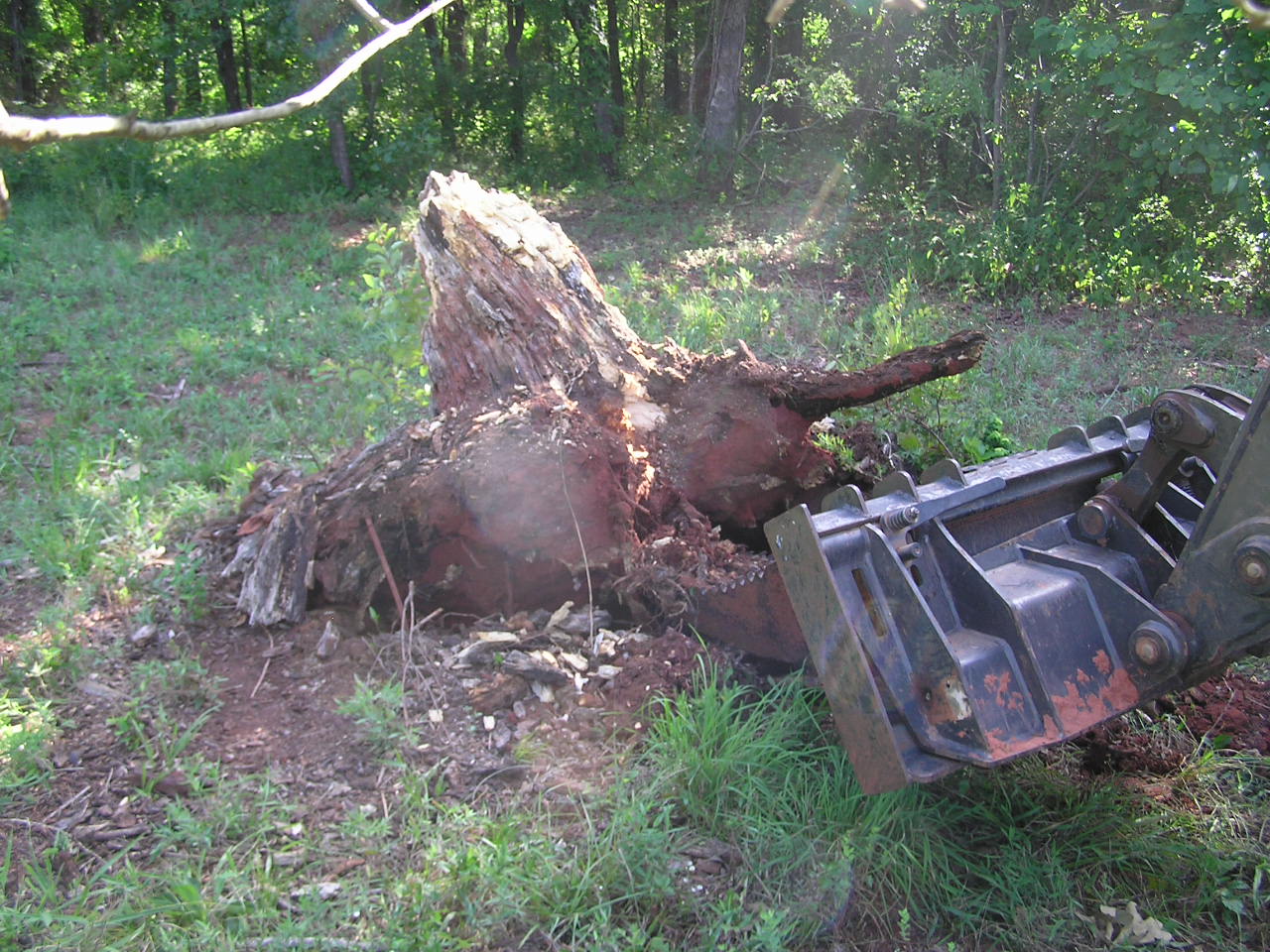

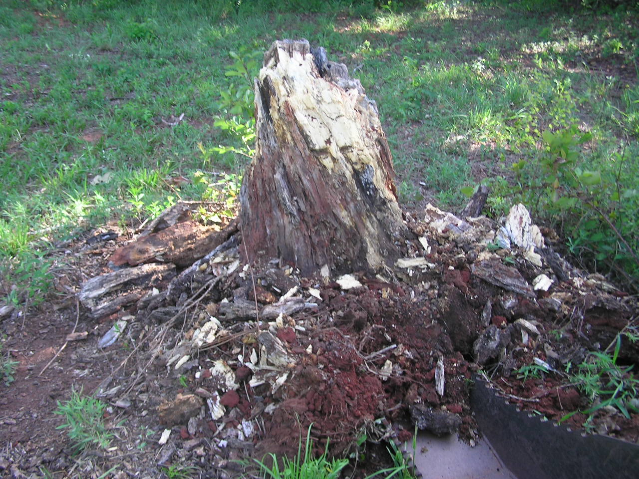

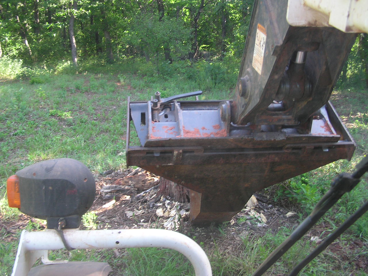

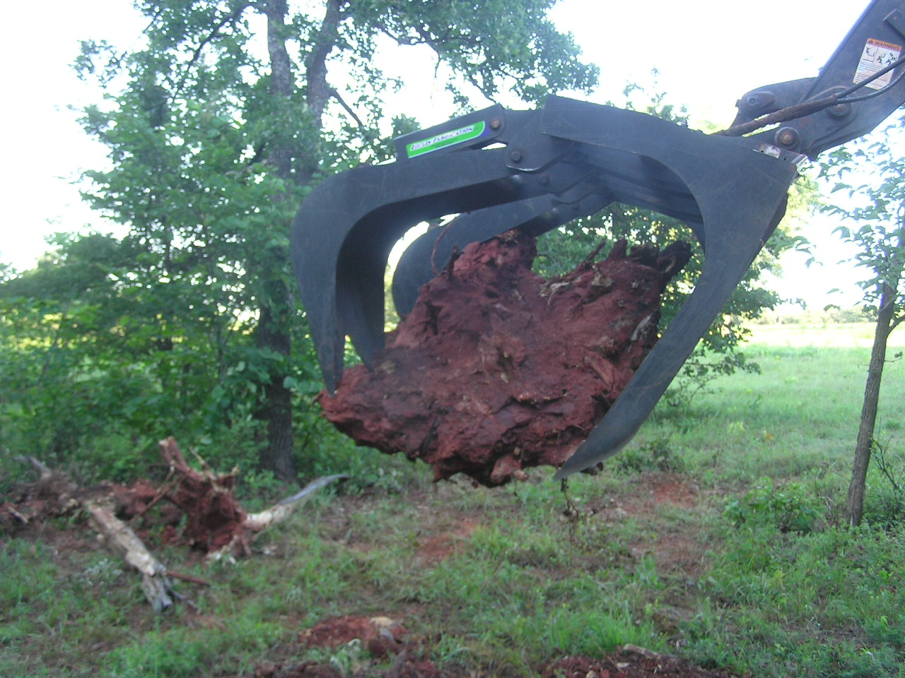

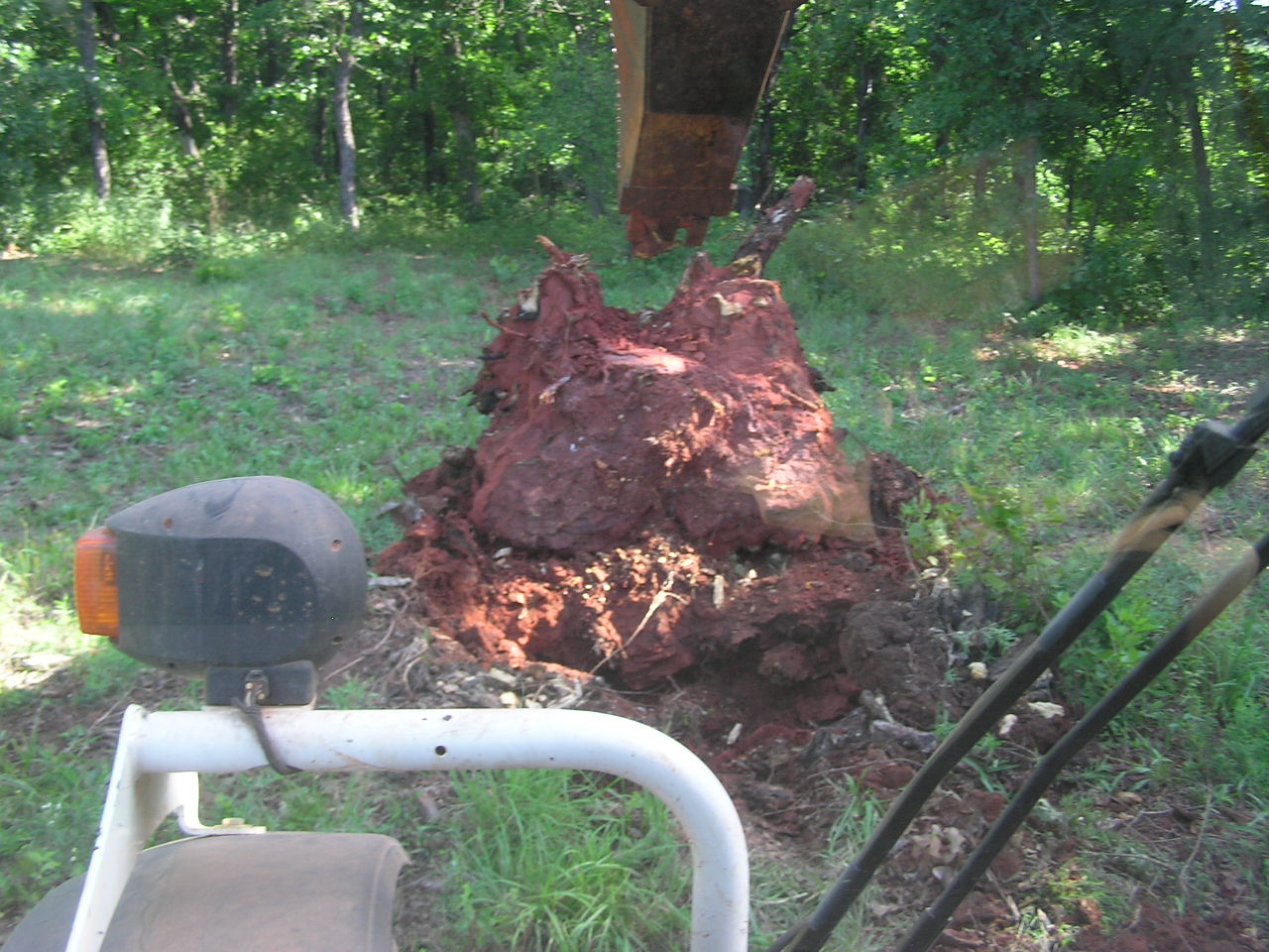

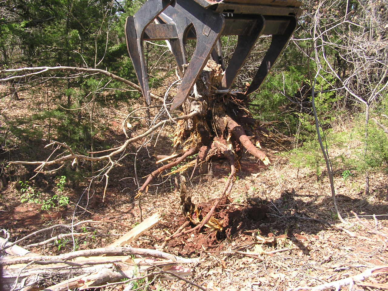

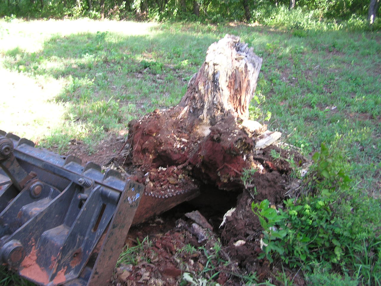

Well since the OP bought a tractor and the thread is still going, I will show how my Compact Telehandler took out an old stump, with the stump bucket, in less than ten minutes. :thumbsup:
You can see the size of the root ball in the 51 inch grapple opening.

You just had to bring up "stumps" didn't you.... ;)
I would have rooted it out of the ground with my Grapple and carried it away. Saved the trip back to the shed to change attachments.... :)

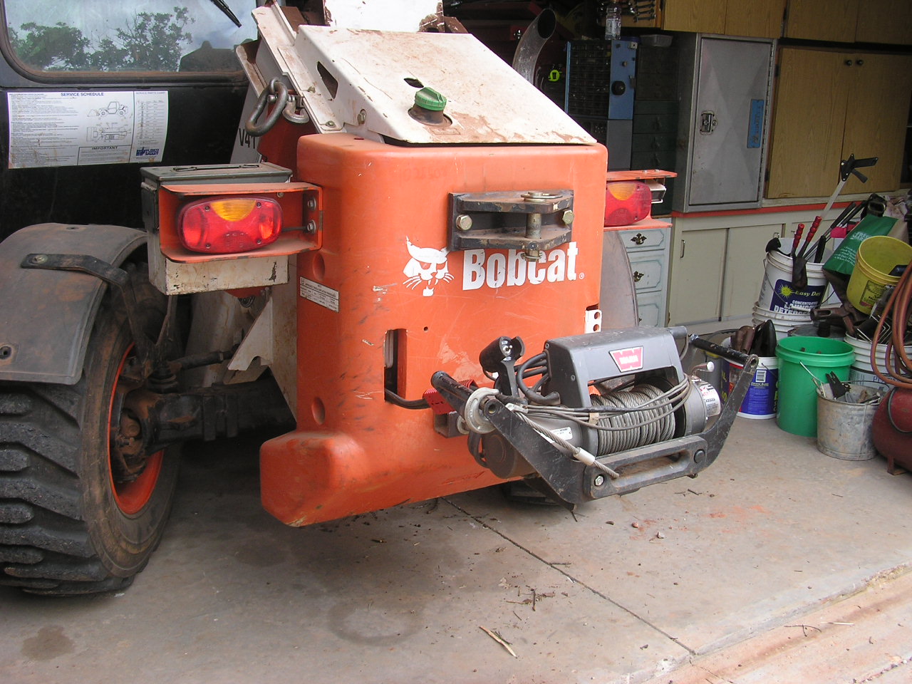

Man that thing is cool. Makes me wonder how it would do with a hydraulic skidding winch on the boom. I like your electric setup on the back in this thread.

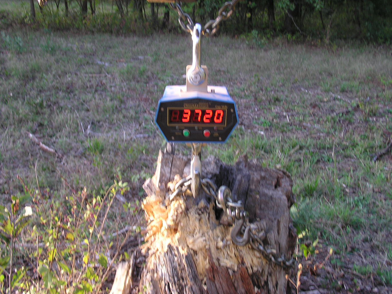

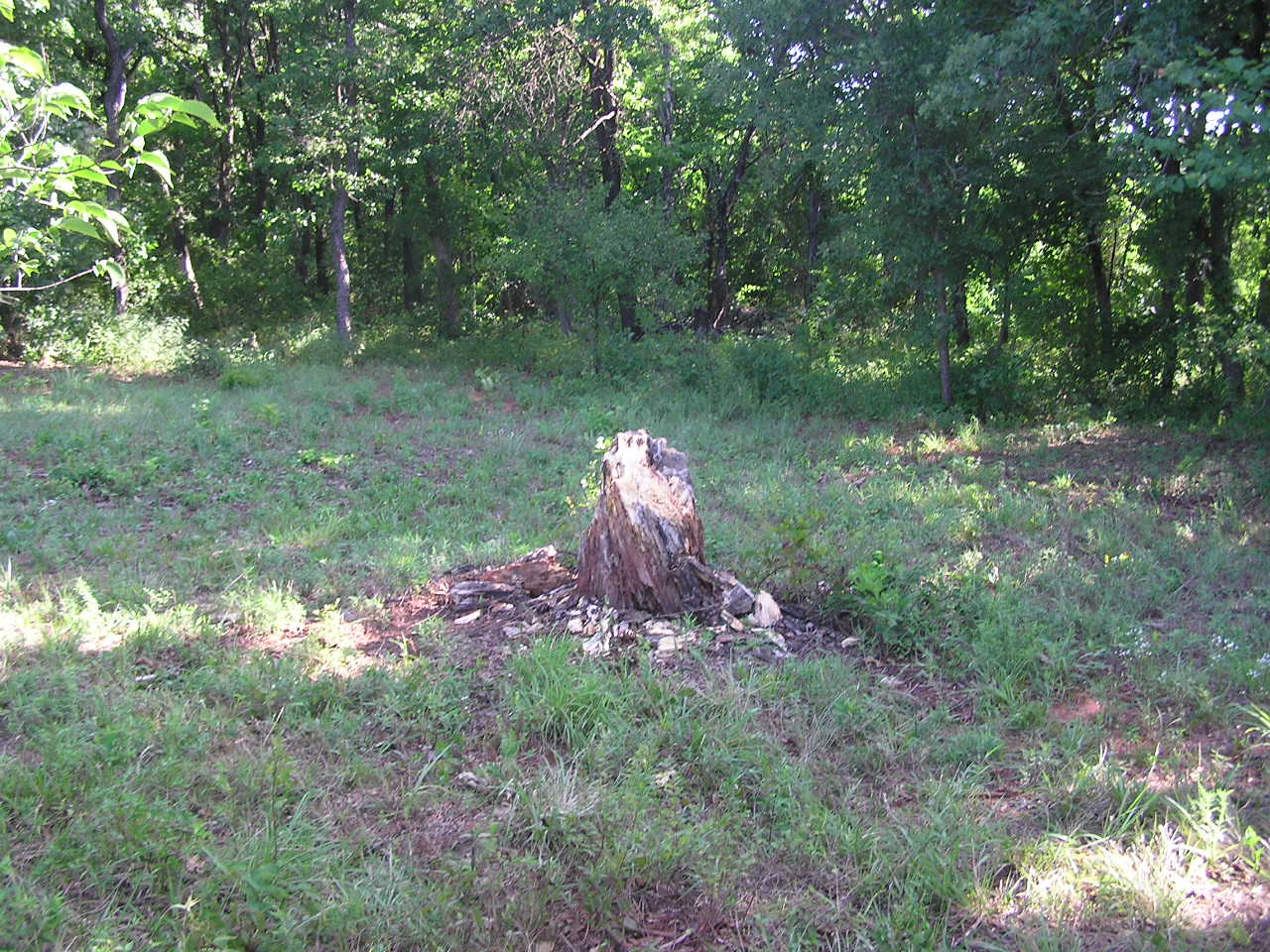

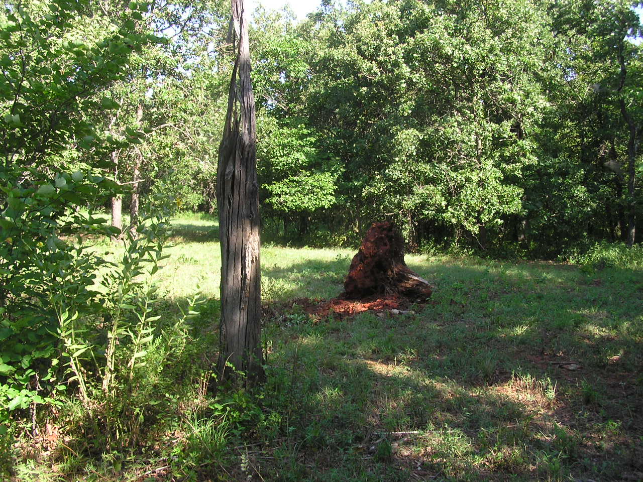

I had the stump bucket on and was working in the area, so I would have had to go get the grapple any way.

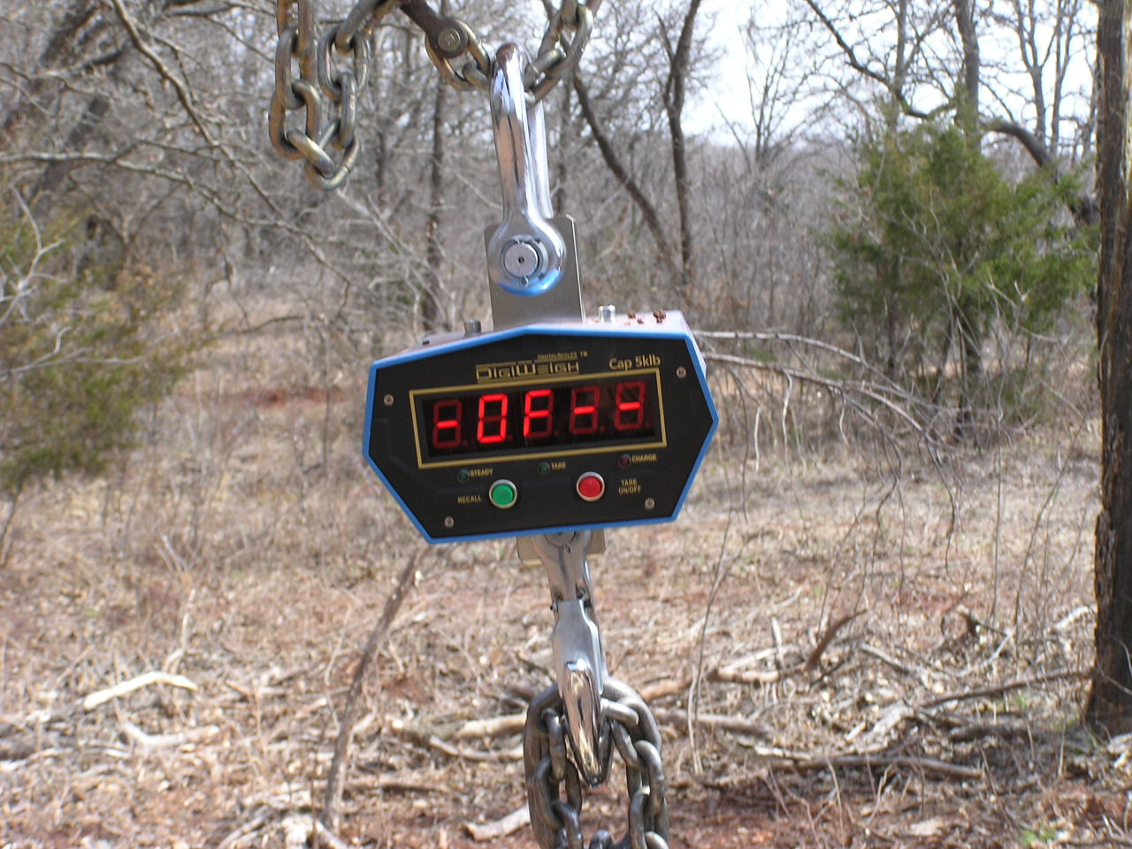

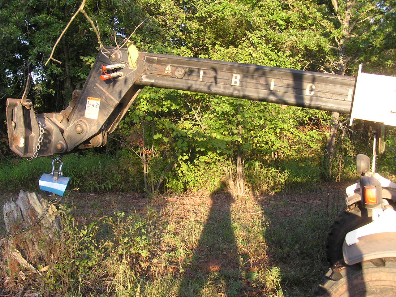

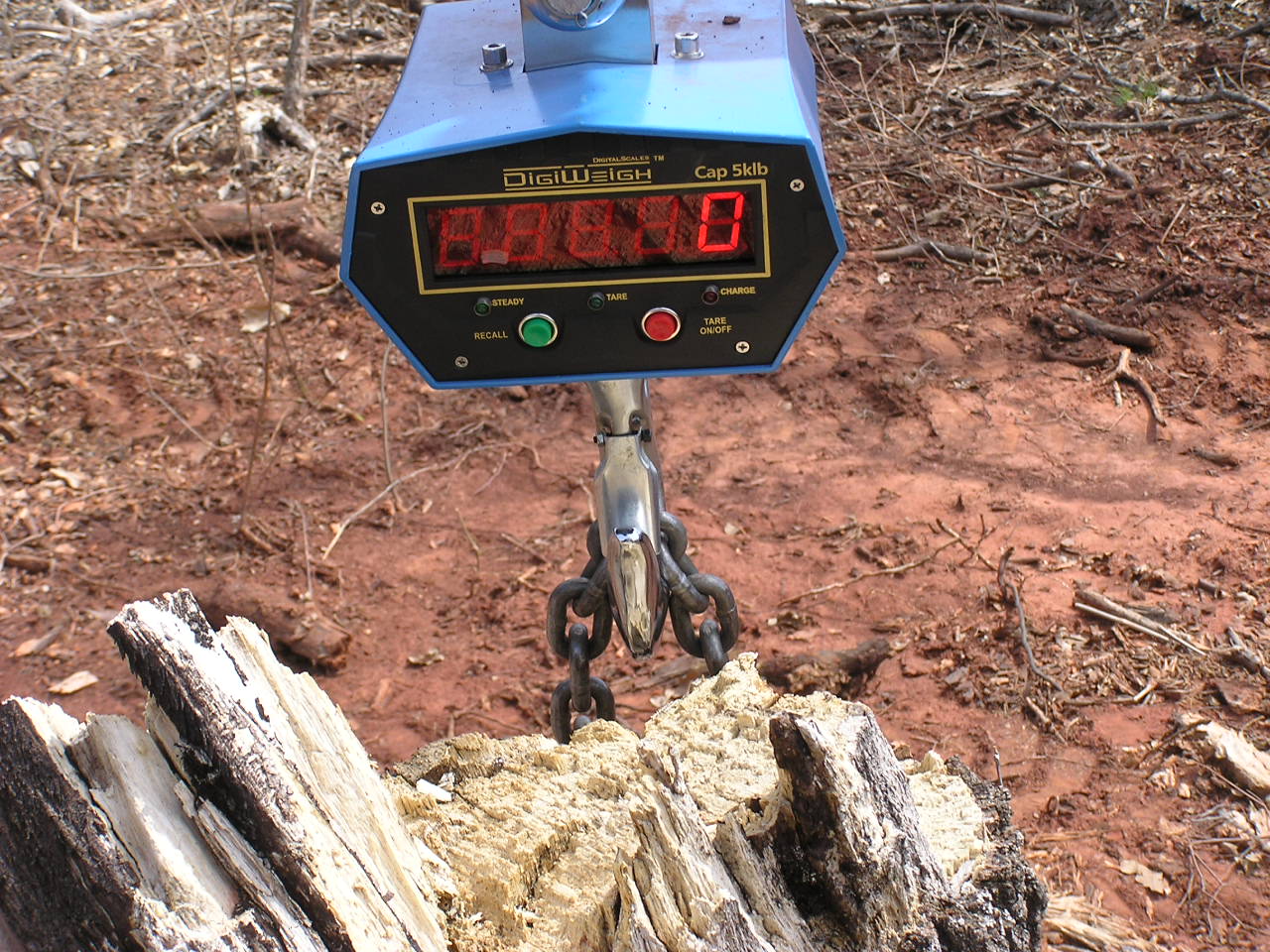

It was the stump that I have used many times testing the lift power. With the boom retracted and the scale zeroed from the weight of the chain I slowly raised it and saw the scale show 5001, then overflow.

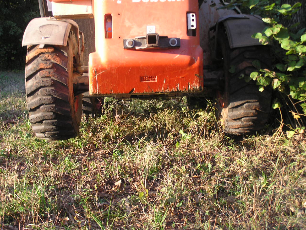

So I backed up, extended the boom all the way, it took 3720 pounds to lift the rear end up off of the ground.

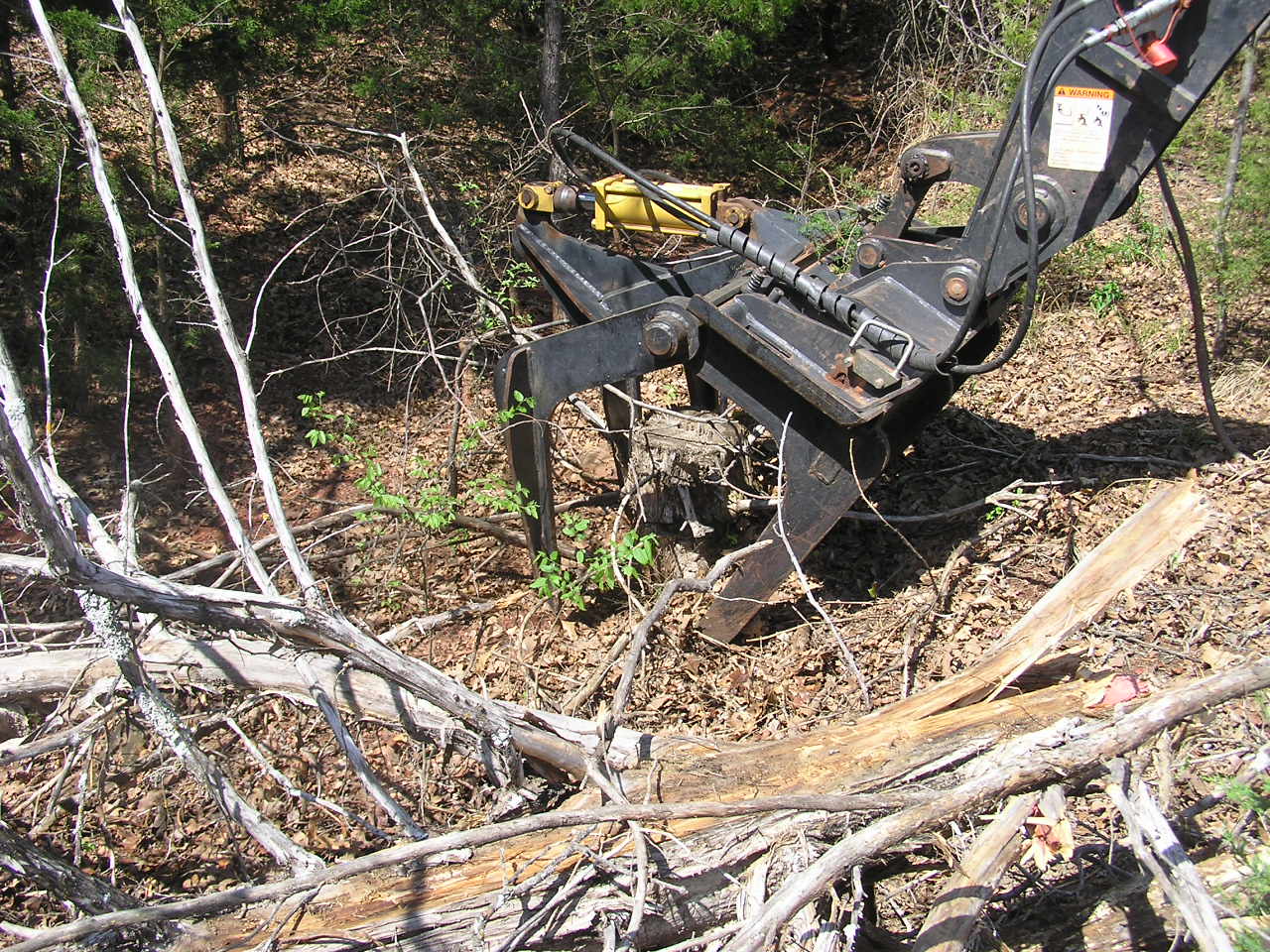

Always cool to see how everyone else accomplishes the same task even if it is with different equipment. What about that other grapple you had in the background of one of your pics on another thread. What does that go to?

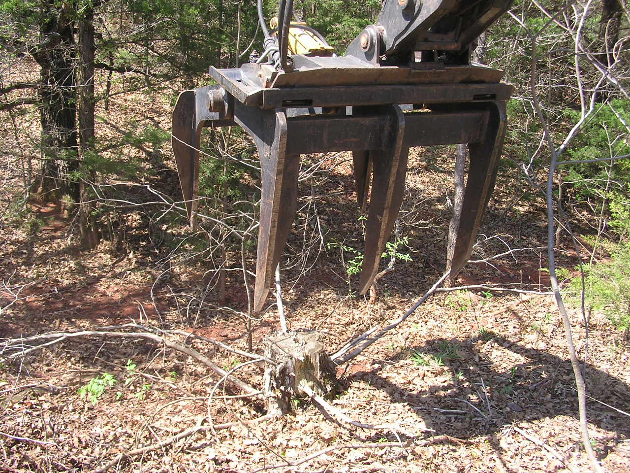

This is the 44 inch wide Gorilla Grapple, it opens to 31 inches.
Pulling a ten inch cedar stump with the two center tines:
