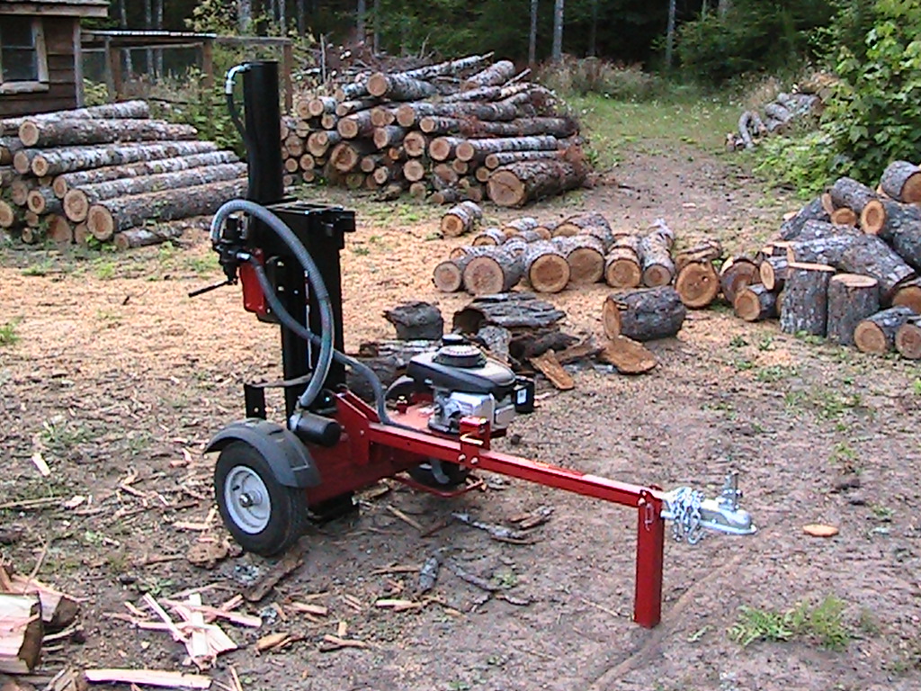

I got a 27 ton troy bilt with the Honda engine last winter and absolutely love it. Very quiet motor, quieter than the Subaru or the Briggs. It will do some serious work, I have put 12 hour days on it and it has never failed me once. I have split probably around 30 cord with it, maybe more. It will split anything I throw at it, it splits through 25" rounds like a hot knife on butter. It splits knotty oak very well too. I probably use it vertically 70% of the time and horizontal 30% of the time for small rounds. Lately I have been using it for about 1 hour a night, no problems at all. :thumbsup: Very happy owner. :thumbsup:

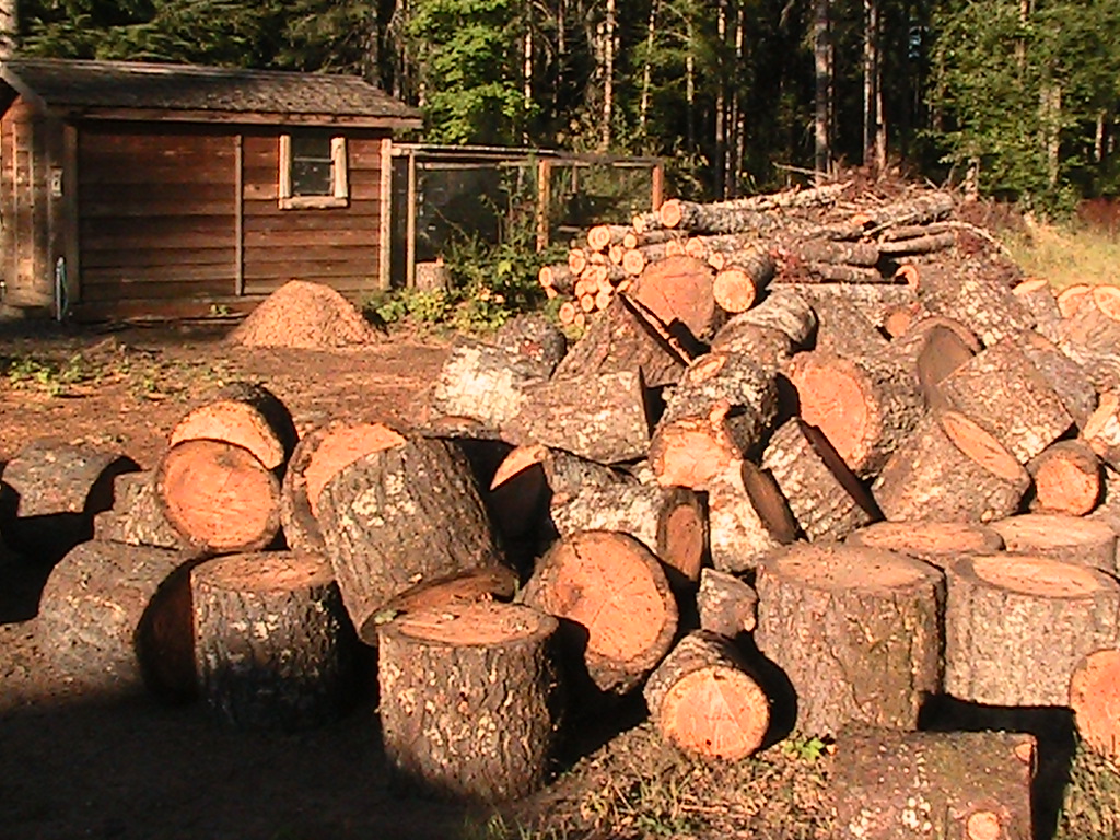

Those are nice chunks of Doug fir. Mine often have 4"+ knots. My very old former rental splitter rated at maybe 16 tons splits them, but it works at it. 24"+ logs without knots it just plows right thru.
