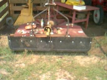

I think a KK or howse 5' mower should be great for light to medium duty cutting.. and come in inthe 600$ range.
Guards can be made for about 20$ and a set of truck mud flaps.
Soundguy
GeauxLSU said:
Well that's not good. I don't have a friend like that. ;)
Do the BH/Woods come in under $900 WITH guards?
