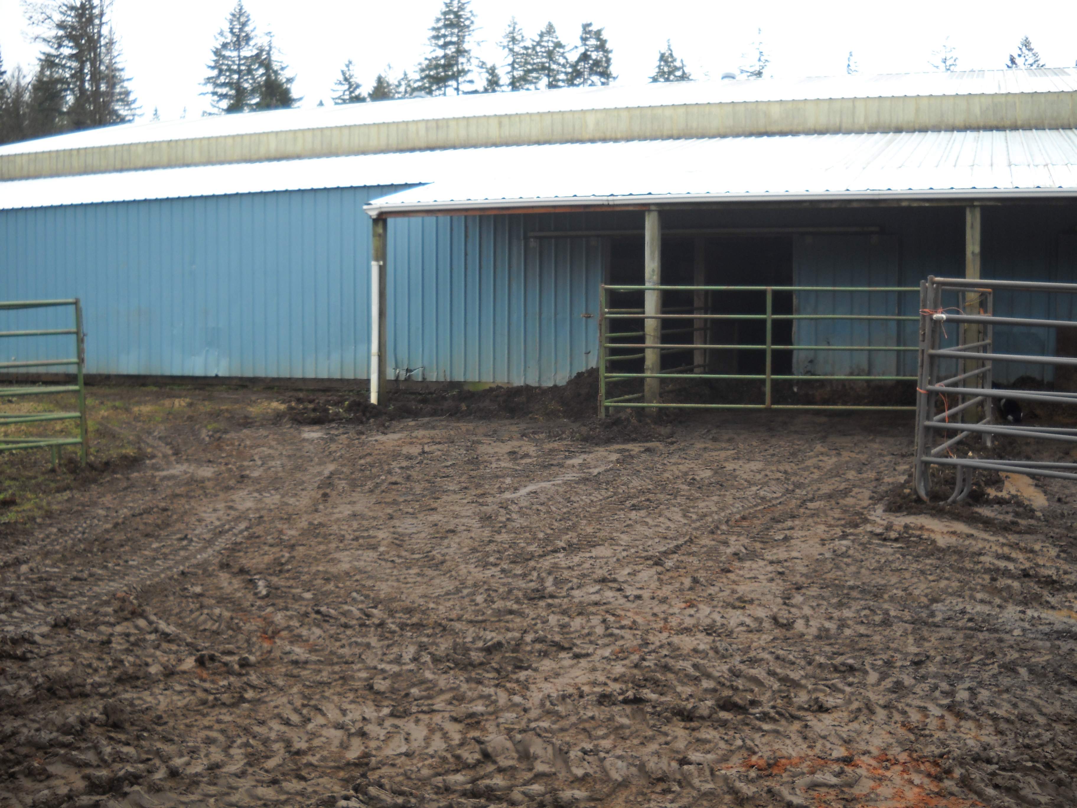

The Moon is a good analogy. Except it is a very wet and very muddy Moon. The mud is literally a foot deep in spots. The paddock is about 90 x 200 ft. With some gentle roll to it. When we moved in it had not been used in quite some time and it was turf covered and had been maintained. The barn is a about 22x30 containing 2 stalls a tack room and a 3rd stall with a 10ft sliding door opening into the paddock. We use this "3rd Stall" as a sort of run in. The ground in front of this sliding door is brutal. Total muck and has dropped below the threshold of the barn door. This is probably the lowest spot in the paddock as well. This is where the deepest mud is from the traffic it receives. I have had suggestions of filling it with wood chips or pea gravel etc. to build it back up. Which I will do. I just need to find a way to not let it get so bad again and levelling the ground a bit is where I plan to start. I'm afraid of doing it and watching the fill disapear into the mud again.

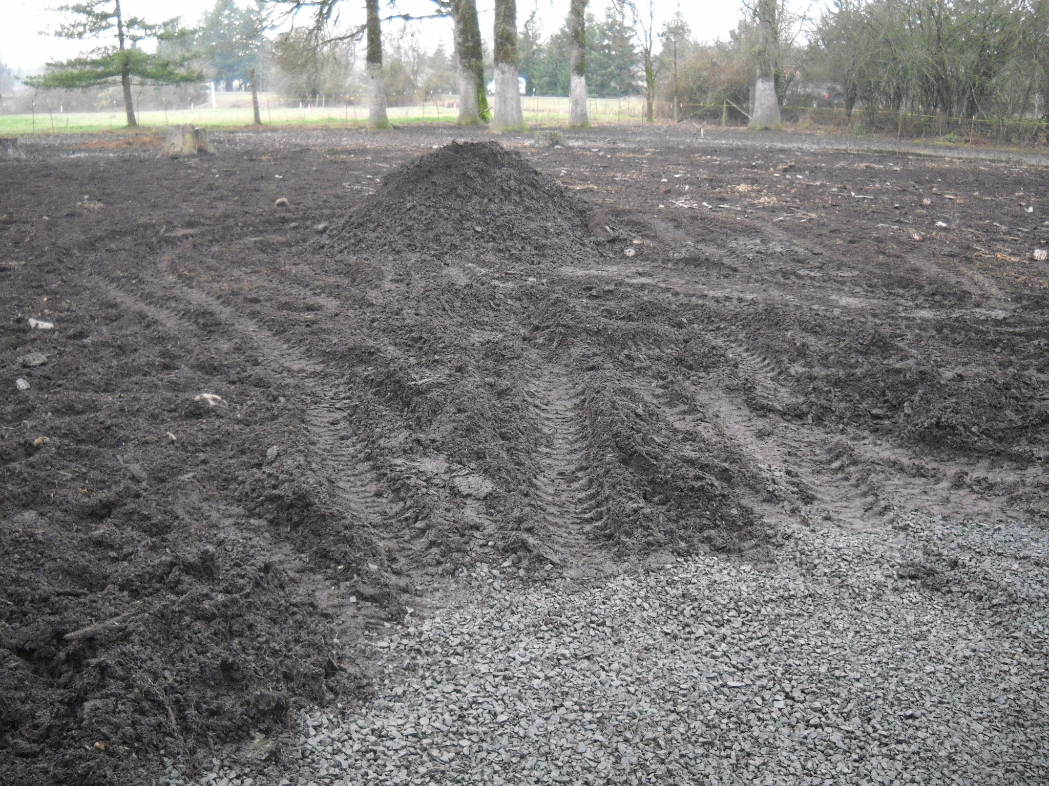

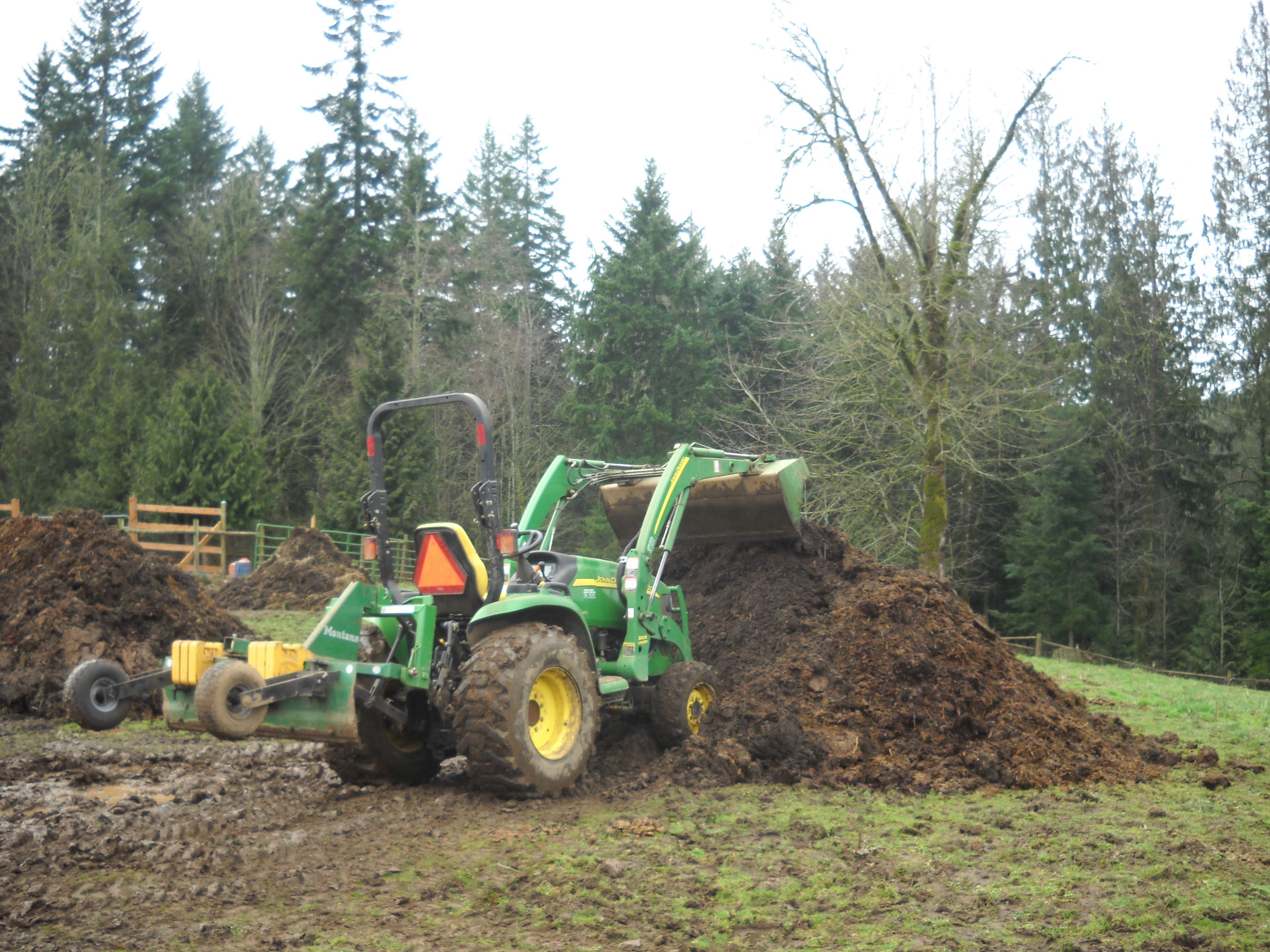

There are actually a lot of things you can try to minimize mud. My grandpa put in hog fuel several years ago (it was a 4' thick layer) and it held up very well for many years with a major amount of horse traffic (78 horses on 4 acres). Another thing that my Dad has tried is pit run and a 1'-6" thick layer of hog fuel which held up pretty well for a few years but turned to slop in the end of year two. This last winter I went in with the 3720 (we had the whole area in 1' of deep mud which i estimate to be around 60'x90') and i just spent several hours on the 3720 (wishing I had a steering knob) scooping and dumping the mud/manure into three big piles. Why did I do that? It gets the mud off the ground, having it in a pile means it is less likely to be disturbed, having it in a pile is a much smaller foot print, and we plan to spread the manure/mud in the pasture this summer when the ground dries up. It is great for the pasture, you can fill in holes, level areas better, it will be great for the grass, and it involes more seat time. :thumbsup::D I Also have tried gravel in some spots and put a thin layer of hog fuel on top and that held up very well, i was actually surprized how well it worked out. I've attached a few pictures to give you an idea. The last is my grandpa's hog fuel pasture, you can see the gravel which is right in front of the gate.

Lager, there is a risk with wood chips. If there is no drainage, the wood chips soak up water, and seem to never dry out. The action of the horses churn up a mess of chips and wood.
If you want to do this, I would suggest creating a drainage plane: Bring enough soil in that the corral is higher in the center, and slope it down hill right to (or beyond) the edges. Doesn't have to be much slope 1" in 10 feet is enough. Pack that as hard as you can, then put your chips down.
Even doing this, you will likely need several batches of chips.
