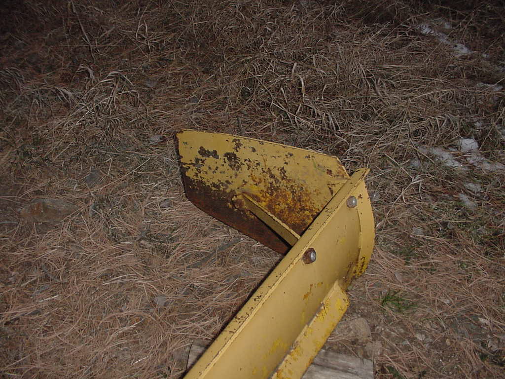

Optional blade-end "shoes" will allow your blade to move earth faster.

I call those things "blade end caps" and as good as they are, I don't think that most people have ever seen them or how useful they make a grader blade. For some reason end caps are rarely seen in spite of being useful and inexpensive. I bought them as optional parts for both our Big Rhino grader blades.
The kind I got are the inexpensive type that use three bolts to fasten them to the end of the grader blade. I've seen a better kind of end cap made with a hinge so it can simply be swung up on top of the grader blade and locked there.
Anyway they mount, a grader blade with endcaps is the hot setup for shaping dirt. With one or both end caps on, the grader blade works just like a box blade, but with the advantage that it can be angled, offset, and tilted - all things that are difficult or impossible with a box blade.

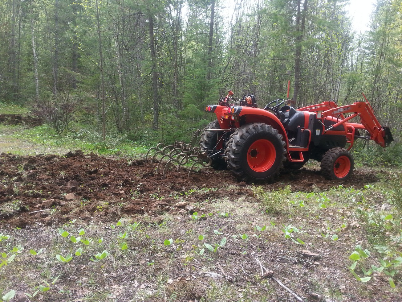

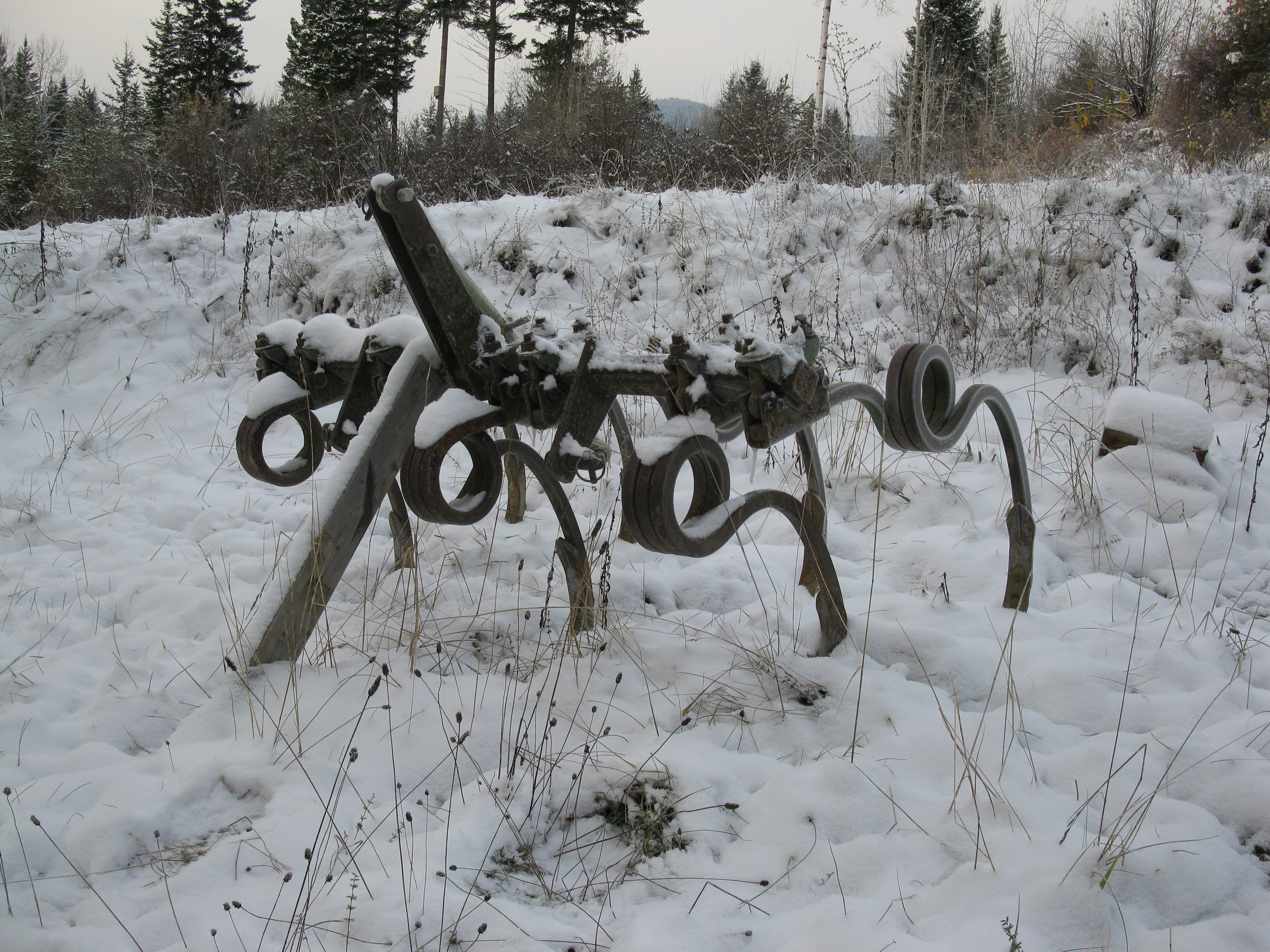

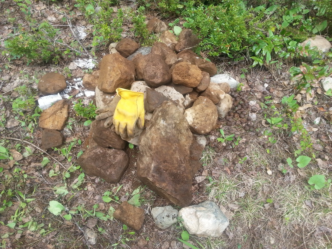

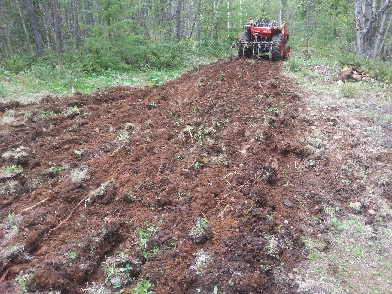

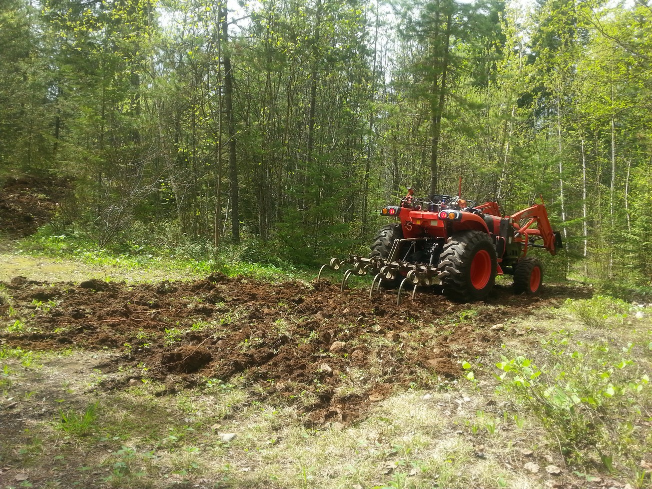

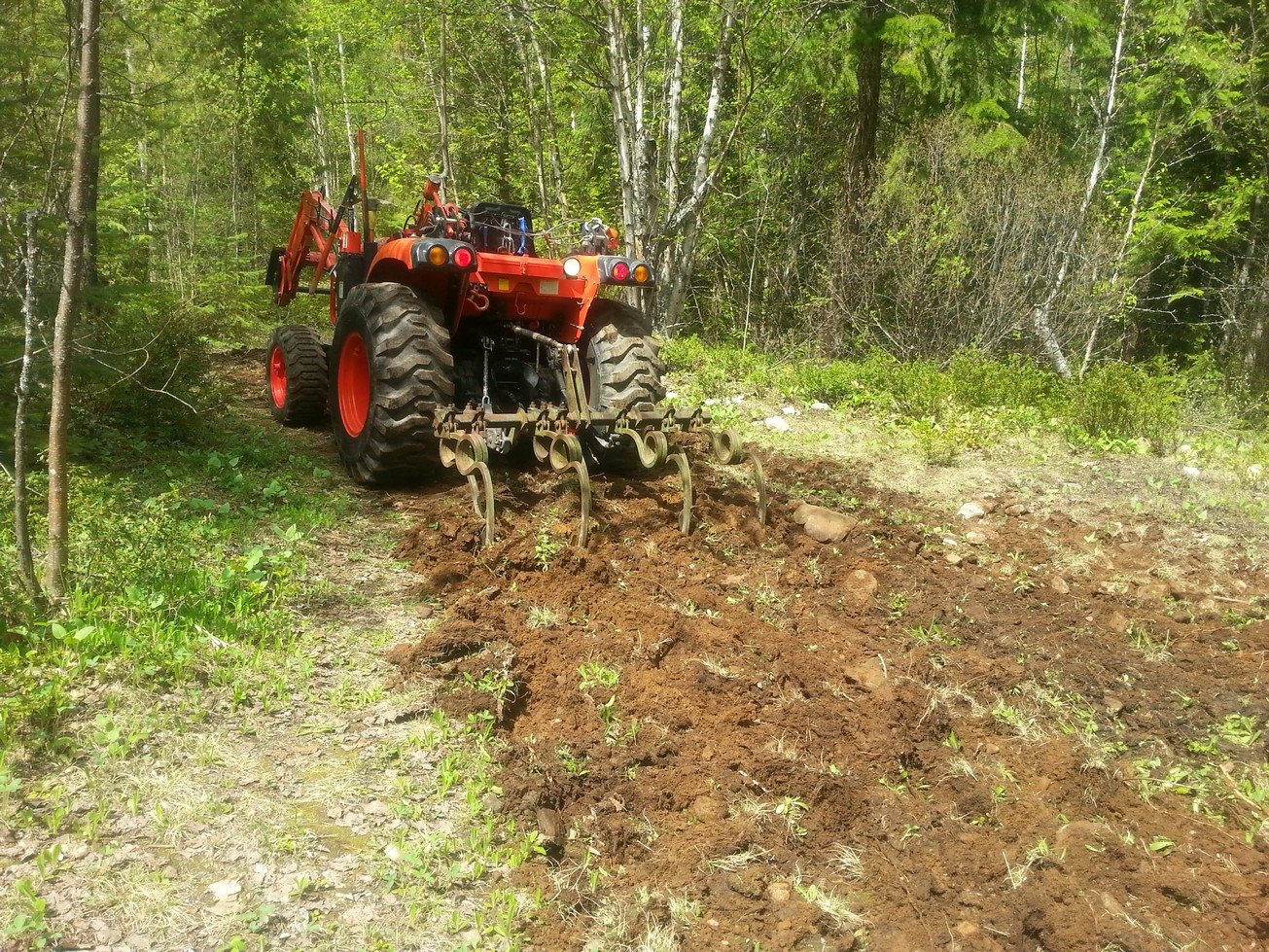

I have a tough cultivator that works well for loosening soil and rocks. The tines are flexible. They will dig about 18" and easily pull large rocks out of tough soil such as clay. I then use a blade to shape the loose material to the contour I want. For a more finished job and trash removal I use a landscape rake with guage wheels.
