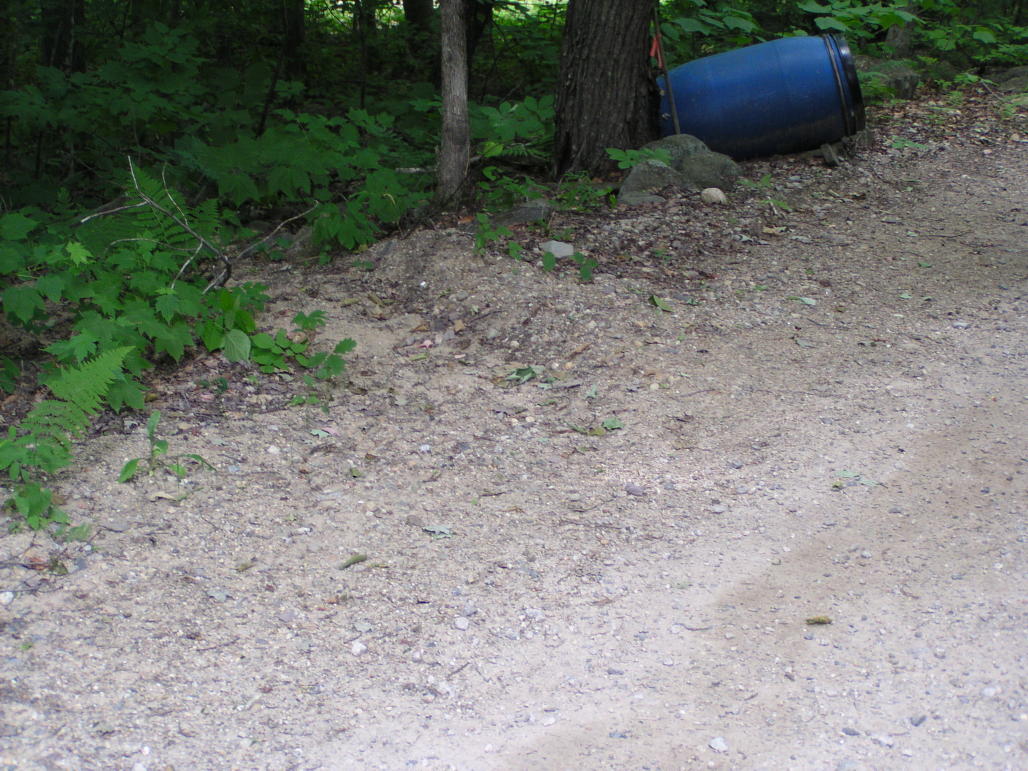

Licklog said:
I am interested in putting water bars across my drive and was wondering how you went about creating them with your blade. How deep and at what angle? How do they hold up to traffic and how often do you need to repair them? Do you have any pics of them, maybe before and after?:)
Thanks
I have a good crown on my driveway; see driveway A photo, so the water flows to the sides. On the right side the sheet flow goes right into a ditch and then off to the side.
On the left side the ground is flat and then drops off well to the side. About every 50 feet I cut a channel with a small berm on the down side to divert water off to the side. See photo driveway B. For lack of a better term I call it a water bar. They are angled 30 to 45 degrees to the driveway. They extend into the driveway only far enough to catch the water flow along the side.
I cut them by backing uphill to the side of the driveway with the blade angled, drop the blade and go forward a foot or two, then lift the blade. Later I pack the small berm down with the bucket.
I have to clean-up these cuts once or twice a year.

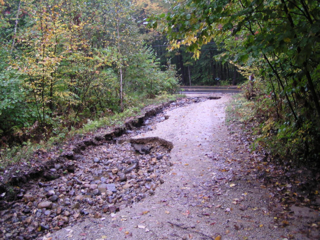

Photo driveway C is my lower driveway after a very heavy rain and with no side channels to divert the water. I have since re-engineered the drainage on that section.
