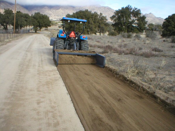

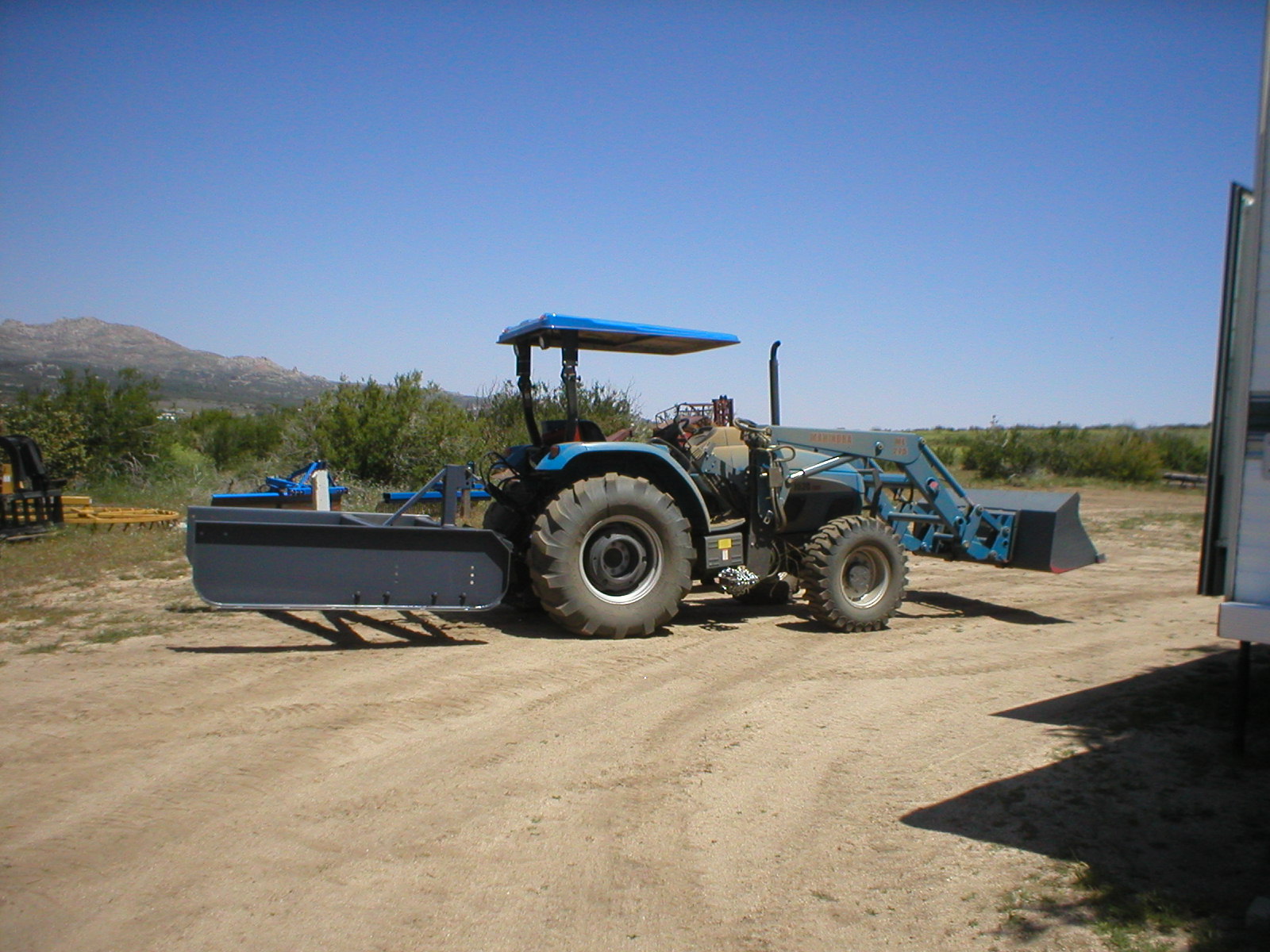

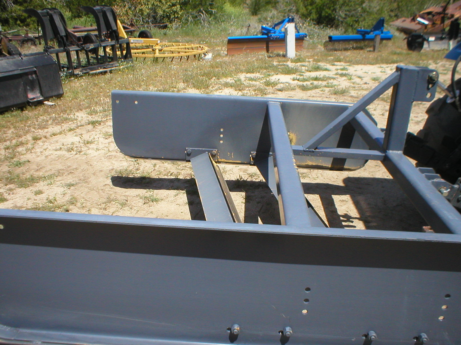

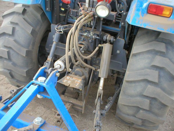

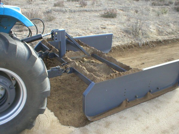

For road maintenance, you should have both the rear blade and a grader blade. Actually a good heavy duty or even an industrial box blade would be nice to have also. I have all of those plus a land scape rake and I only maintain 2 & 3/8 miles of roads. I would not be without the grader blade. It simply is indispensable when it comes to maintaining our roads. don't get me wrong, I use my rear blade on the road also, but for general overall maintenance, a grader blade is pretty hard to beat. As you probably already know, weight is your friend when it comes to grading, the heavier the better.
Here is a pic or two of my grader blade. Oh, you might want to consider getting Top and Tilt hydraulics for your 3pt hitch with as much grading as you have to do. ;)

with that much road, would look at a TNT (top and tilt) for the 3 pt hitch. so you can easily adjust top link with a cylinder, and adjust one of the lower lift arms with a cylinder. to adjust angle and tilt, of a rear scrapper blade, box blade, or land plane / grader blade.
the TNT more so the ""tilt"" can be nice to help keep the "crown" of the road. to allow better water run off. the TNT "top" can be nice adjust forward to backward angle of rear blade, but more so box blade. to cut differently into the dirt.
rear blades, can get ugly, on dirt / gravel roads. and if not careful will begin "skipping" across the dirt / gravel. leaving mini speed bumps clear down the road. rear blades are good at pulling rock that is off on the side of the road back onto the road. they can be used to help create ditches
rear blade would be an "angle cylinder" to change angle of the blade beyond the TNT for 3pt hitch.
