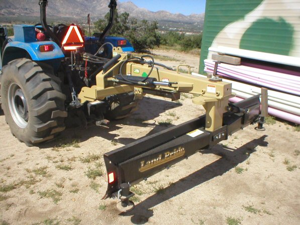

I think that you will find that most of the hydraulic actuated blades are all very similar in how they are built. Now once you start looking at these, there are 3-4 different duty ratings and THERE IS A DIFFERENCE between duty ratings. I highly recommend the Land Pride blades because I am very familiar with them, have an RBT45108. Rated to go behind a 15,000lb tractor. Land Pride rates by weight and hp. Very good blade, better than the others of that duty rating, not really. My thinking is that the manufacturers should rate for weight rather than hp, but they think that the hp figure is better and it is definitely easier. A lot of people have no idea what their tractor weighs and that is most likely why they use the hp ratings.
