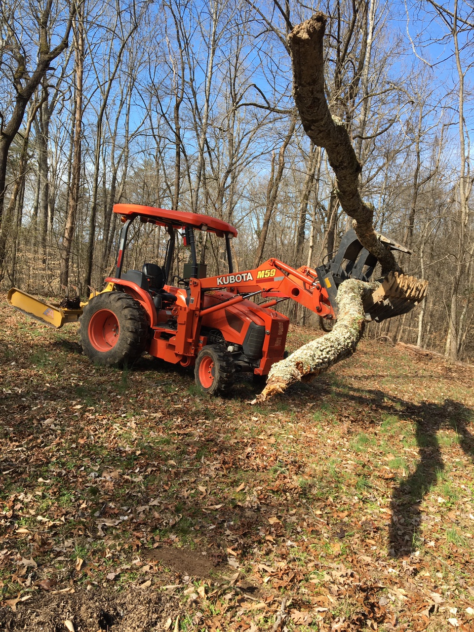

Yes. The pipe support near the teeth help gauge the tooth depth and rake thru the ground from 0-6”. The added reach long bottom very helpful too.
Each grapple style has strengths and comprises. Blessed with 4 different ones.
Have the newer EA wicked 54” long bottom on the B26 and love it. The teeth clamp together instead of bypass. Can pick up a pencil or small rocks. Great for our landscaping and orchard maintenance.
While either grapple will attach to either tractor the lighter weight grapple would maybe get hurt by the M59. 360# vs 850#
Need the brute strength on the M59 grapple. Tree logs are like huge levers. EA makes stronger skidsteer grapples. Best to ask them the best for your application. Good folks and good equipment.

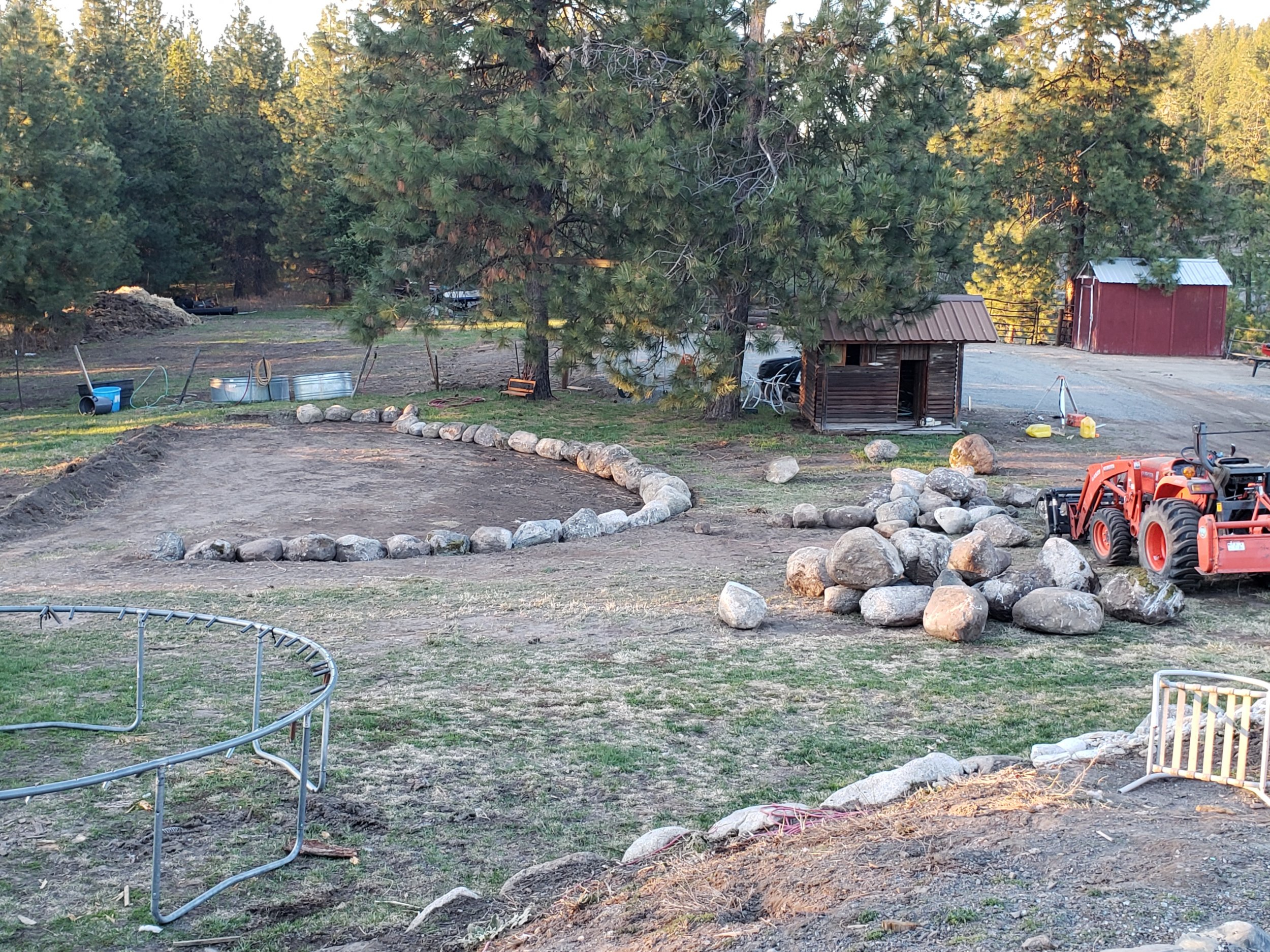

It works very good for removing roots. It has a smooth lower rake so the roots don't hang up when dumping and lets them slide up the rake without hanging up and causing them to just get pushed through the dirt. I just removed a bunch of snow berries throughout the trees and they have roots that scatter out wide and it works great. I am getting ready to thin out some smaller pine trees so I can mow in through the bigger trees. I have put this rake to the extremes gathering 6-900lb rocks for a project ad it would of been nice if they were all on the surface but no such luck, used the grapple rake to dig them out as well.
