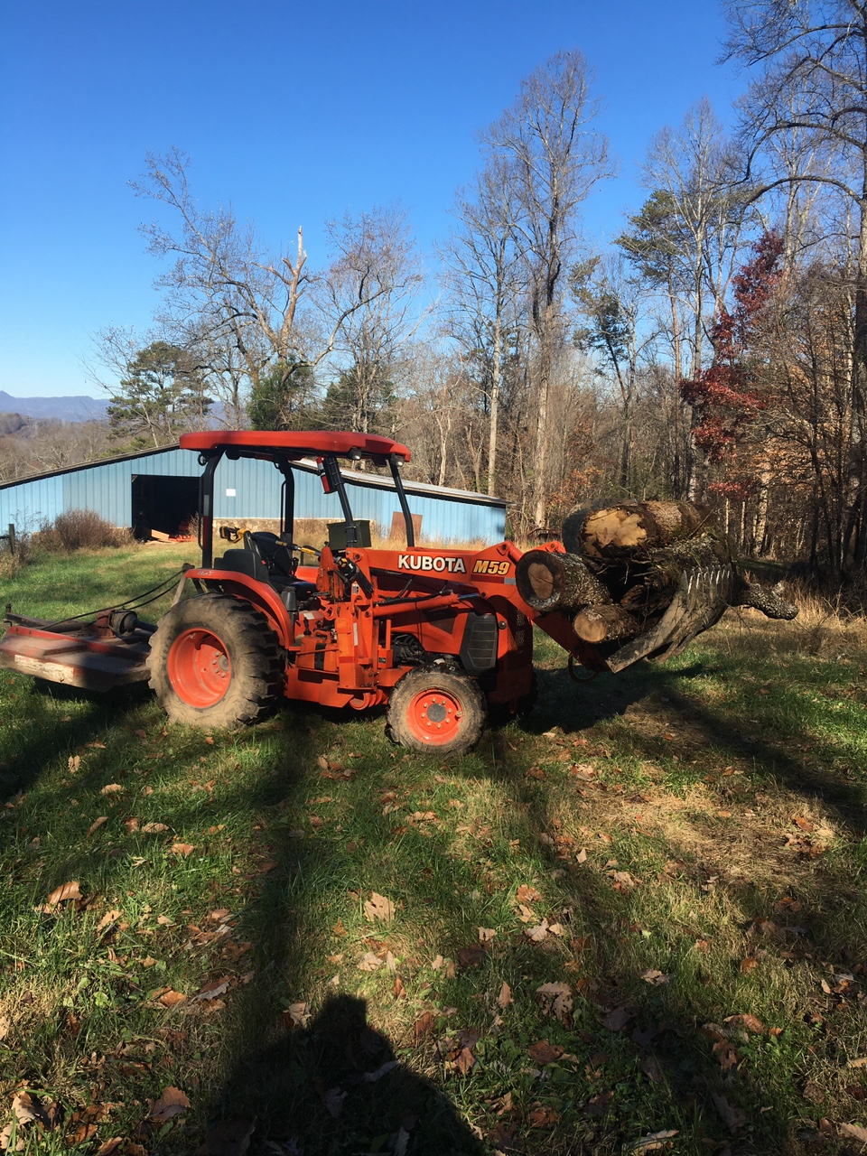

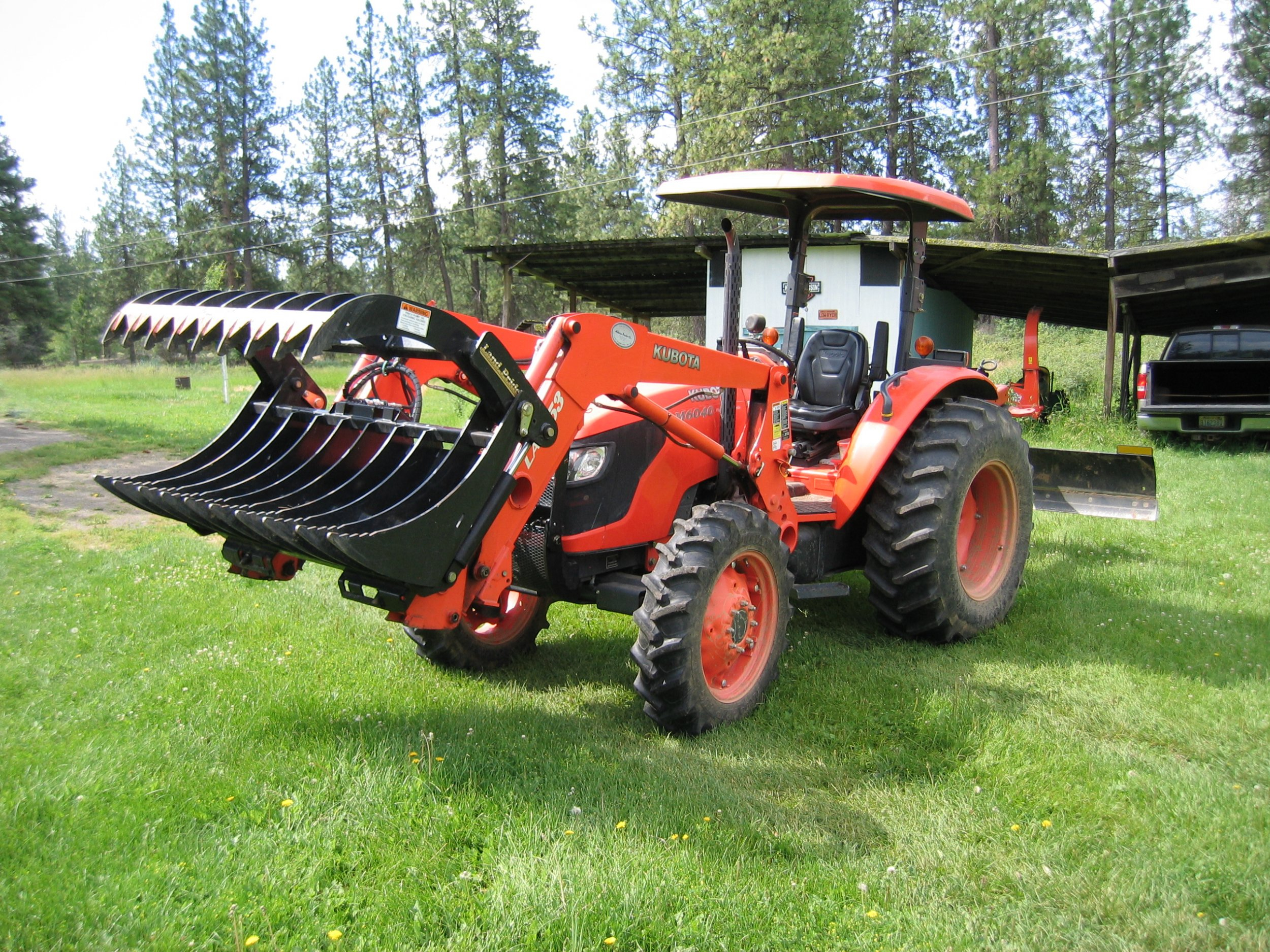

Your L48 is heavier built than most ag tractors. I run a 72” skidsteer long bottom brush grapple on my old M5030 and now M59. Would not want anything lighter duty.
EA wicked 54” grapple on the B26 is perfect for that size. They use good engineering and materials selection. Cost more, does more adds up over the years. Low Up front cost rarely is the long term bargain.

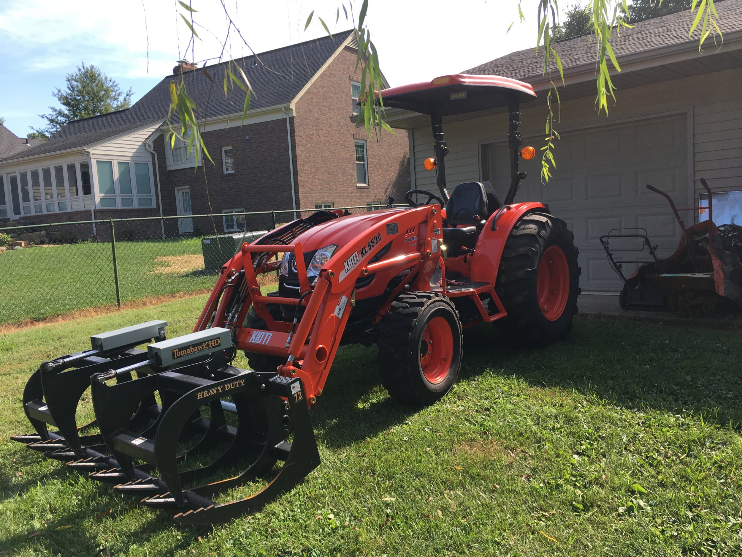

I’ve got a Kioti DK5510 with front remote. My grapple isn’t the best but works well for my use. I can pick up 3 telephone poles at once with back ballast. Depends on your needs and what you do with it. I use mine mainly to pick up firewood.
