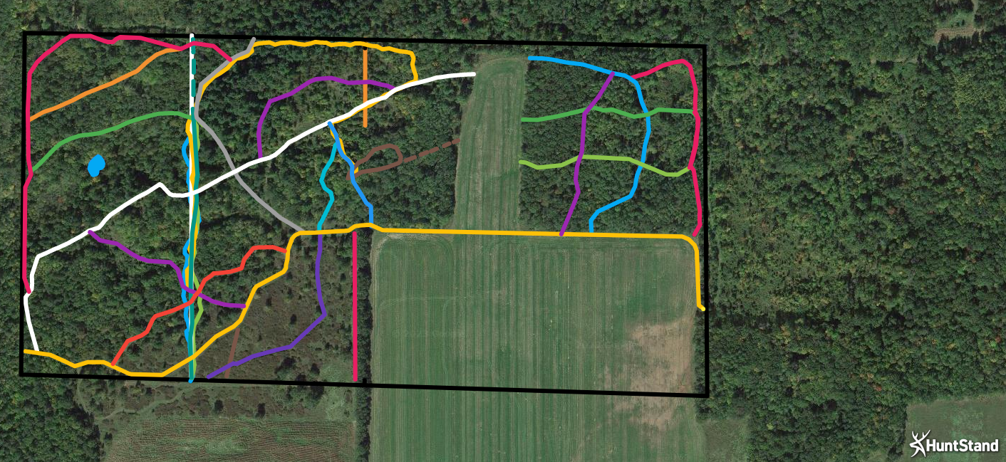

I've spent this summer widening my trails. However wide you want them, make them 50% wider. The sides will grow in and the tops will droop down (with heavy snow). If you can weave between the trees and have no stumps, then I think a disc and a drag would be the tools of choice (best for the corn field in any case).
If you will have stumps, then a bulldozer is step 1.
My trails are for ATV riding and hunting, so I just cut the stumps off close to the ground and keep mowed with a Rotary (rough cut) mower, I use the Huntstand phone app to map the trails on our 80 acres.
