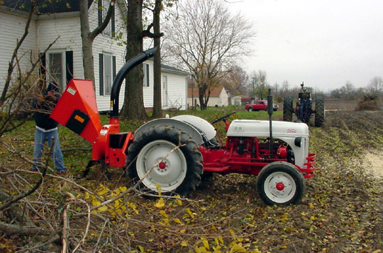

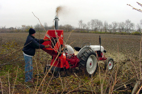

I have the BearCat CH5540 on the back of my 8N and really like it. The only wish (more money) would be for automatic feed. If you have any farm and machinery shows coming up in your area in the near future, that would be a great place to look at all the options available to you. Philip.
