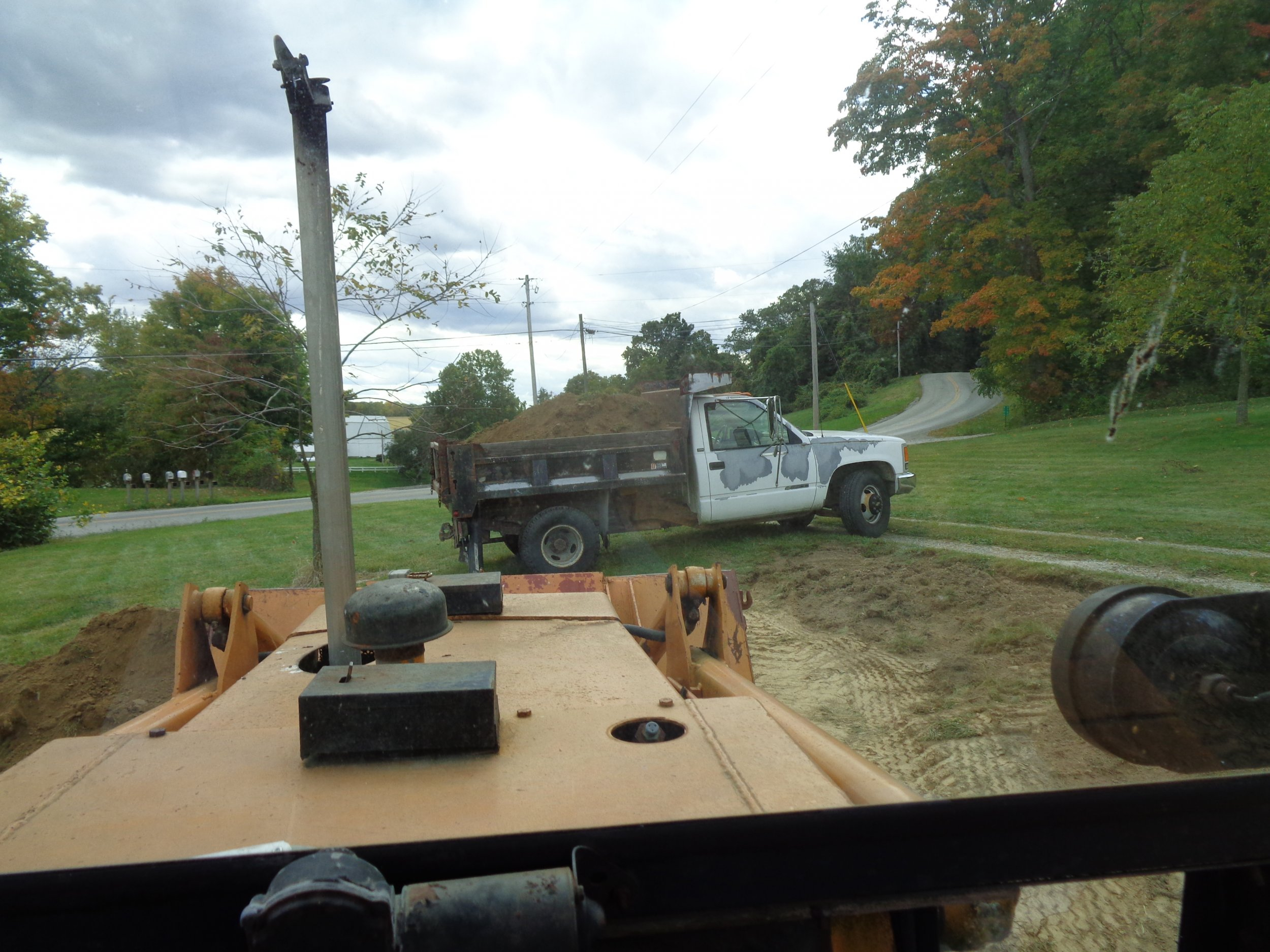

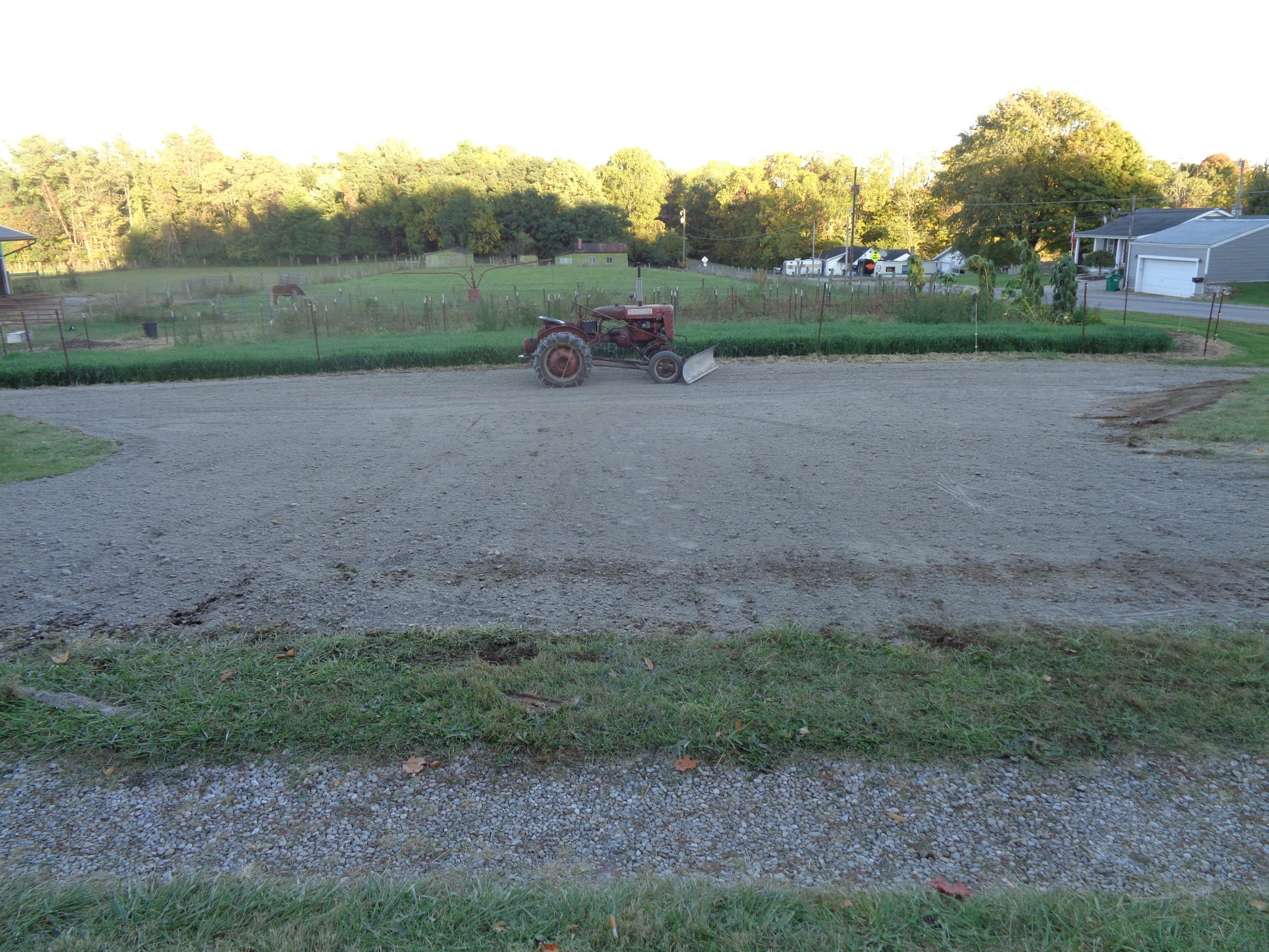

It would help to know what part of Ohio you're in. I could suggest some quarry's to get it from, at least from Columbus, to the Ohio River. North of that, not real sure. If there are any highway projects going on in your area, and they are using a limestone base out of a certain quarry, that's where you want it from. It has passed State spec's for that purpose. I put in a cross over drive between my driveways just over a year ago, to keep from running through the yard, or going out on the road, to get from point A, to point B. I cut the topsoil out which was approx. 8" deep. I wedged it deeper to approx. 12" deep at the existing drives edges, because that's where most of the surface friction would be, when turning, anything from pickups, pickups with trailers, tractors and manure spreader, to a tandem fuel oil truck. Nothing fancy to work with, just my old backhoe, 1 ton dump, and my little Farmall A with front blade. Once it was bladed out,like in the last picture, I rolled it with the backhoe. the 304 was damp-ish, and packed pretty decent. I rolled it again a few days after the Nov. monsoon's quit, for a final compaction. It held up well over the winter, through the Spring thaw, and was pretty much a hard surface this summer.

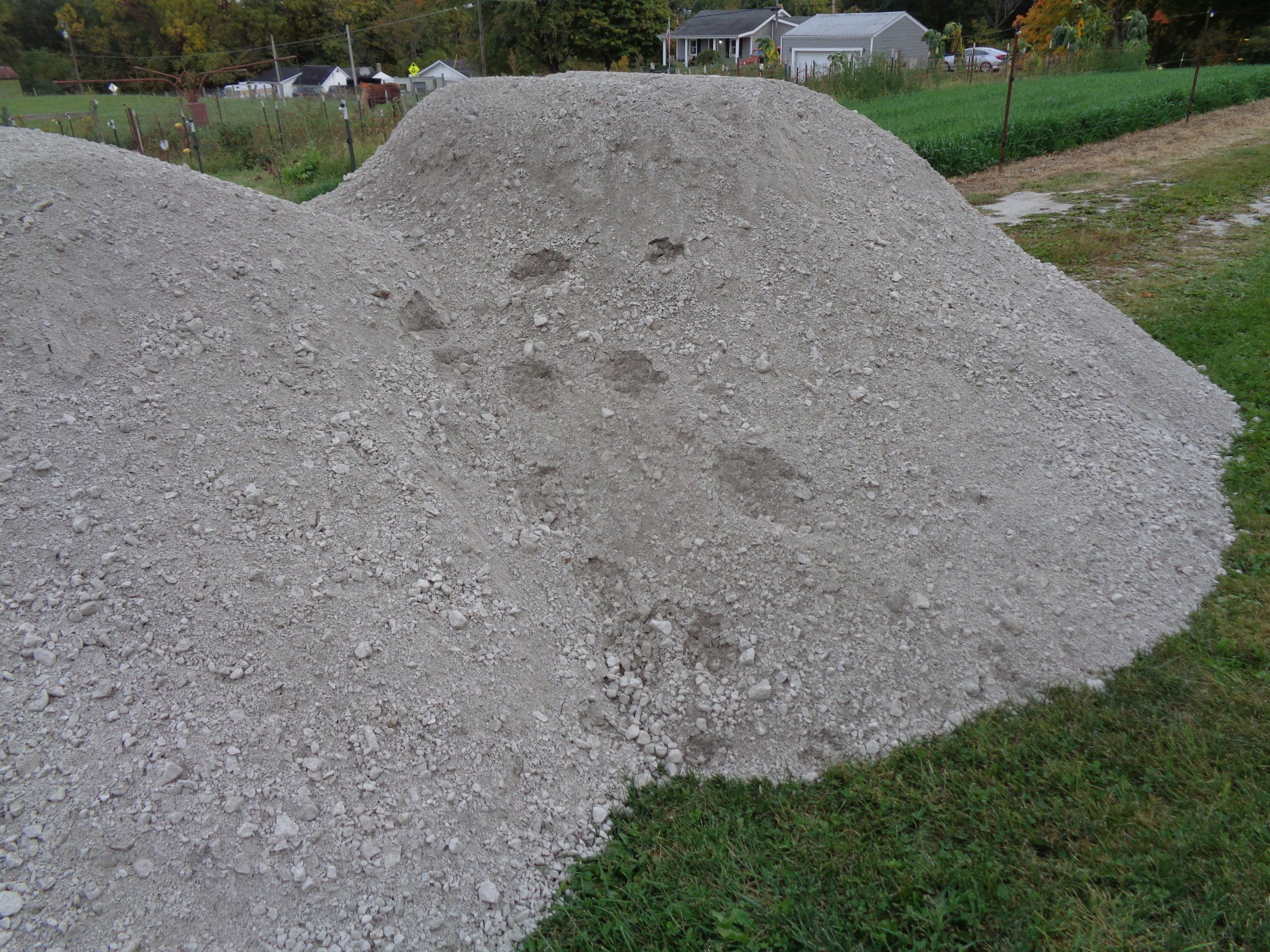

What I got here, was from Columbus Limestone. Delivered price was $19 a ton, but got the "good buddy" discount because a friend owns a 6 axle dump. Usual material trucking fee,ismaterial per ton, and $3 a loaded mile. It may be more now with the rise in fuel prices. And if you have Deer around, if whatever material you decide on sits in a pile for a couple of days, almost guarantee you'll see hoof prints in the pile.
