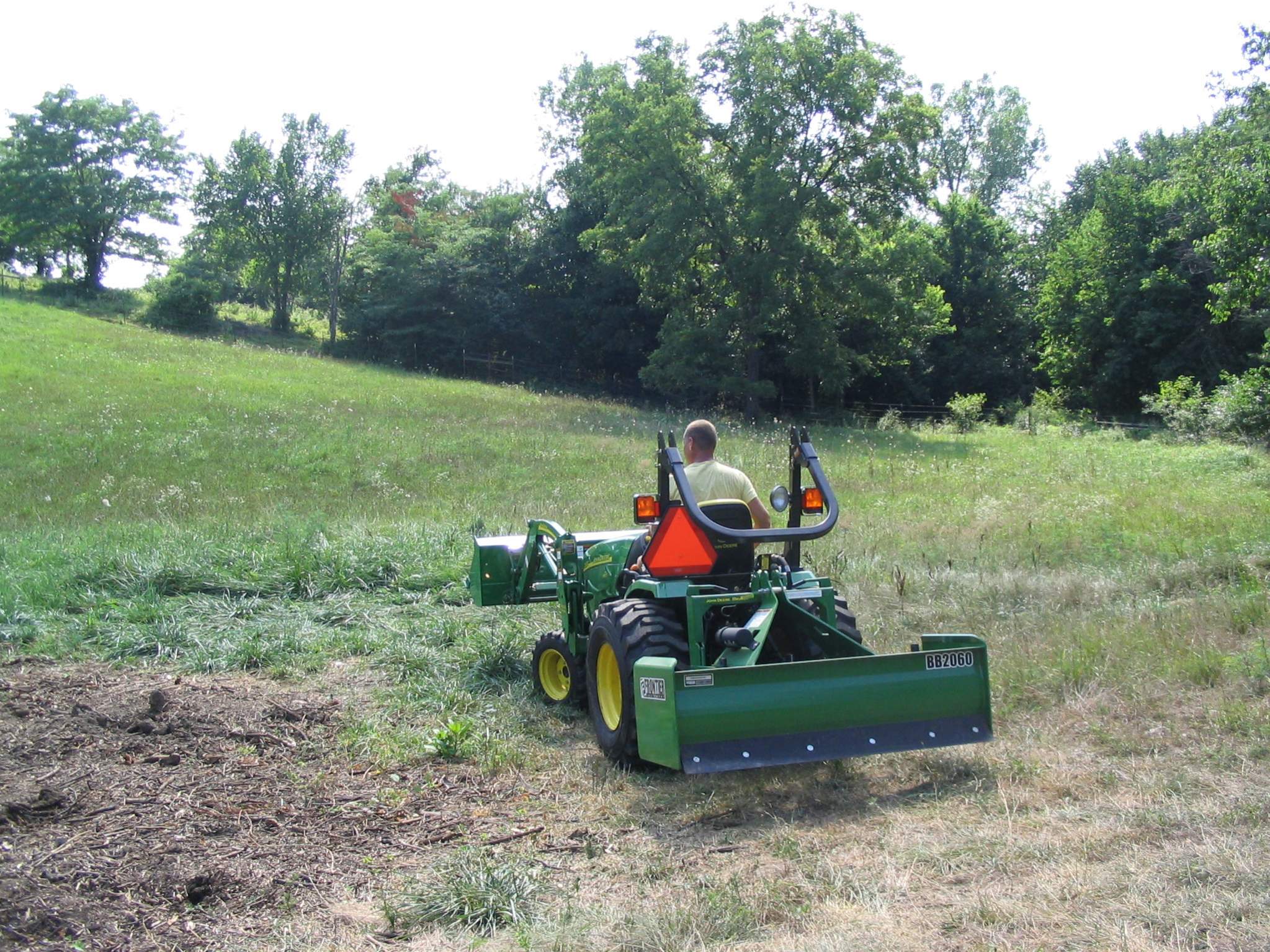

What's the best 3PH box blade width for my JD 2520? Also, are there any recommended brands or types? What do I watch out for (damage/wear) if I find a used one?
/ Best box blade width for 2520 #2
I have a 60 inch Frontier box blade for mine and it seems to be a good match. It's wider than the rear track, fairly heavy built and iMatch compatible.
