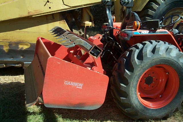

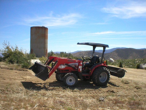

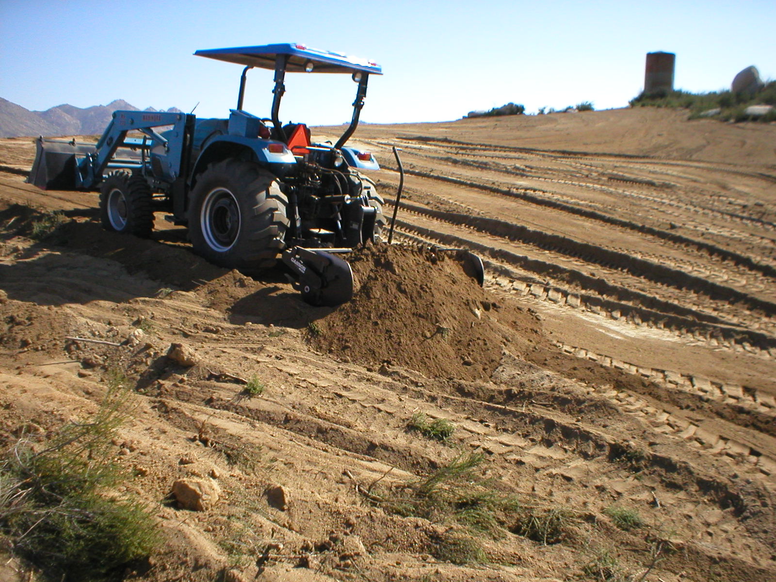

You, asked, I'm answering. Roll-over box blade. :thumbsup: There are for sure better - heavier industrial quality units out there, but a roll-over works very well, use to be what was used for industrial work before the new heavier hydraulic actuated ripper box blades came into existance. You can pull a lever and to change what process you will be doing with the implement. you don't have to constantly change the top link length. Very easy to use, very durable. An implement to consider IMO.
I have 3 of them, all Gannons (no longer made:(), an 81" for my 75hp tractor, 65" for my 32hp, & a 36" for the garden tractor. There are several dealers for them and have been told that there are 2 manufacturers for them, one a bit heavier than the other. Here is a link to for them.

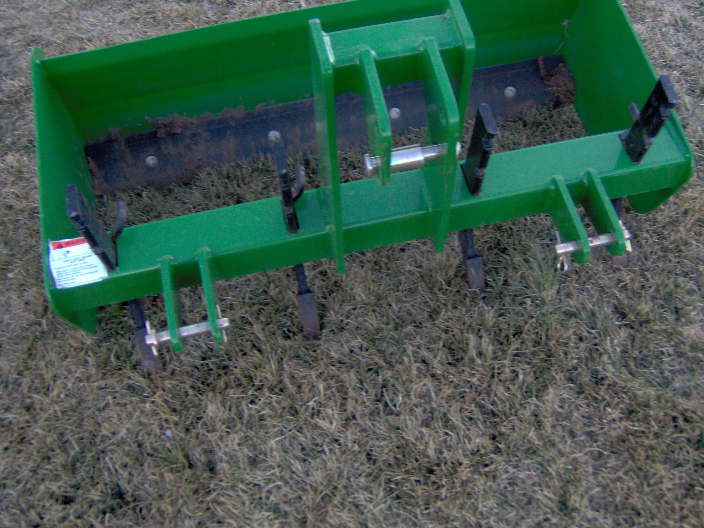

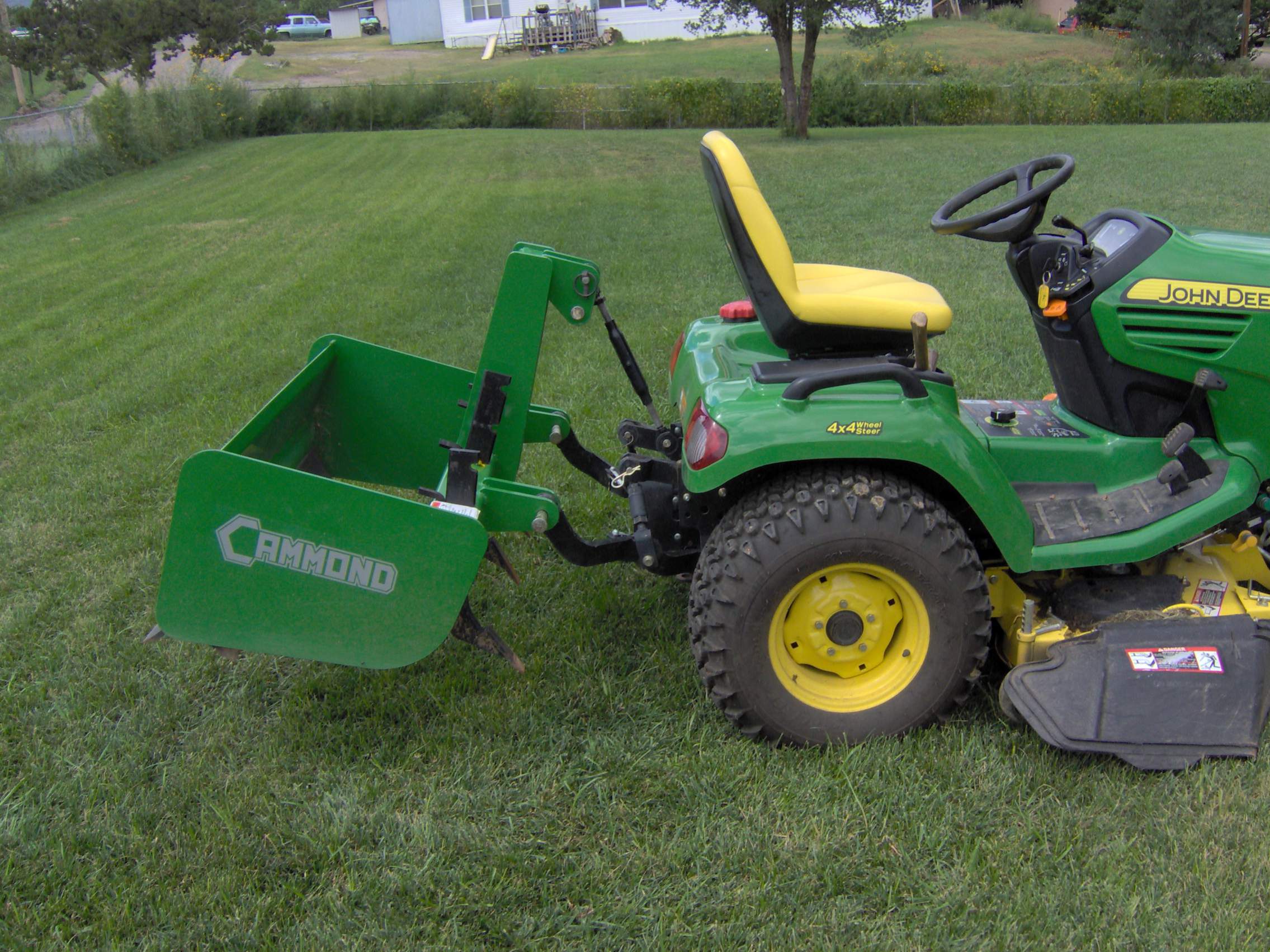

I use two boxblades a small 4ft for my garden tractor made by Cammond and a Frontier/Gannon 7ft for the larger jobs. The Frontier model is a BB1284 which is 1250lbs and is used the most. Here's some pics.
