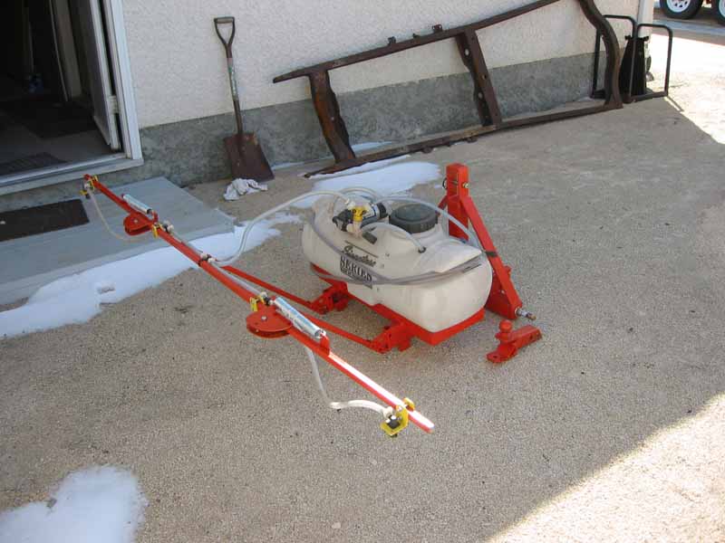

This is a re-vamped ATV sprayer. The booms are home made and give a 10' wide spray swath. The tank is 15 gal.
Spraying Par III it takes 1 litre per tank / per acre and takes about 1/2 hour to spray. Just a idea if you are looking at spraying 10 acres.
