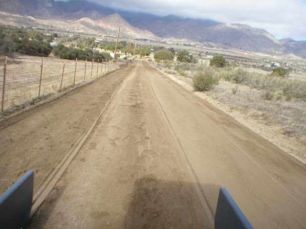

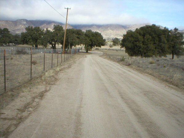

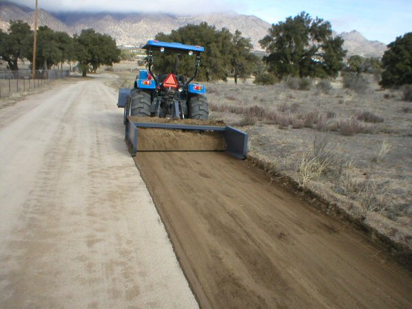

I maintain about mile and a half of driveway and private road. The first time I did it, it was with a 27HP tractor and a 5' box blade. It took me all day. The next time it was with a 50Hp tractor and a 7' landplane. It took me about two hours. I'll be out after the thaw to repair frost heave and potholes with it. Last year I only had to do it twice. The smoother I can make the road, the smoother it seems to stay.

Exactly, it is so quick and easy, that your drive never even gets bad. At first sign of needing repairs you go do it, because it only takes a small amount of time, not a half or full day to make everything good again.

There dosnt look like a stone bigger than a dime in your driveway. I would hope you can make that flat.
