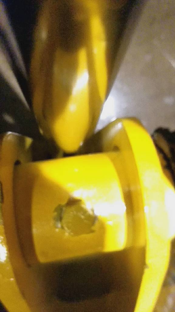

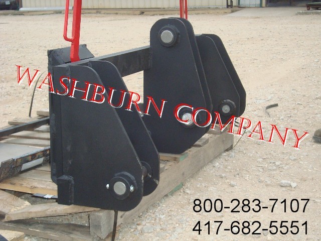

I'm not real happy with my Washburn adapter. Sure it's built strong enough, but the design is weak. First, the adapter curl cylinder mounts are welded straight up and down, whereas there is plenty of room on their plate to get it right. Second, the latch handles are straight and only 1/4" material. When attempting to attach to an implement the latch handles contact the implement pretty hard. Third, I used the take out bucket pins to make rollback stops on the Washburn adapter. If stops are not in place, the curl cylinder will get damaged. I'm going to live with the Washburn, as I still feel like I got a good value on it. However, I need to try and redesign the handles, and just live with the limited roll back that Washburn designed in for me.20180209_151749.jpg20180209_151835.jpg20180211_093506.jpg

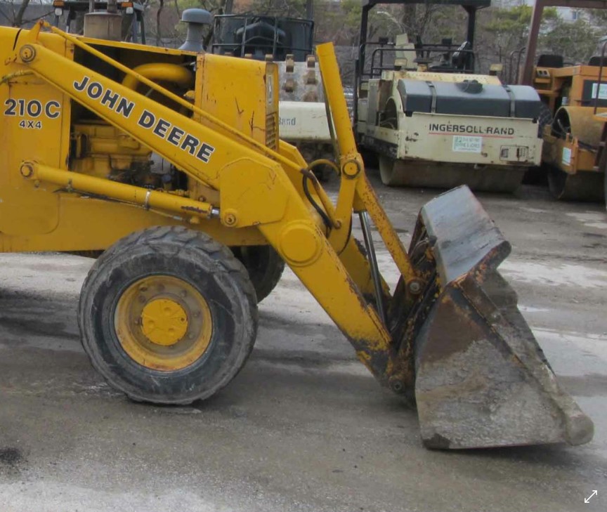

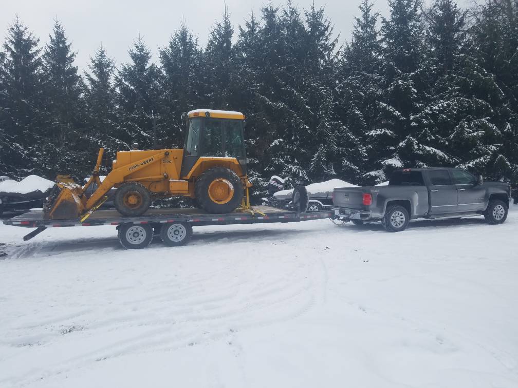

What machine is it on?
Looks like a wheel loader.
   / Best adapter to convert FEL to quick hitch? #14
Ha, I guess that is the most important part! It's a 25year year old John Deere 210C Loader tractor. 20180101_130713.jpg

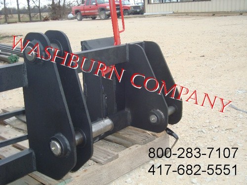

I'm not real happy with my Washburn adapter. Sure it's built strong enough, but the design is weak. First, the adapter curl cylinder mounts are welded straight up and down, whereas there is plenty of room on their plate to get it right. Second, the latch handles are straight and only 1/4" material. When attempting to attach to an implement the latch handles contact the implement pretty hard. Third, I used the take out bucket pins to make rollback stops on the Washburn adapter. If stops are not in place, the curl cylinder will get damaged. I'm going to live with the Washburn, as I still feel like I got a good value on it. However, I need to try and redesign the handles, and just live with the limited roll back that Washburn designed in for me. -------------------

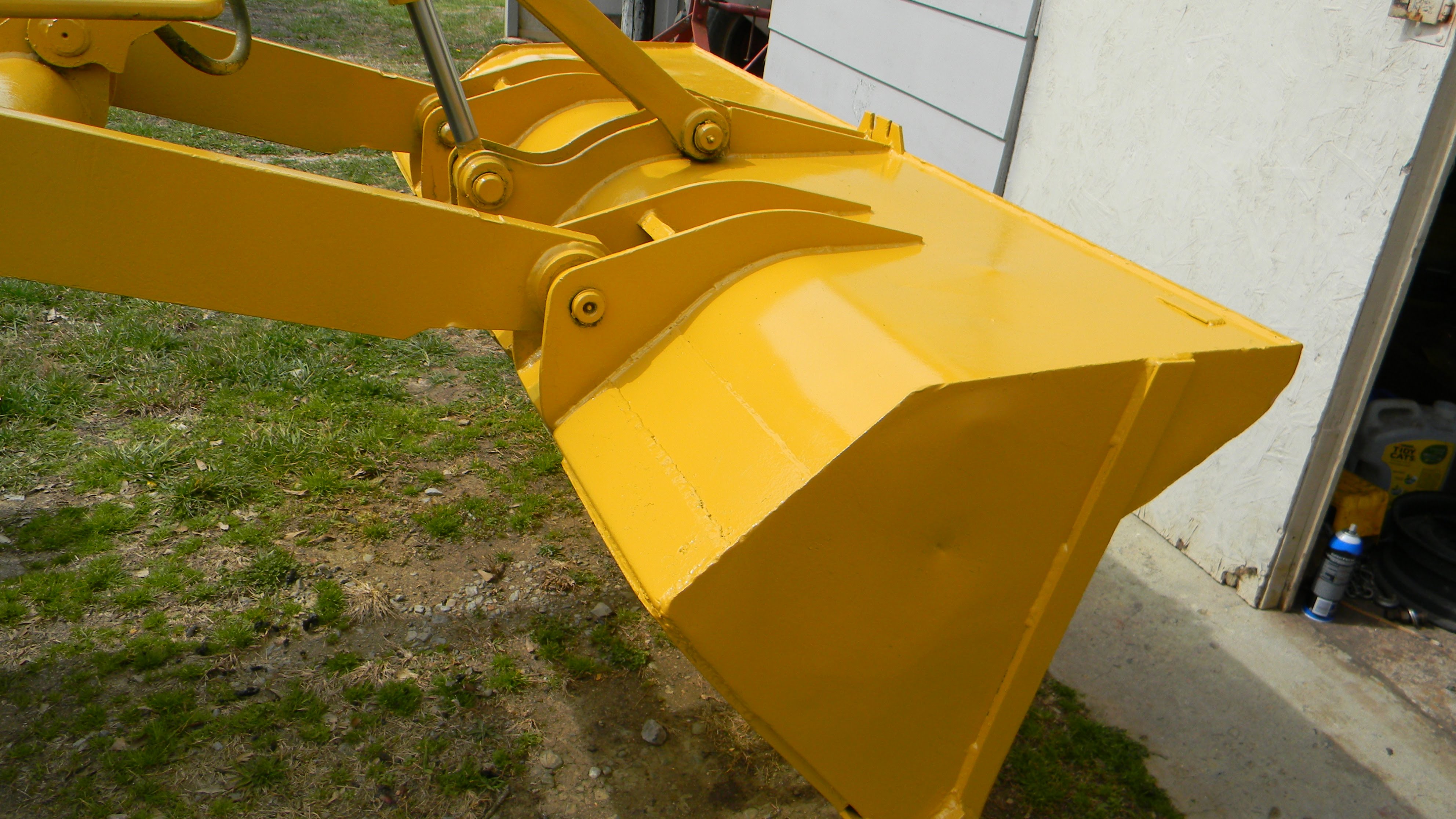

I wonder if yours was the first one they made?
The one on their Website looks to have a slight offset:
The original curl linkage:
Pictures from an image search.

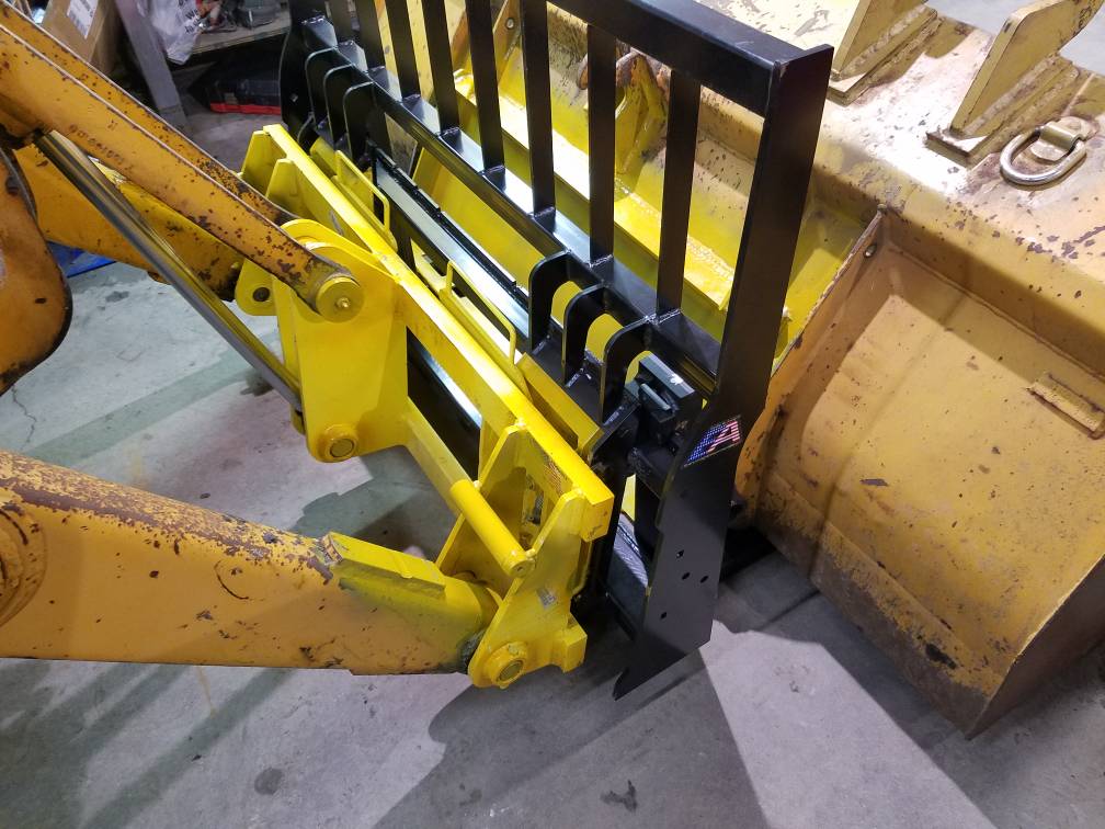

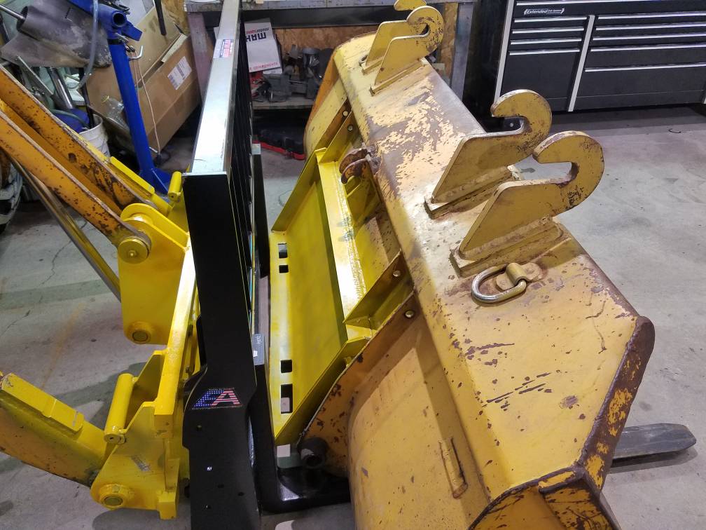

Yeah, I know. That's why I placed the order with Washburn. It appeared by their website that they knew what they were doing. It took six weeks do get my yellow one, so I was not about to wait another six on the pictured black one. My bucket is set up for this adapter now, so there is no going back, I just wonder how it is going to work on my grapple?20180224_150421.jpg

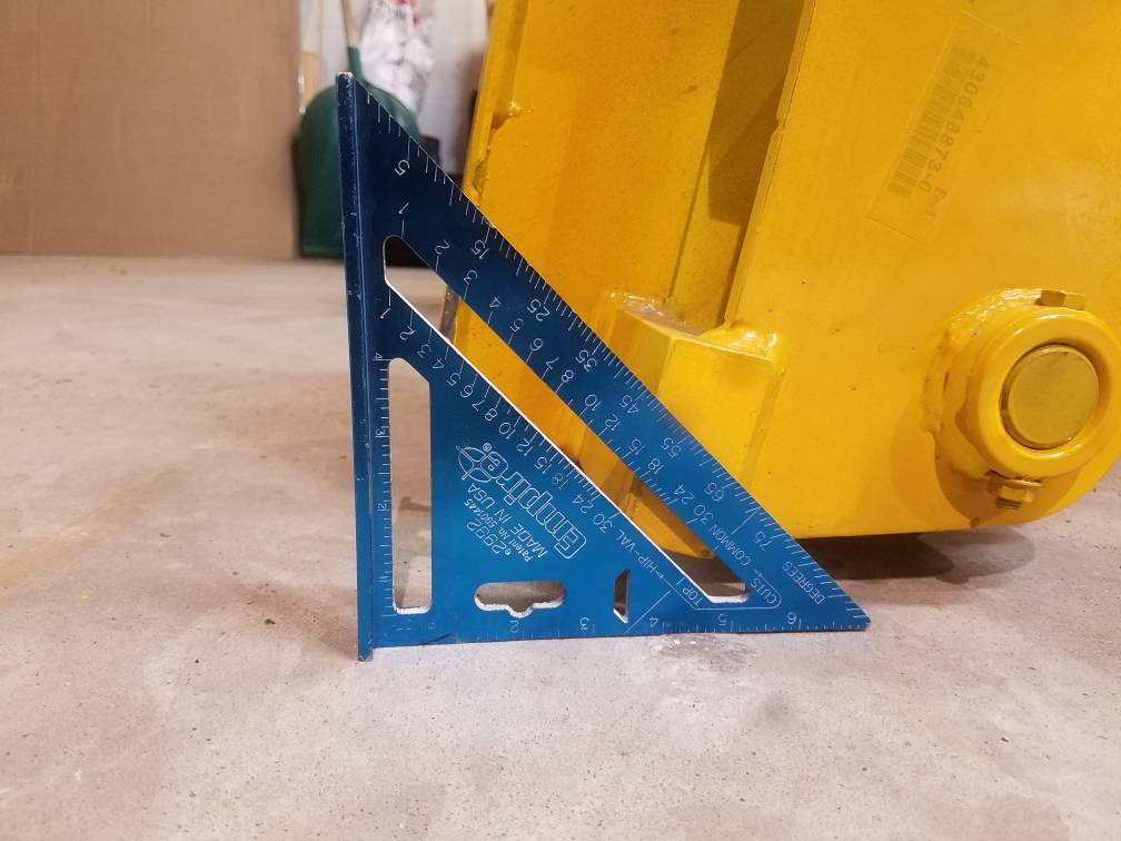

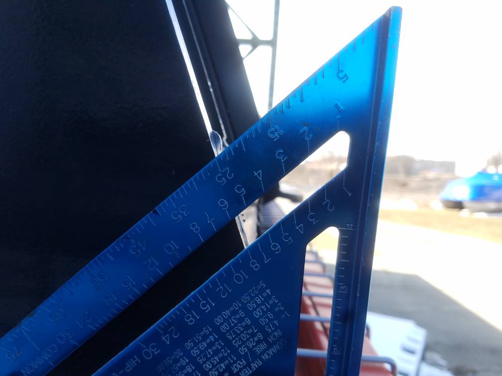

I did a little research, and it looks like I will get nearly 36° on the grapple. 11° on the tractor, and 25° on the grapple. It's not as great as the gold standard of the LA1055 42°, but it should be usable. On the bright side, I should have 6° more of dump!20180304_122854.jpg20180304_123359.jpg
   / Best adapter to convert FEL to quick hitch? #19
