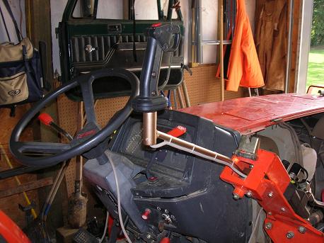

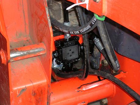

I bought all the parts for my third function valve myself, and have been really happy with the way it works. I seem to use it a lot more than I thought I would.

Valve and subplate was purchased at dalton Hydraulics. I also purchase a lot of my stuff From Bailey, which ever is cheapest at the time.

D03S-2C-12D-35 - Solenoid Directional Control Valve
D03 Subplate - NPT Ports
Here is bailey links
Solenoid Valves 220-313 Detailed Information
Solenoid Valves 220-319 Detailed Information
They also have the fittings and anyhose if needed. As for the joystick I happen to have had one in a box of stuff in the shop so I used it. Also I purchased some of the fittings and hose that I didn't have from my local Case IH dealer.
   / Best 3rd Stage Hydraulics Kit for Attachments #9
A few pics of my set-up. Also a side note, depending on your GPM of your pump you may have to step up to the larger DO5 valve, just have to look at the specs. As Kenny pointed out W.R. long is a source along with everything attachments, and one of these would be a one stop shopping if you don't want to try and figure up everything you need or run get it.
