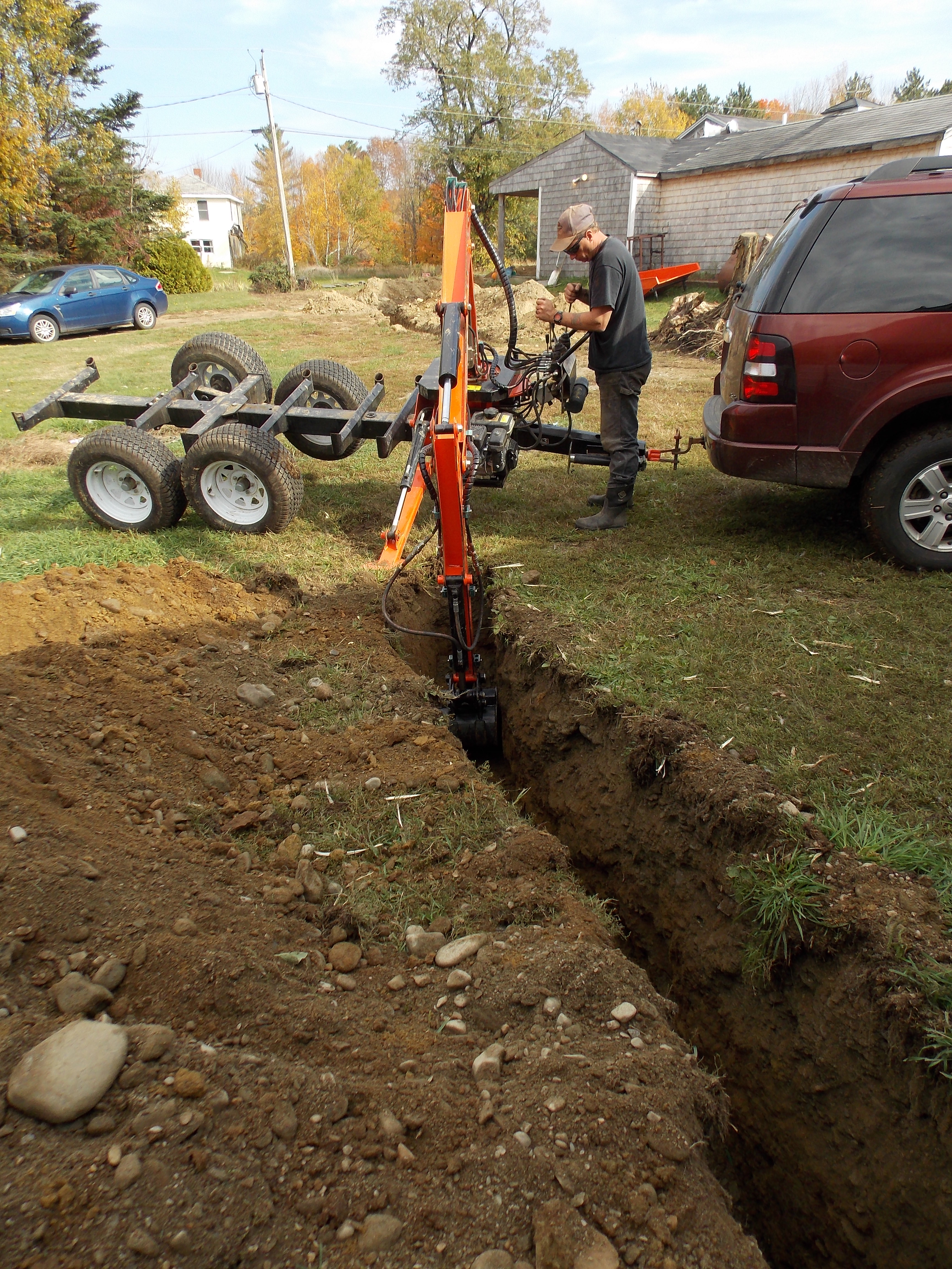

I do both...
It is nice having a small backhoe around for the smaller jobs, stuff where using a shovel really sucks, and so it saves me from doing that, or smaller jobs where you could not get someone in to dig for you, or renting a machine just does not make sense.
I used mine for repairing a broken septic line one time
Another time I used it to dig a waterline back to my barn
Another time I dug some ditches along a roadway
Digging a duck pond for our pet ducks
So stuff like that it is nice to have a small backhoe always at the ready.
But for bigger stuff, just rent and excavator.
But my backhoe is on a trailer, and not a 3 point hitch backhoe either. I would never dig a cellar hole with it, but it is nice not to have to use a shovel either.
