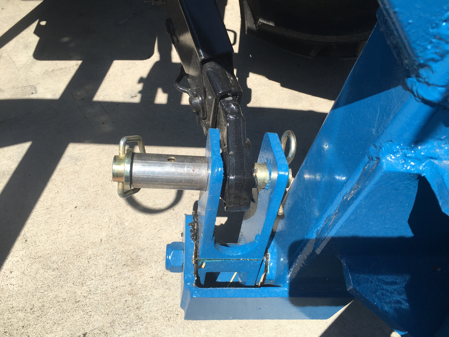

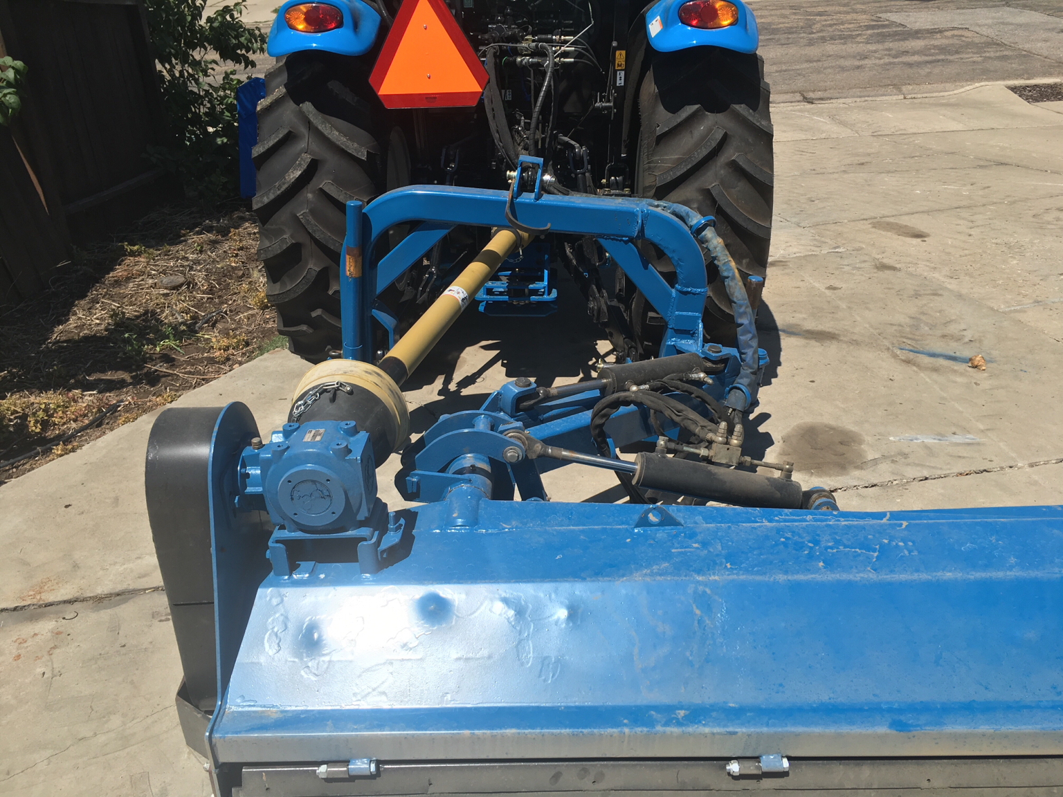

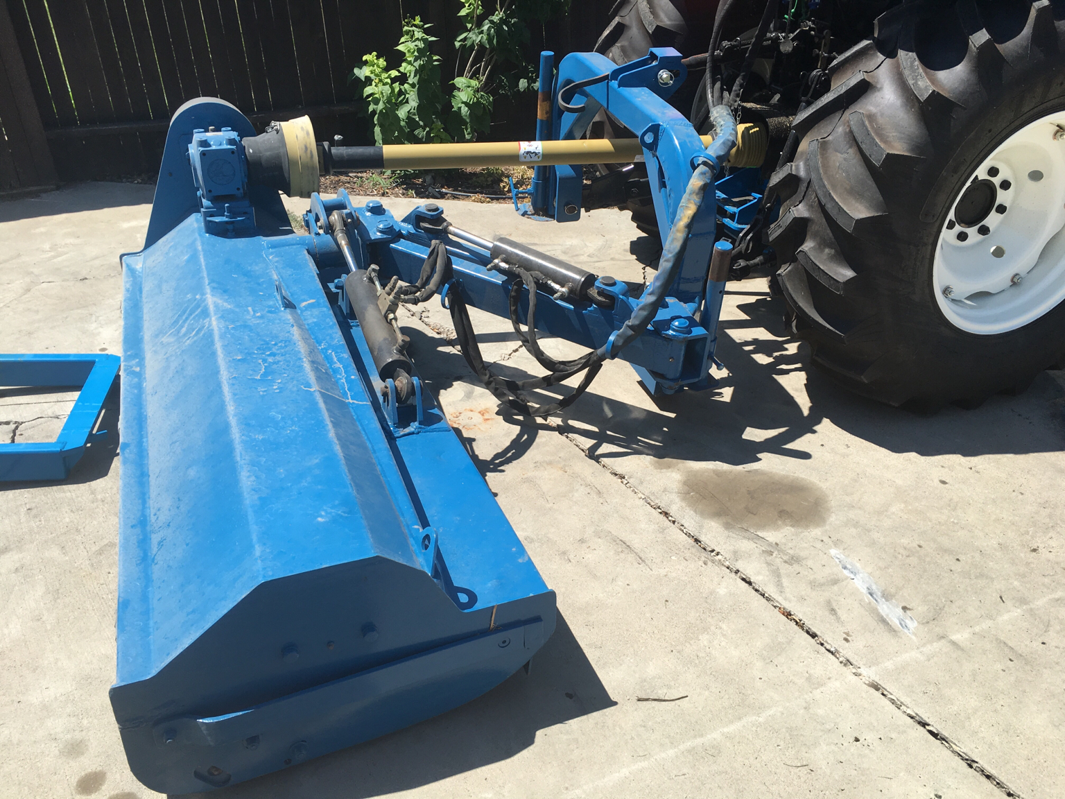

After a few days work, I got the mower back together with new U-joints, hoses, PTO cover, and a coat of paint. I went and tested it out today and all seems well.
I am concerned that I need to raise the right 3-point arm to level the mower out. I've read the Berti owners manual, and they don't really talk about how to adjust it. The new models don't have the swing shackle on the right side like this one does. I think that it to allow some give if it hits an obstacle. Am I way off?
I have to find a shorter pin. All I could find were long ones, so I put a sleeve on it so it wouldn't work through the other side and keep it from swinging, but I have to be very careful or when the mower is offset the PTO cover will touch.
   / Berti TA200 ditch flail #12
Nope not at all.
Anytime the mower is on the ground it could contact something that is sticking up out of the ground and between the wheels as you mow on the ground.

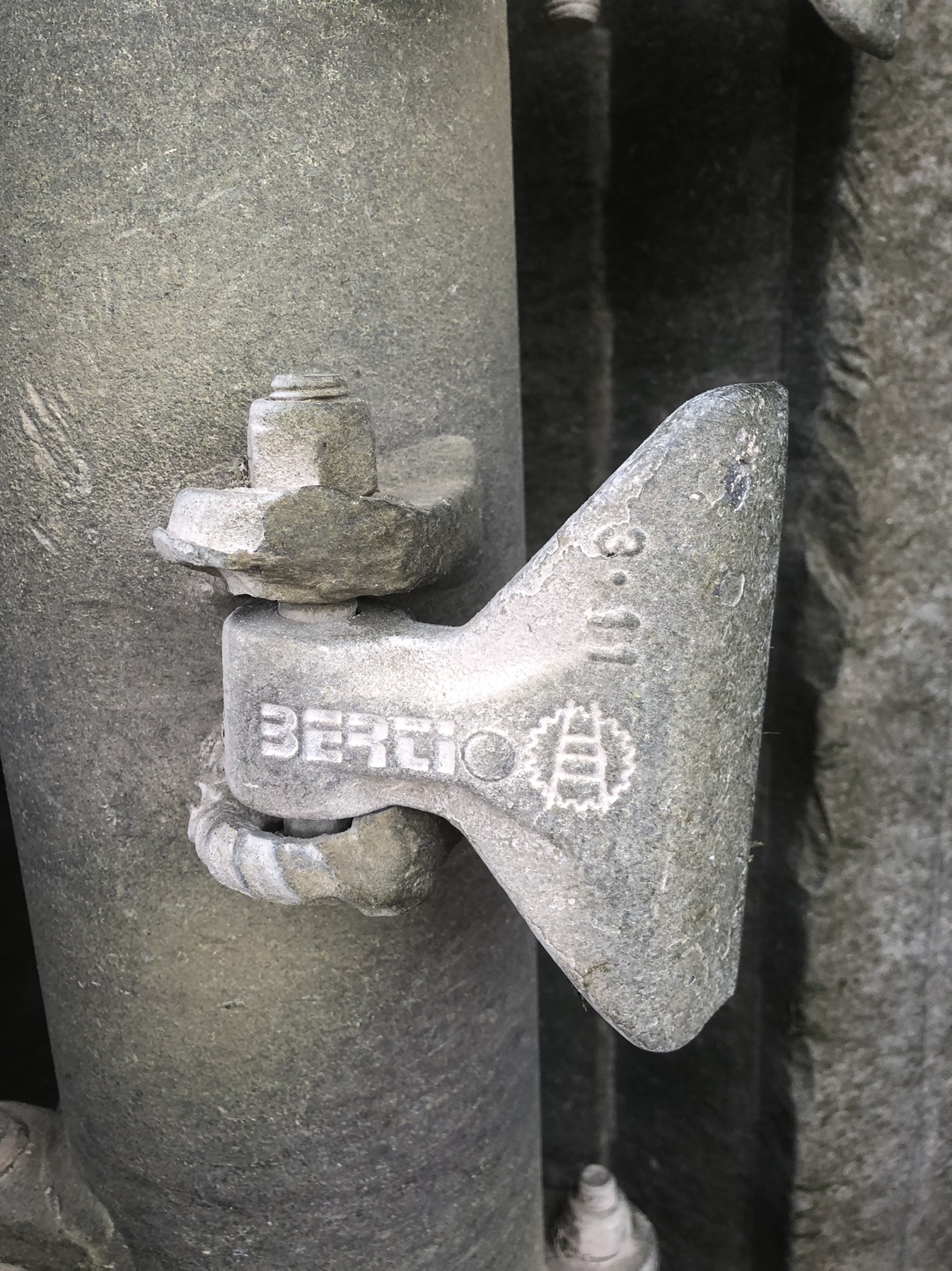

I found out that after a few hours of mowing today, when I shut off the PTO, I got a bit of vibration that was never there before, so,I tipped it up and found one hammer and the bolt that attaches it was missing. Strange since I had inspected all the hammers today when I got it out of the barn and lubed it up. Anyway, I guess I need to order a couple more hammers.
