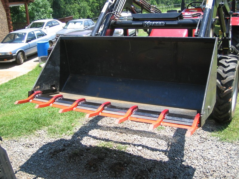

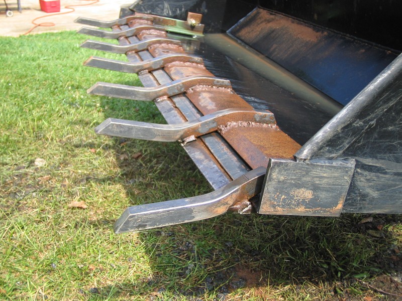

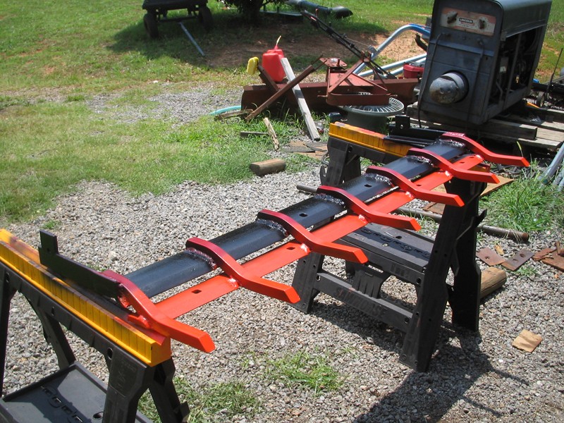

Brad, You will like the teeth extensions when you make them. I moved a pile of brush with my tractor last spring. It was about 12 feet long, 8 feet tall and at least 6 feet wide. I intertwined the brush so that it would all stay together when I lifted it. we burned it down the street from where I had piled it up. My wife couldn't believe the size of the pile as I headed into our backyard with it. They also come in handy for moving pallets with heavy items on it. I can bounce on the end of one of the 4 foot extensions without bending it. I weight 180 pounds. That tells me that I should be able to lift close to my bucket capacity without any worries about breaking or bending the teeth. I went with thick wall square tubing. I did have to custom fit them to each tooth by grinding down the corners on the teeth.
