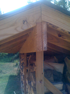

I'm thinking more (after seeing the pics posted by the OP in the opening post) that backing under a large tree limb might have caused the bend.
well, technically a tree is a large pile of wood... :p you might be onto something.

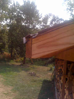

Well... if the operator backed into something that "wedged" the ROPS, down pressure could have been applied to the rear end causing traction to increase. From there it is a matter of tractor gearing and HP to slowly bend the thing.
From an impact standpoint, I think it would take a lot... but if you wedge it in there in low gear, it could probably bend.
If not that, I think the "on the trailer" theories work.
I think if something happend like a rollover or if backhoe operation cause something to happen, the operator would be beat up... and other signs would be visible.
My biggest concern here is... no matter the cause, I am betting there was a LOT of force exerted down between the front and rear axles... trying to break the tractor in half.

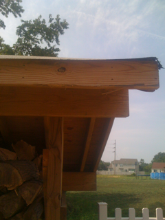

WOW.. after looking at those pics that's all I can say. I don't think there is anyway he bent those ROPS while on the machine. (even if he hit something at full speed in reverse) I agree that that must have happened I would say a roll backwards but the BH would have threw it to the side and that looks like it was hit in the middle.

okay took pics at house this is what he said he hit only skimming it gping forward. On the back of rops towards hoe you can clearly see on the left side were he contacted the shingles tar is still on bar.. My sister also said hes not good with driving and took out tosections of his fence.. he hit his wood sheed it at least 60 feet long. also which you cant see is a steep hill and retaining wall wich he was grading my sister told me he had used the bx to fill in his brick pavers with small stones so I bet he had a full bucket and was backing down the hill and hit the shed.. I talked to him yesterday and sweers he did not do it so is coming to look at the bx after work .. one more thing he has cameras recording around his house and yard 24 hours a day so I want to see the computer hard drive which it was recorded on.. From the pho e conversation last night he does not want to pay for it... I dont want to end up in small claims court but I am not getting stuck with the bill!!!!
