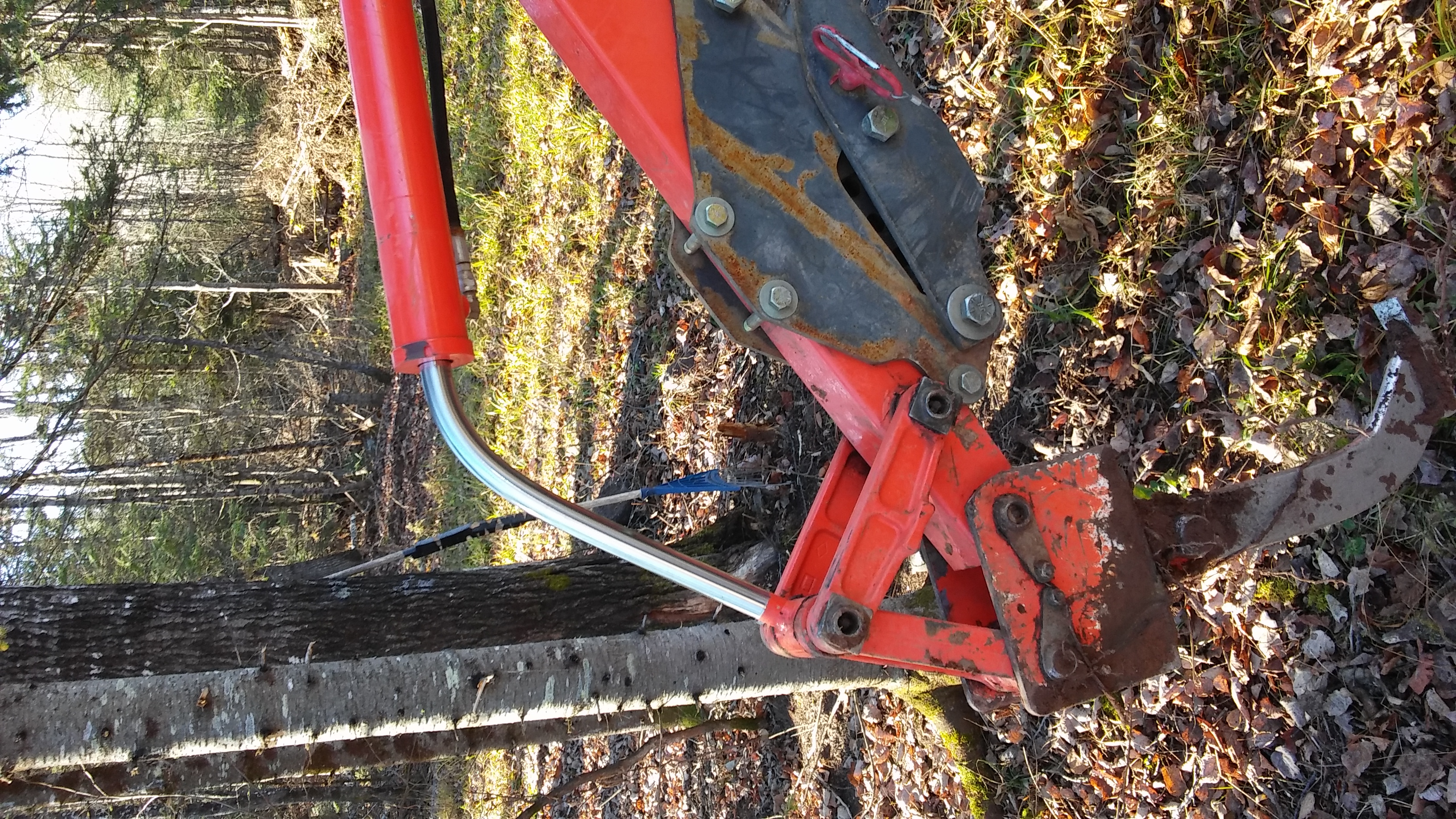

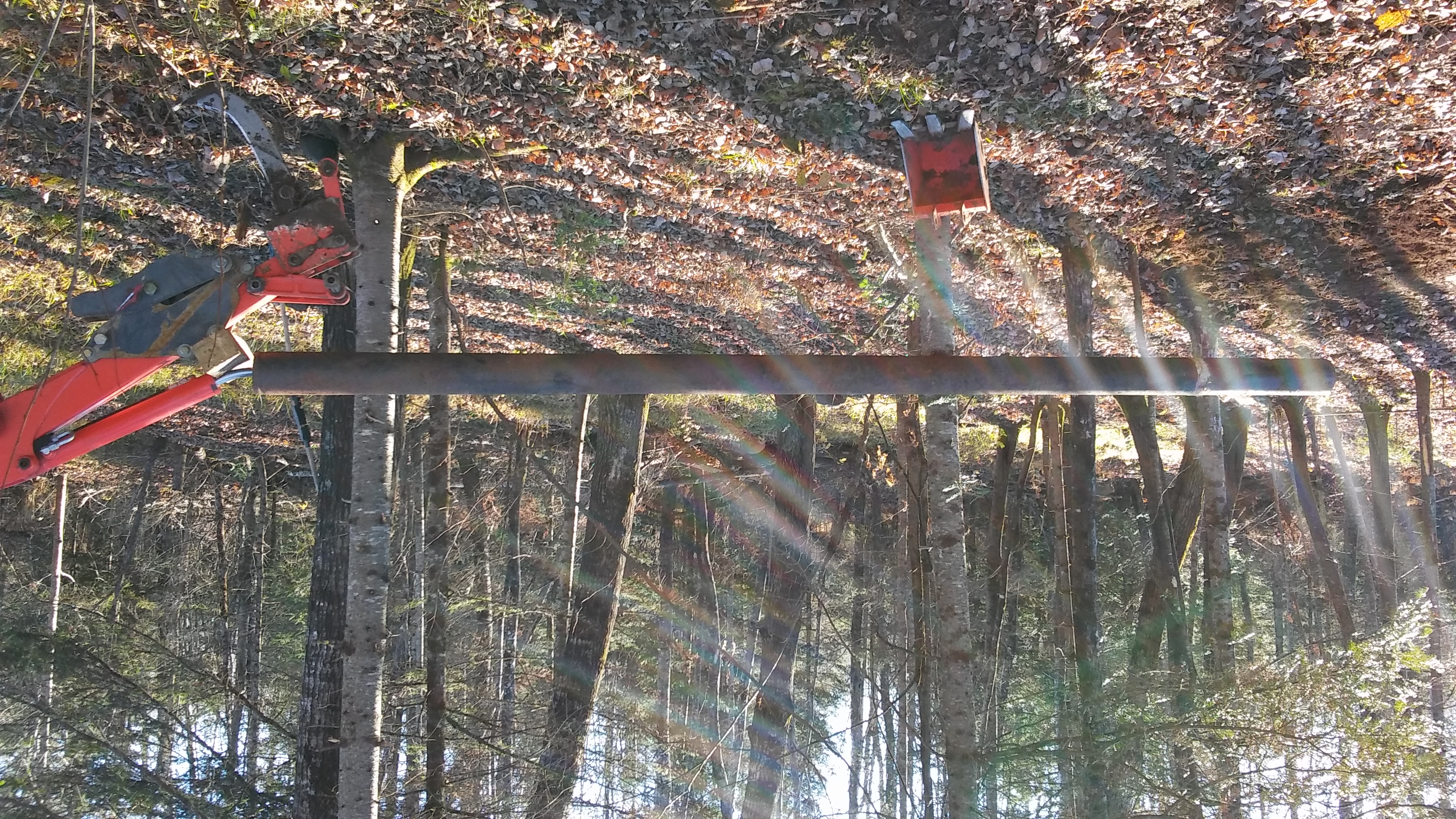

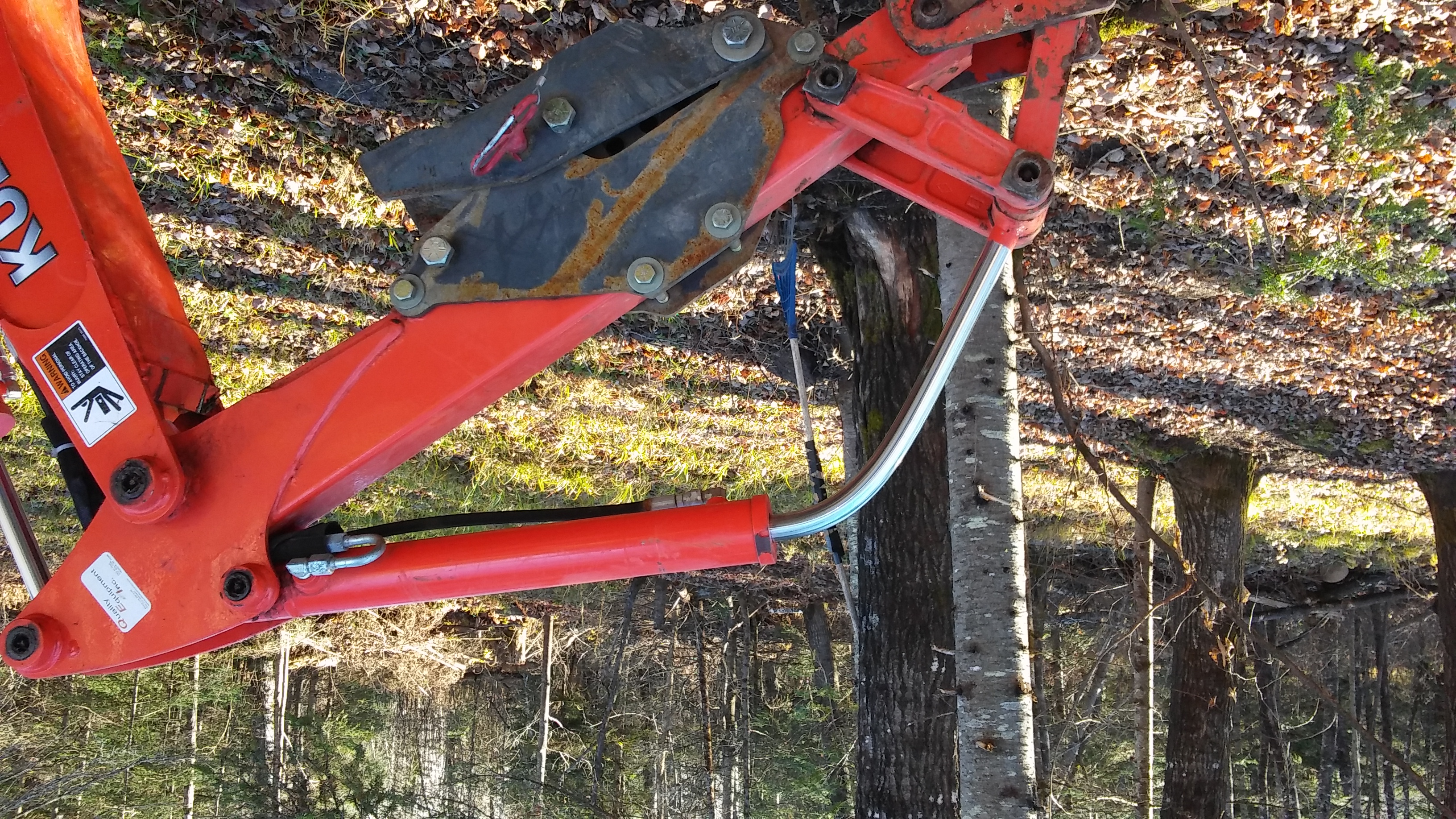

Nov 7, 2016 / Bent my BX! #1 B bxbuggy Member Joined Mar 13, 2013 Messages 41 Location western U.P. MI. Tractor bx25 So this happened this weekend! Just as I was pulling last stump out. Attachments 1105161029a.jpg 3.1 MB · Views: 706
Nov 7, 2016 / Bent my BX! #2 Thomas Epic Contributor Joined Apr 6, 2000 Messages 31,176 Location Lebanon,NH. Tractor Kubota B2650HSD w/Frontloader & CC LTX1046 & Craftman T2200 lawn mower. OUCH...doubt very much machine could fix.
Nov 7, 2016 / Bent my BX! Thread Starter #3 OP B bxbuggy Member Joined Mar 13, 2013 Messages 41 Location western U.P. MI. Tractor bx25 I bent it back and made operable again, tends to bind when it gets warm though. Will order replacement today.

Nov 7, 2016 / Bent my BX! #5 ovrszd Epic Contributor Joined May 27, 2006 Messages 32,246 Location Missouri Tractor Kubota M9540, Ford 3910FWD, Ford 555A, JD2210 Did the hoe have the hydraulic power to do that or were you using the tractor when pulling on the stump?? Really surprised the hoe would have that much power built into it.

Nov 7, 2016 / Bent my BX! #6 bcp Super Star Member Joined Jul 8, 2009 Messages 12,633 Location SW WA Tractor Kubota BX2360 A hydraulic shop could probably make a new rod for much less than a new cylinder from Kubota. Bruce
Nov 7, 2016 / Bent my BX! Thread Starter #7 OP B bxbuggy Member Joined Mar 13, 2013 Messages 41 Location western U.P. MI. Tractor bx25 the hoe bent it. I was curling the ripper tooth against the stump and lifting out of the hole.
Nov 7, 2016 / Bent my BX! Thread Starter #8 OP B bxbuggy Member Joined Mar 13, 2013 Messages 41 Location western U.P. MI. Tractor bx25 bcp, I am going to check on that. i think it is $185. from Kubota.
Nov 7, 2016 / Bent my BX! #9 ovrszd Epic Contributor Joined May 27, 2006 Messages 32,246 Location Missouri Tractor Kubota M9540, Ford 3910FWD, Ford 555A, JD2210 bxbuggy said: the hoe bent it. I was curling the ripper tooth against the stump and lifting out of the hole. Click to expand... Impressive!!!!
Nov 7, 2016 / Bent my BX! #10 bcp Super Star Member Joined Jul 8, 2009 Messages 12,633 Location SW WA Tractor Kubota BX2360 bxbuggy said: bcp, I am going to check on that. i think it is $185. from Kubota. Click to expand... That's surprising. I would have expected $400-$700 from Kubota. Bruce
